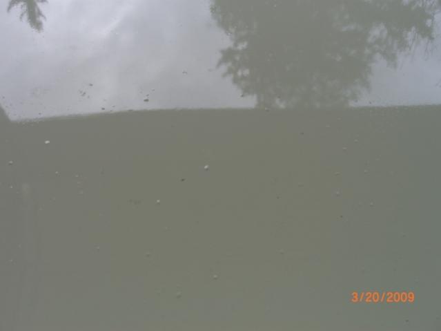

  25. Kid Jeff
    Joined: Aug 8, 2006
    Posts: 151
    Kid Jeff
    I was finally able to get the bubbles to show up a little. Here are two pictures. These are both shots of my hood. Hopefully they are visable. Thanks for all the help so far guys, it is very much appreciated. Thanks.
