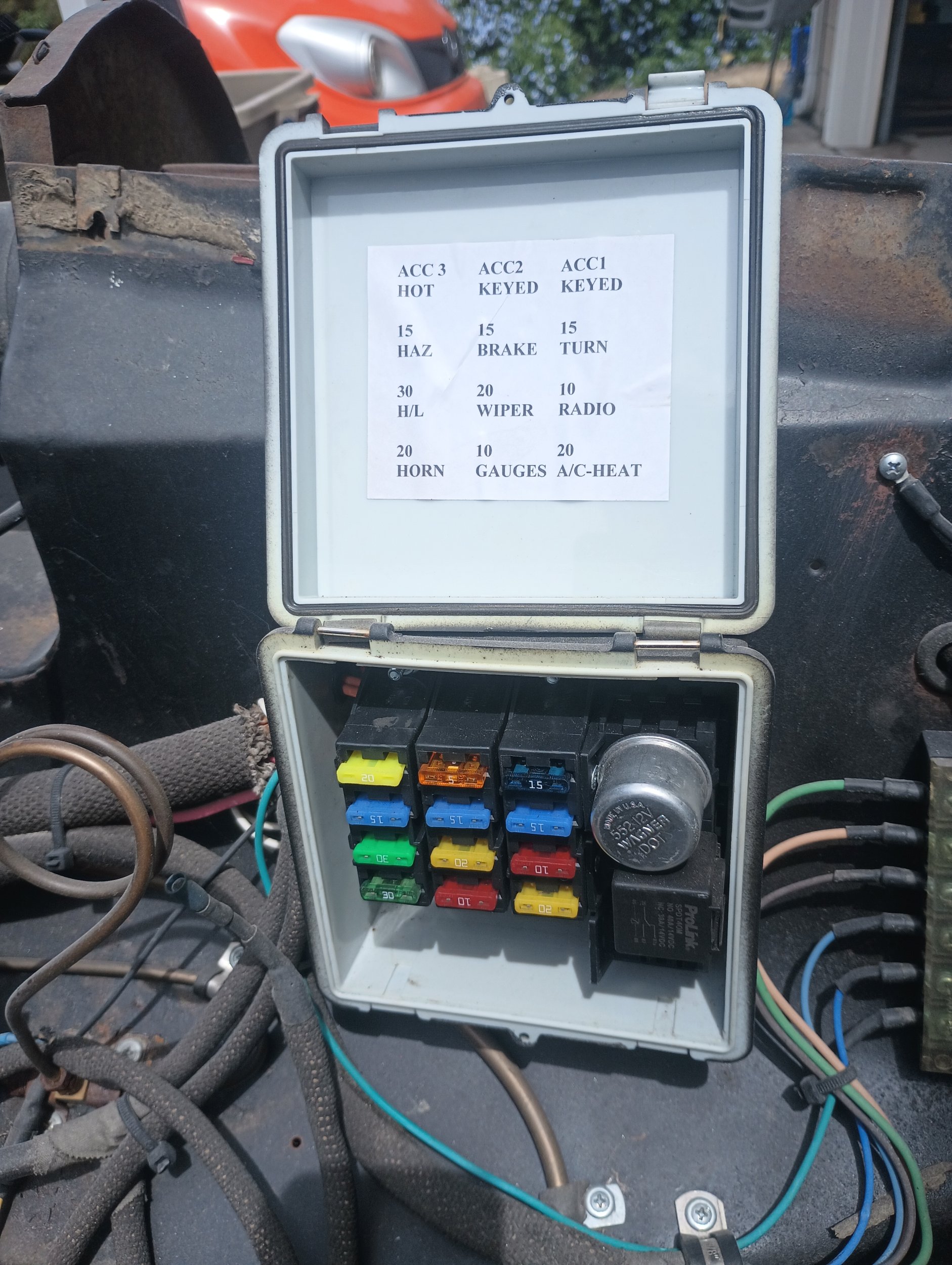

    What I did on my Ranch Wagon using a Rebel wiring kit.

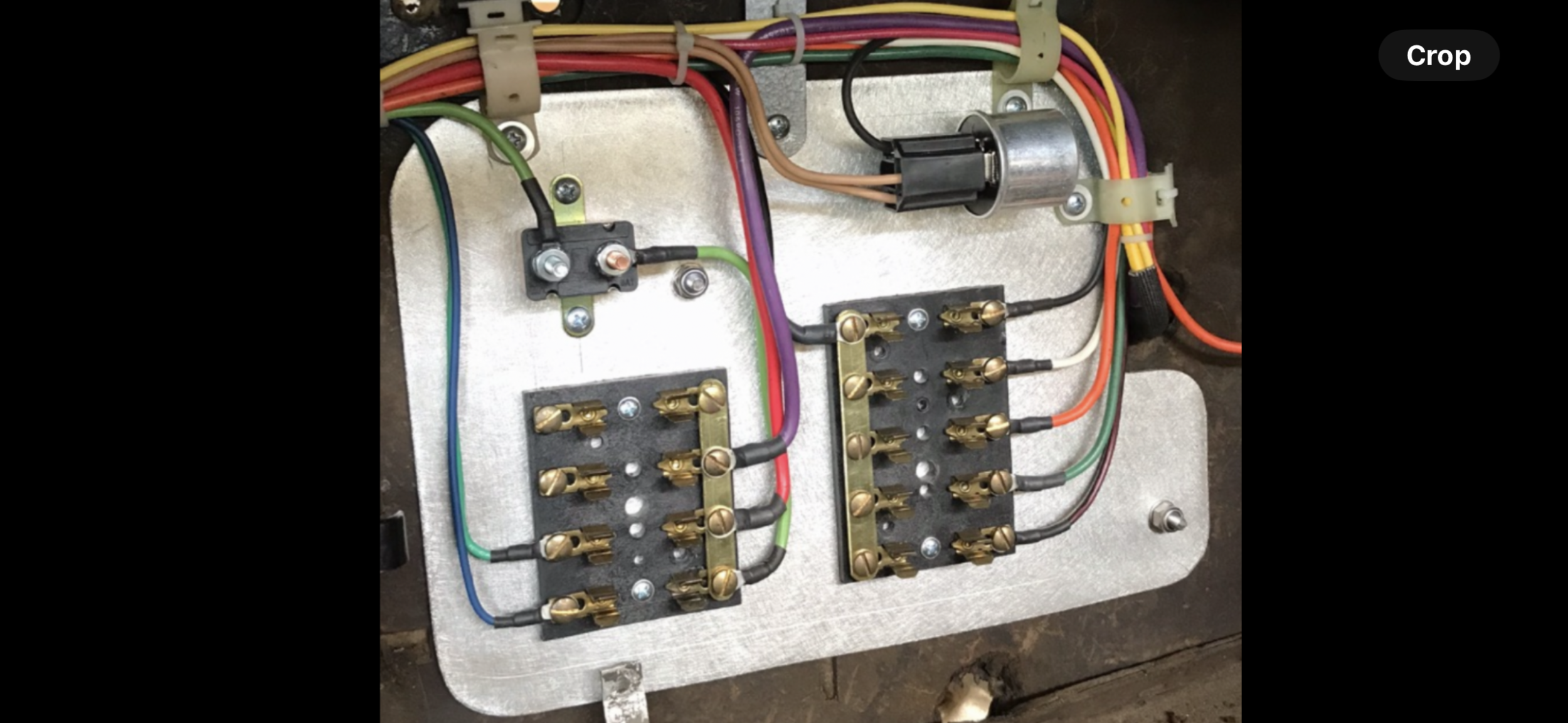

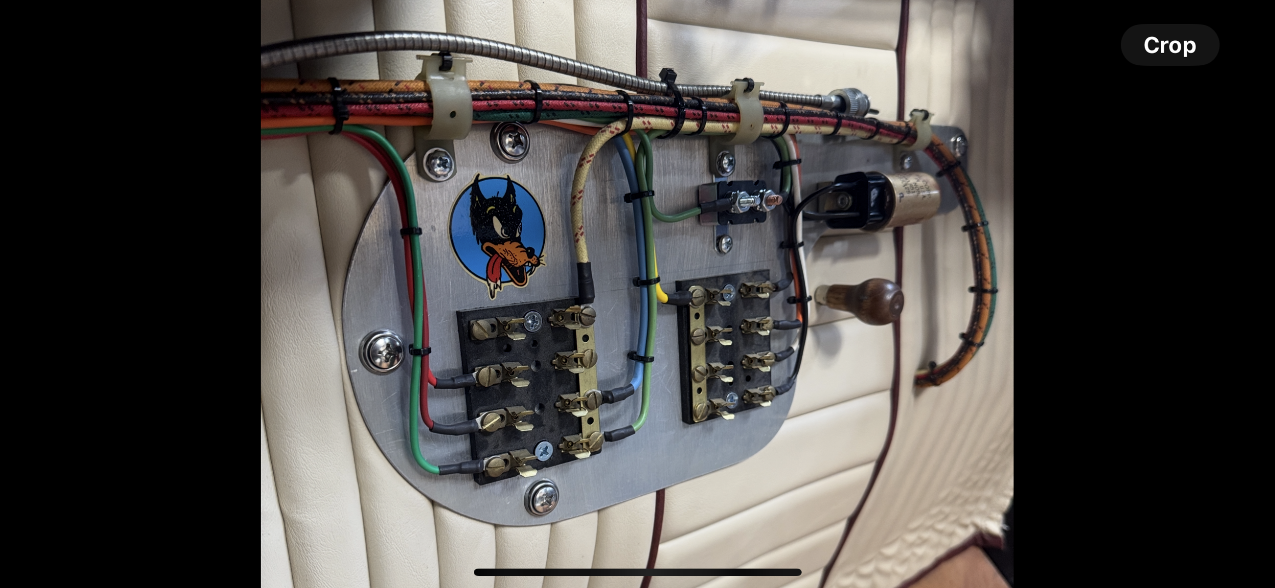

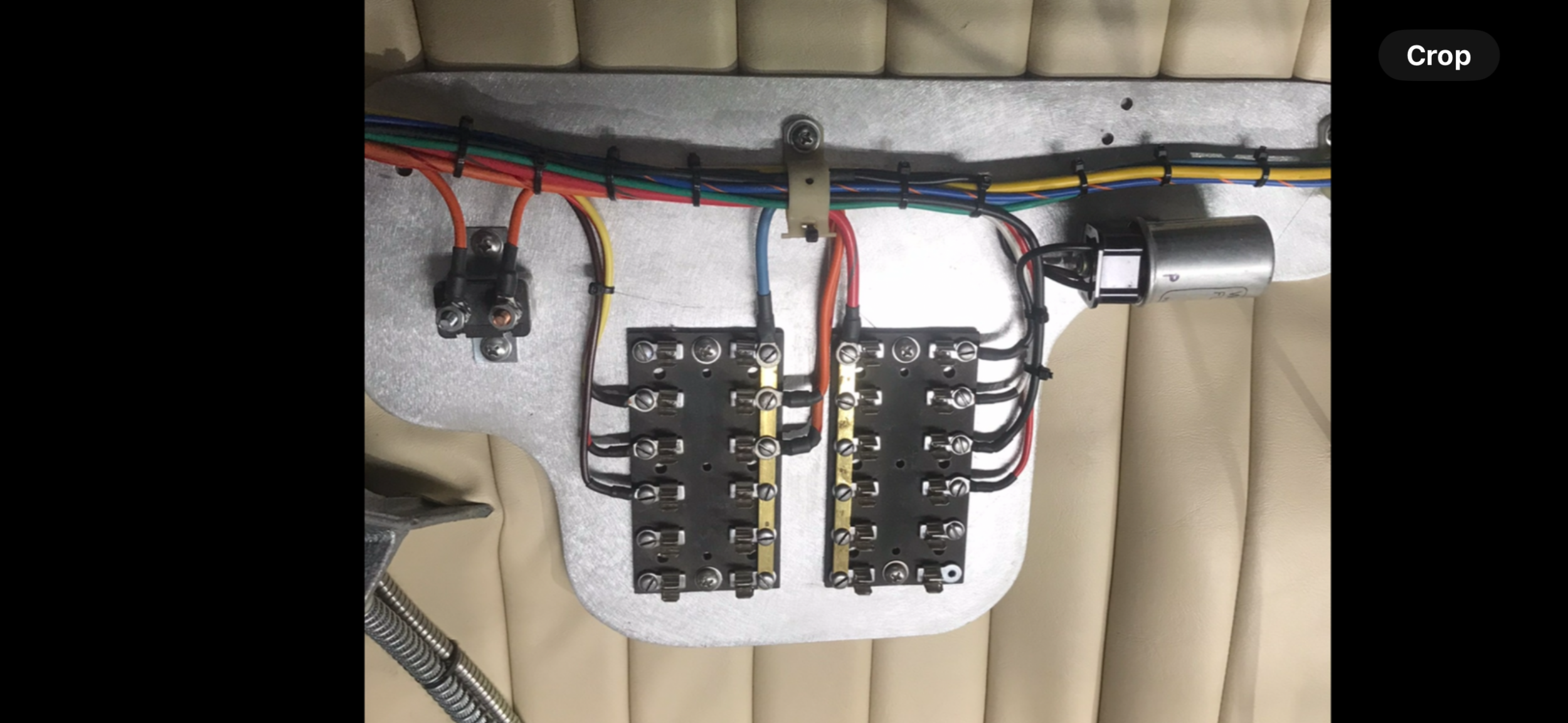

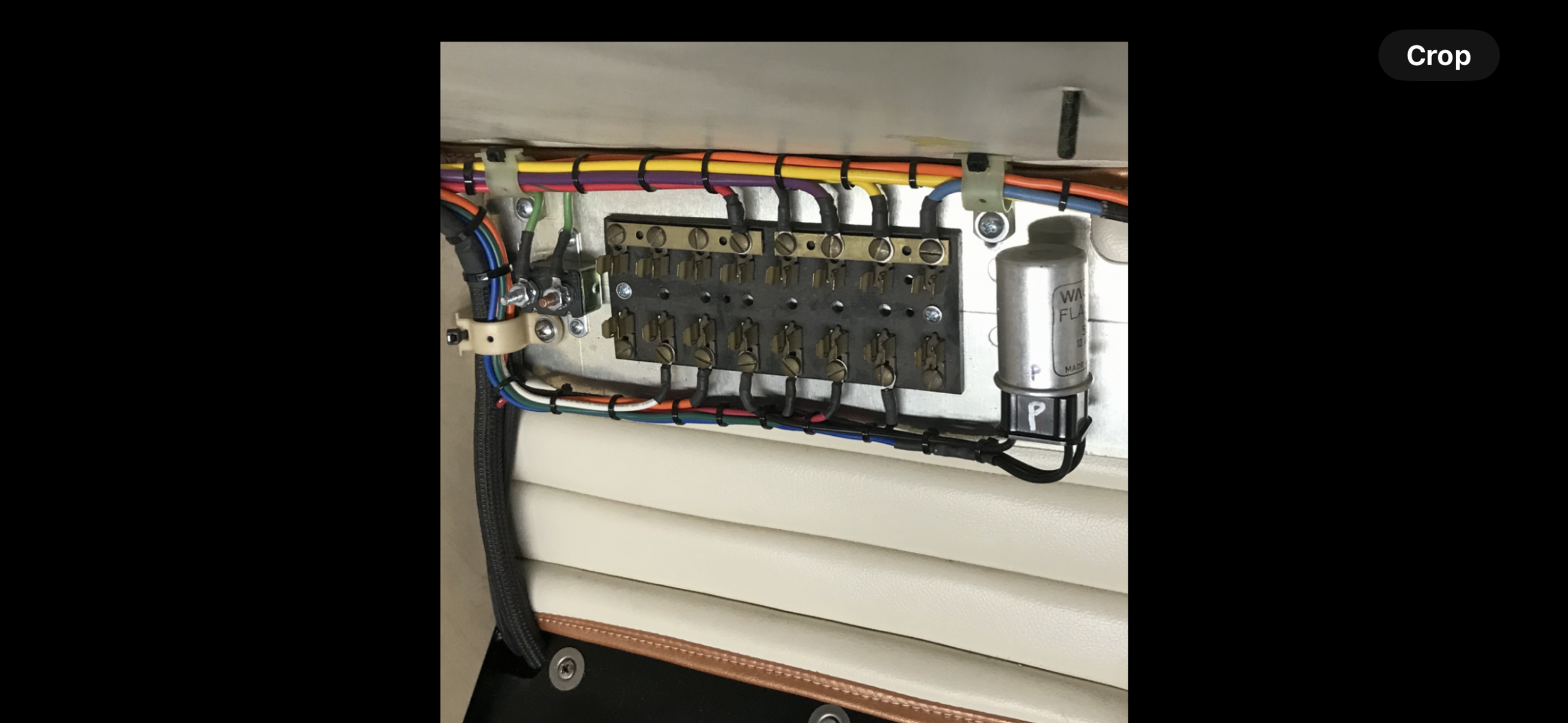

  17. F-head
    Joined: Oct 20, 2007
    Posts: 1,448
    F-head

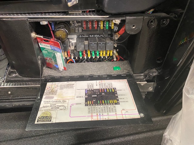

  30. Bandit Billy
    Joined: Sep 16, 2014
    Posts: 15,290
    Bandit Billy
    Kits are nice for a lot of reasons, but I do like the labeled wires. I run their plastic coated wires where they can not be seen but I always wire the engine bay and signals, etc, in the same colored fabric covered wire. It makes tracing wires much easier down the road while looking vintage.
    The Coach Controls panel I showed above (under the seat of my truck) has every relay and fuse the truck requires in one neat little unit. It is tidy, it works, it was a breeze to install but it is the most expensive panel on the market. Like they say, buy once, cry once. If I was building a bare bones hot rod, I would build my own, glass fuse panel.
