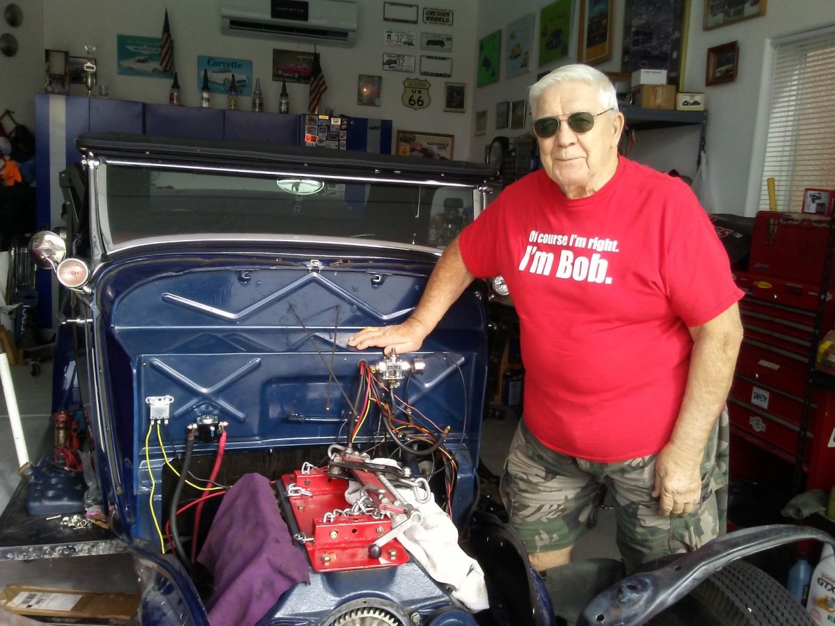

    bob and engine.jpg Well; not quite. Have a slight hic-up with 47 truck motor so it it coming out & the original 21 stud is going to work in its' spot. Lotza bucks in this P O S & the machinist is dead. I was adjusting the valve lash & turning it over by hand when it just locked up. I reefed on it a bit & broke it free. That didn't last & it locked up again. This time I didn't have to use so much pressure on it & it came free. I wouldn't feel safe driving that so decided to just go ahead & pull it & tear it down to find out why it is not playing nice.
    I have two cylinders with sleeves & everything is .040 with a ground cam. Some where near an L-100 with the cam being nitrated, Isky purple springs & new bearings. Rods aligned, blocked decked & heads planed. Squish is .50 & melling oil pump. Engine has around 5-600 miles.

    You were adjusting the valves and then it locked up?
    If that's the case, it sounds to me like you might have a valve mis-adjusted and it's hitting the head.
    A nut dropped into an intake port and making it's way into a cylinder is also a possibility.

    Just a thought, I have a L-100 cam in my flathead. Have you looked at your plugs? I adjusted my valves and then put the edelbrock heads on with copper gaskets. When I was turning it over with a ratchet I could feel something hitting. I took a head off and all the grounds where bent on the plugs from the exhaust valves from the 375 lift cam. I had to use index washers to raise the plugs. Maybe he set the lash loose and now readjusting its to close?
