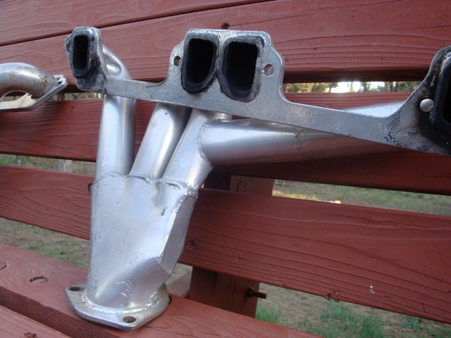

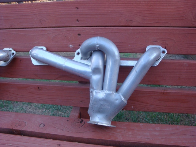

  23. Sharpone
    Joined: Jul 25, 2022
    Posts: 2,485
    Sharpone

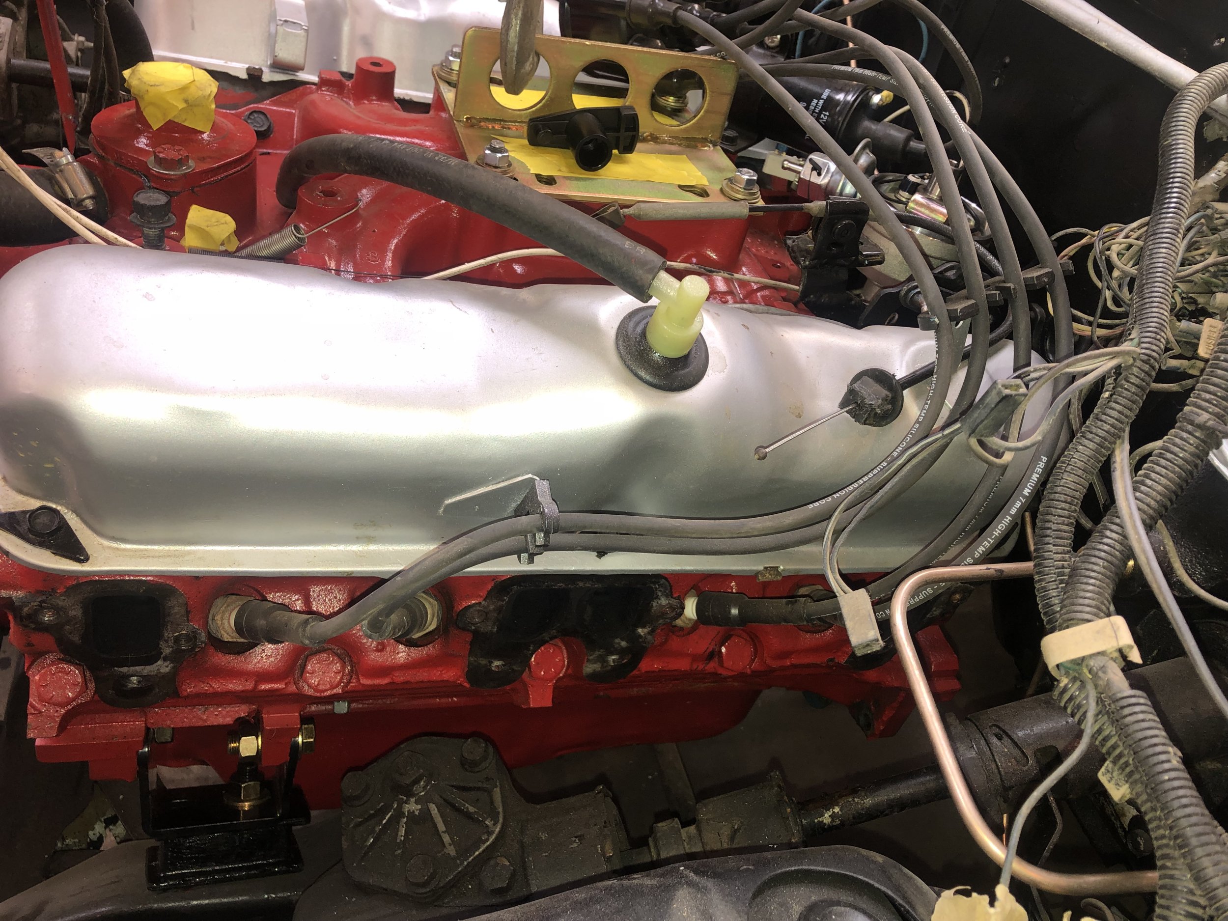

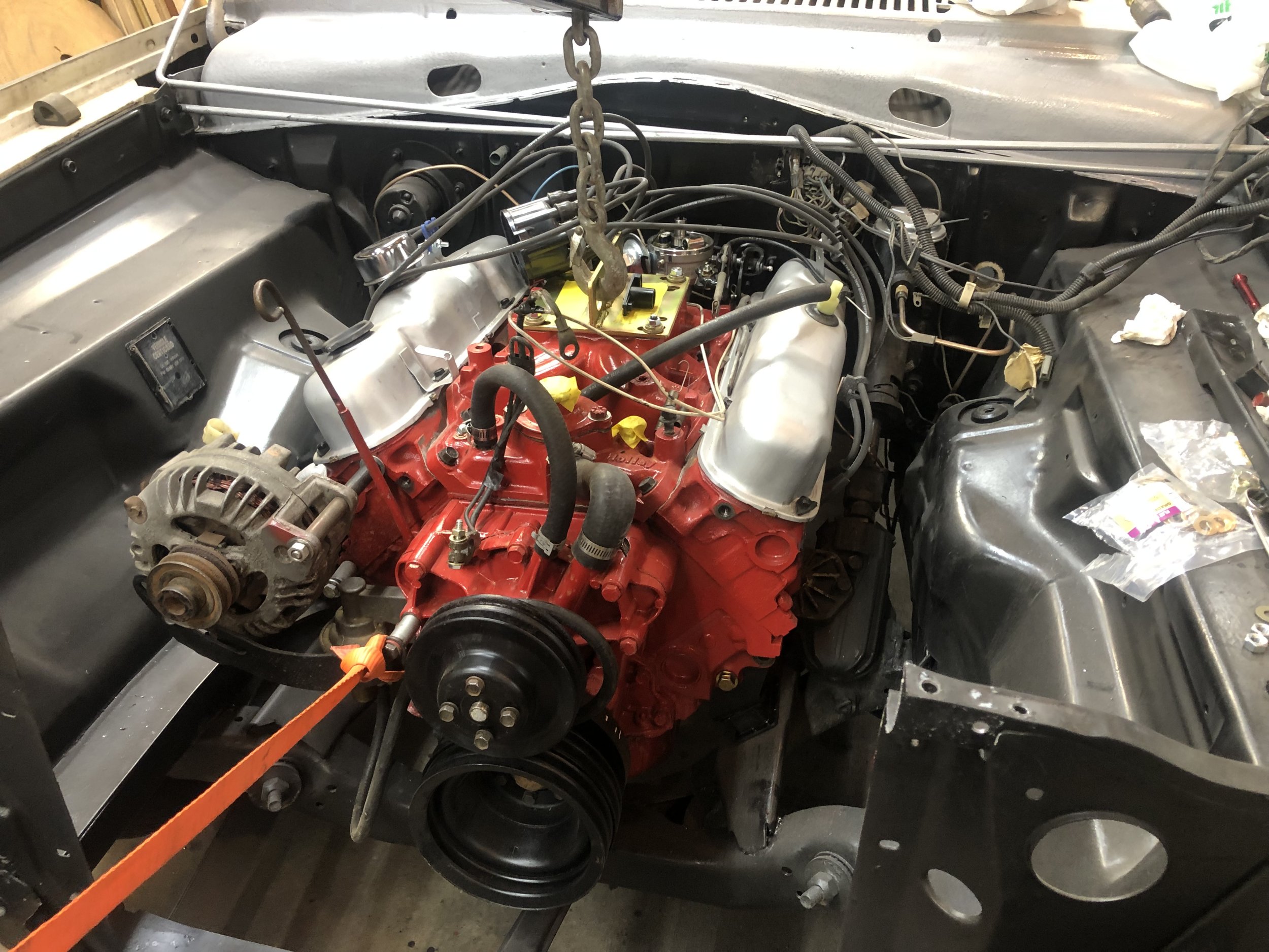

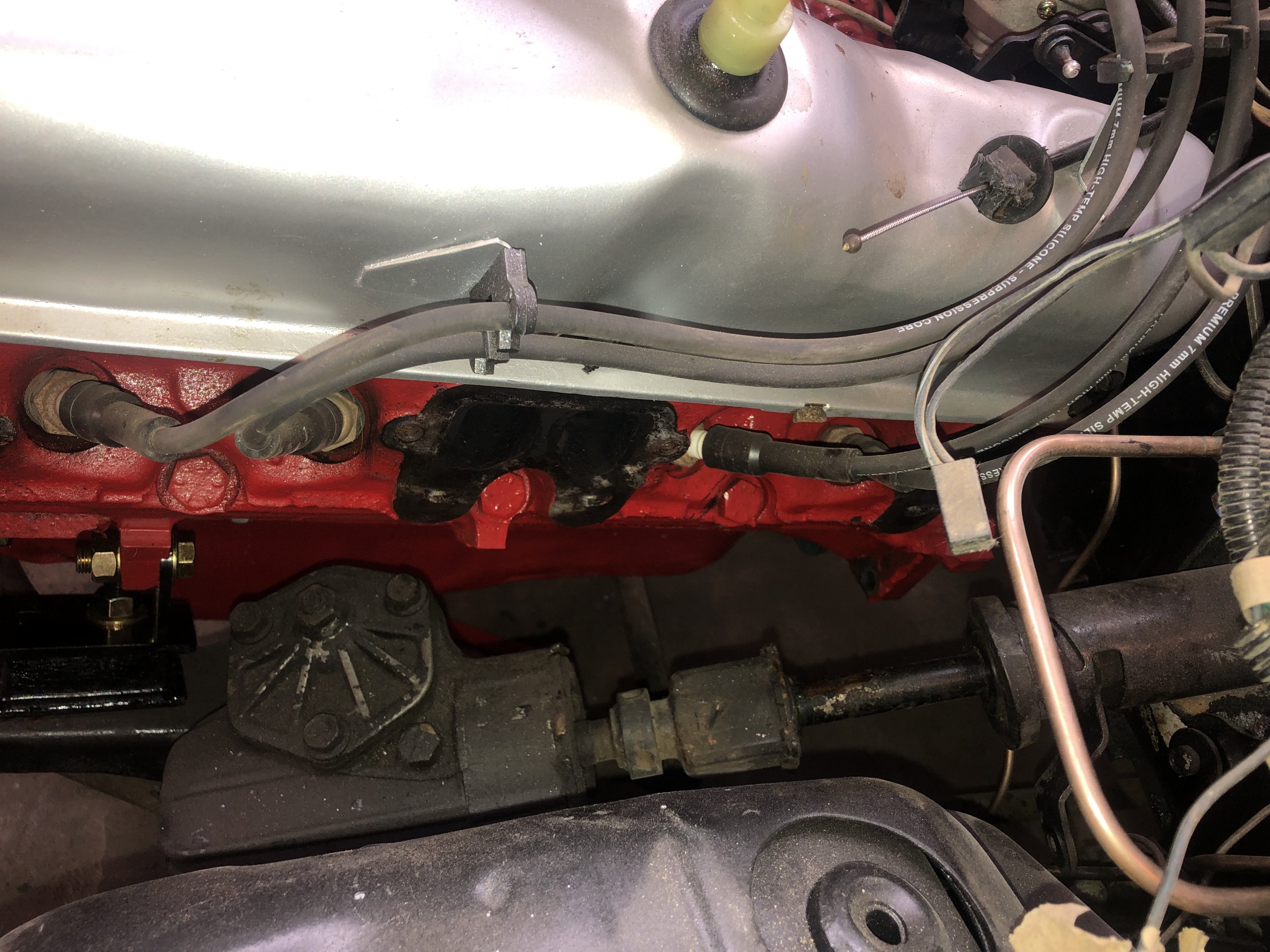

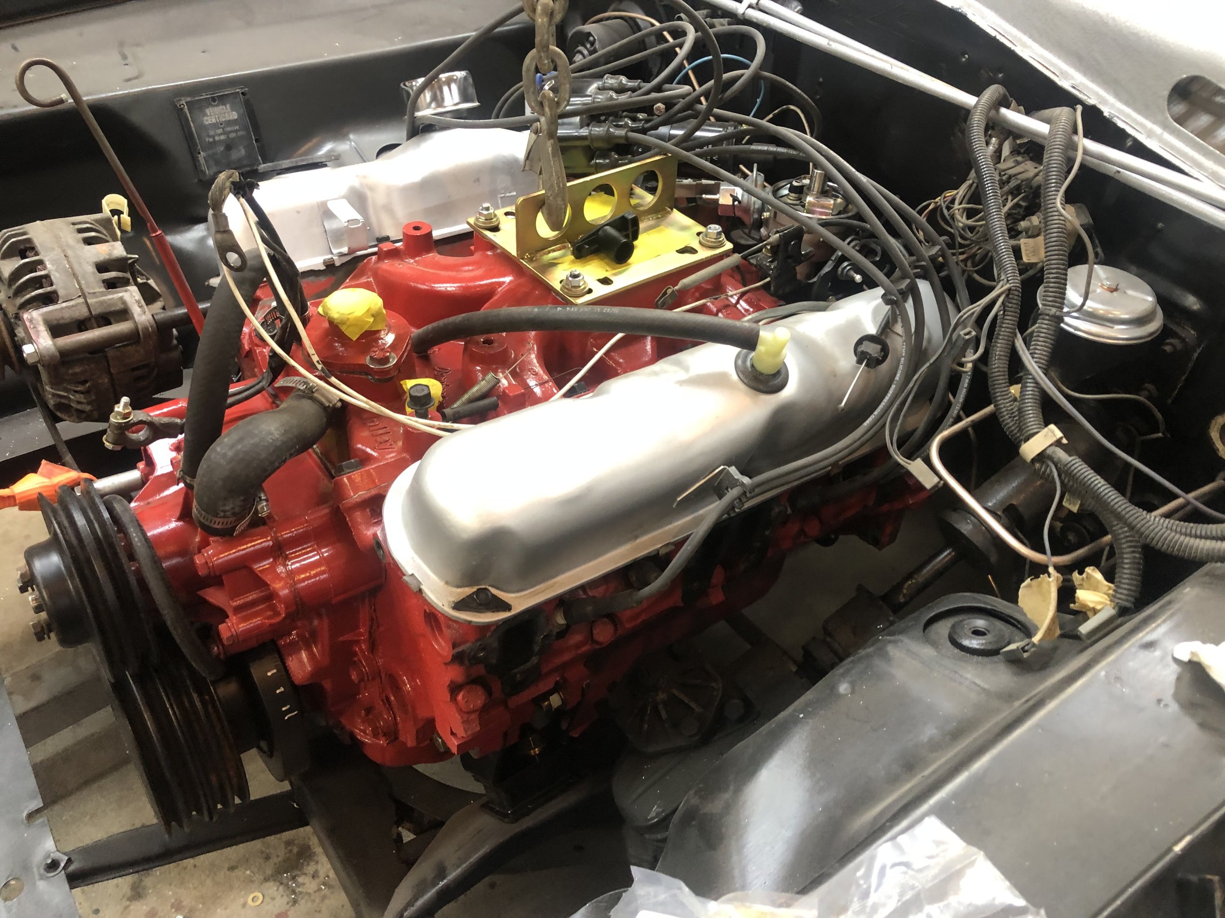

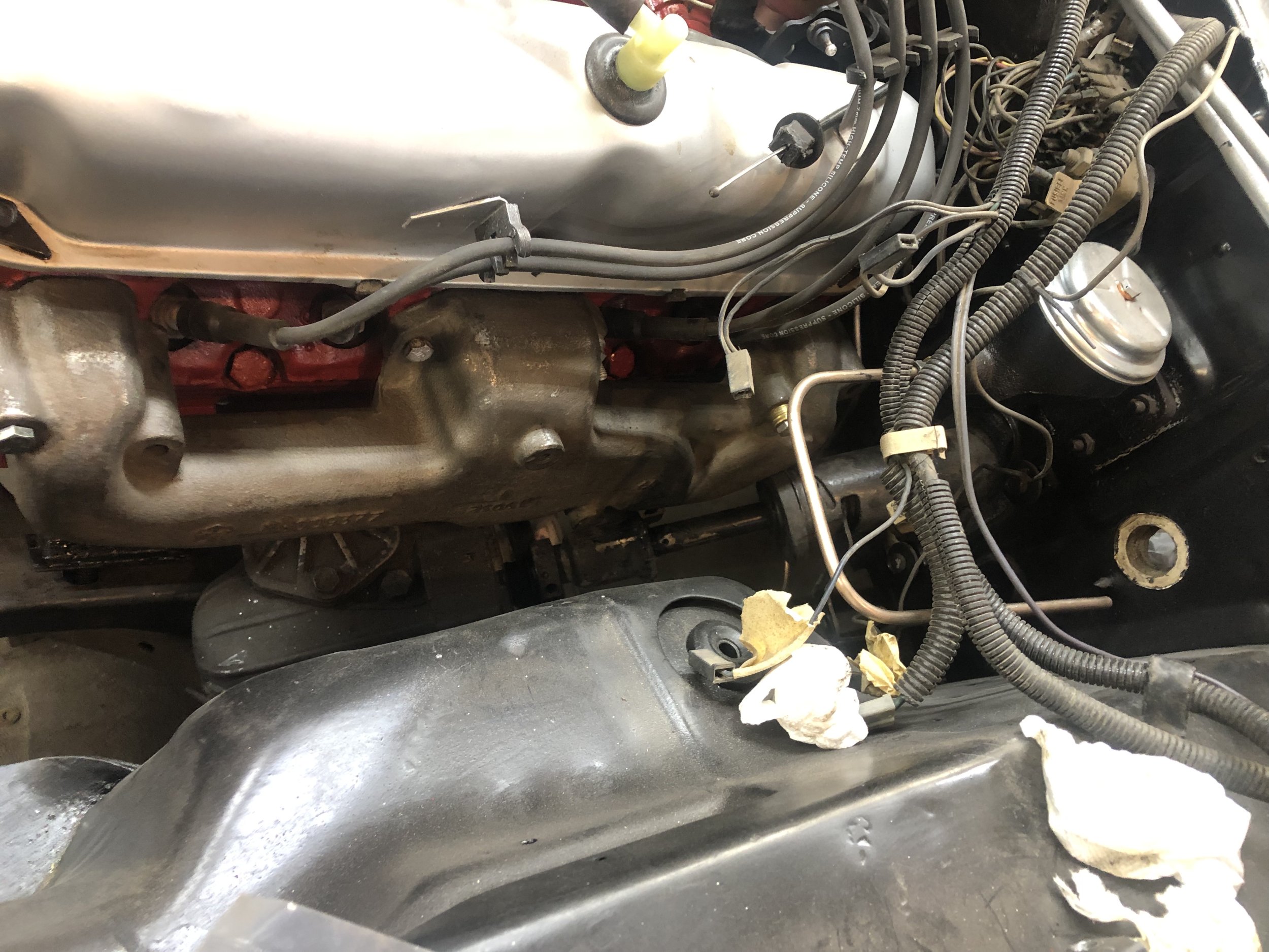

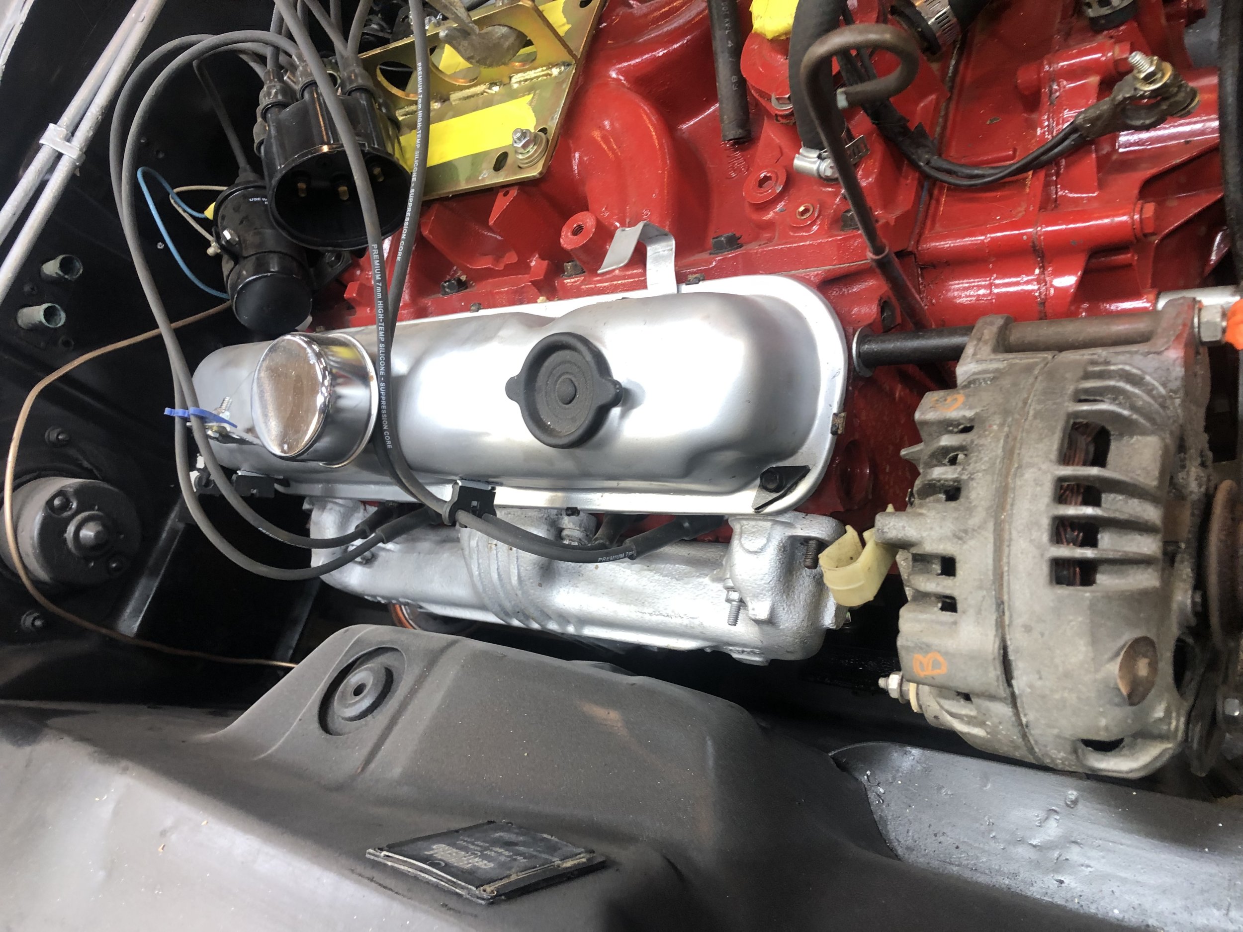

    IMG_3384.jpeg IMG_3384.jpeg IMG_3383.jpeg IMG_3382.jpeg IMG_3380.jpeg IMG_3379.jpeg IMG_3378.jpeg IMG_3363.jpeg IMG_3361.jpeg As you can see it’s a very tight fit. The fabbed manifold pics I got from a Mopar site. I thought about using a 92 Dakota manifold but it would require Some grinding on the steering column tube and manifold and a mini starter. I may re-examine using the manifold just cut a couple inches off the tube and get a mini starter The manifold has a 2-1/8 outlet.
    Dan
    Tow Truck Tom likes this.
