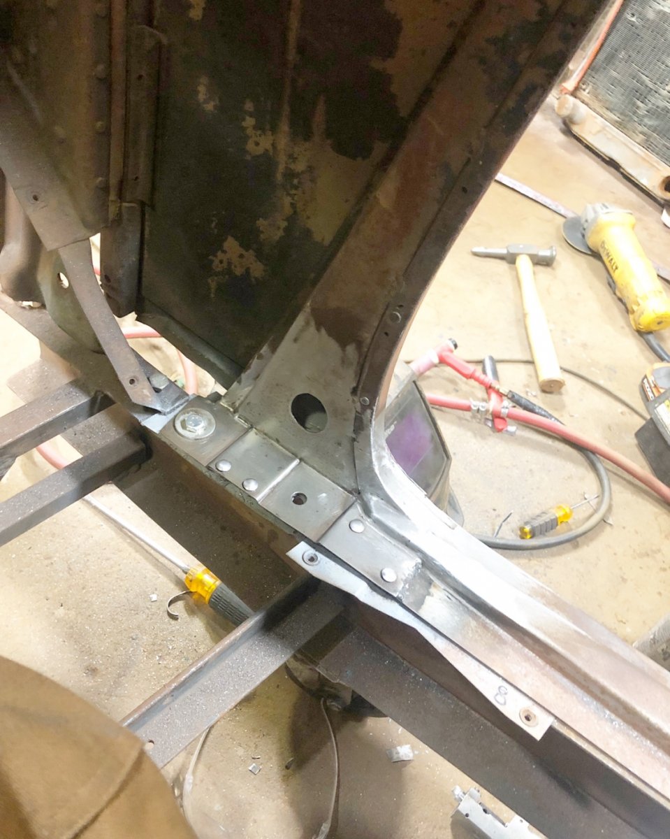

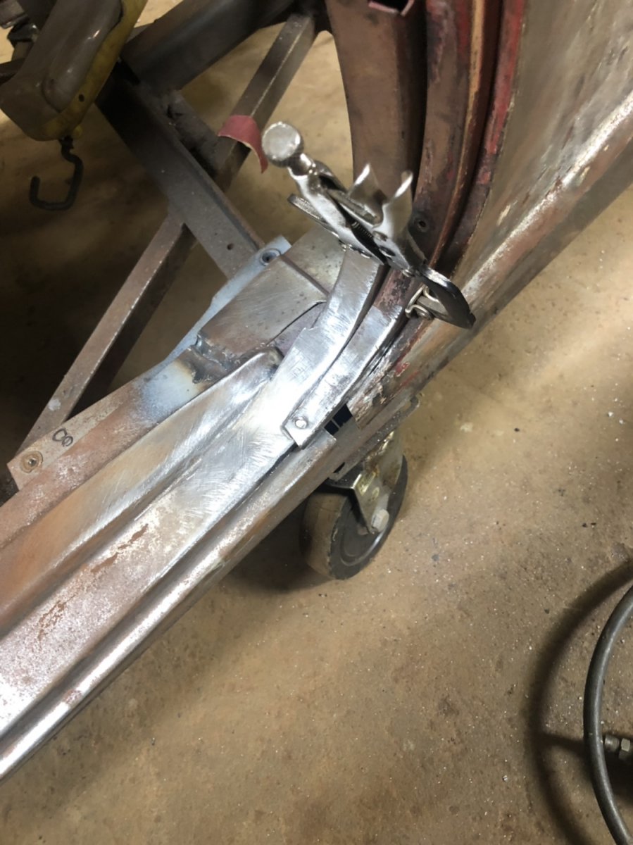

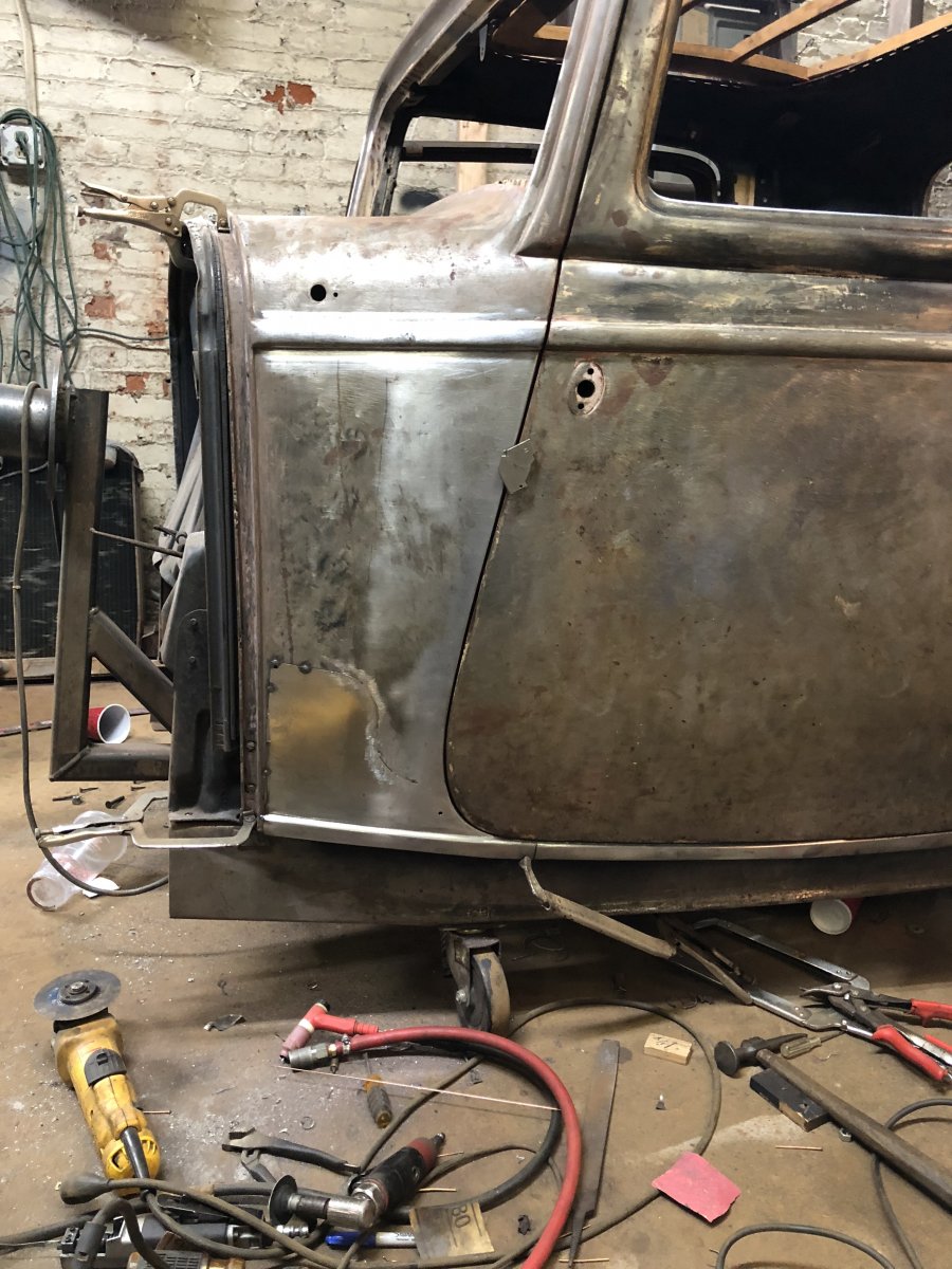

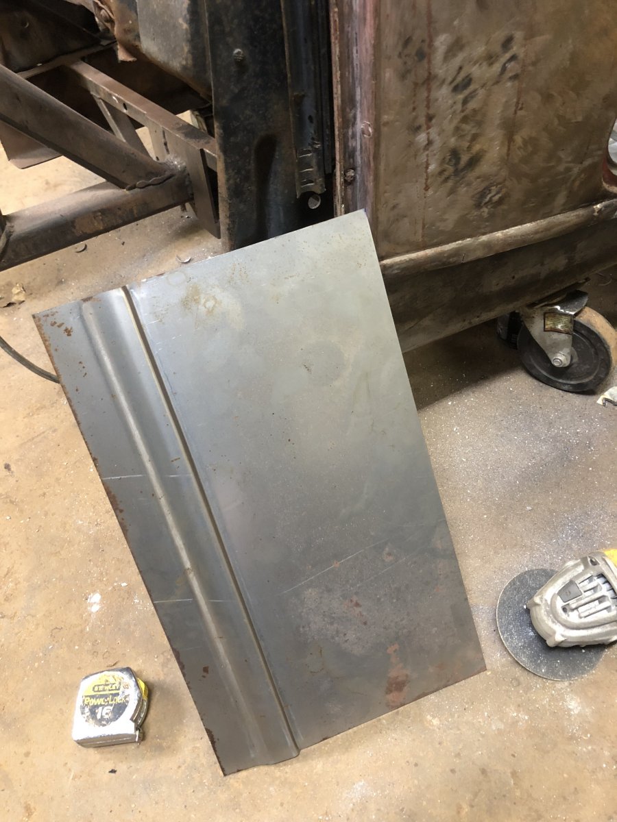

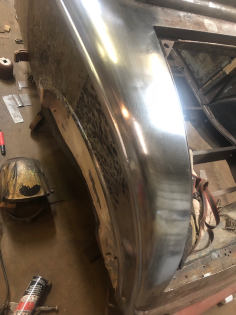

    Thanks guys ! Starting on sheetmetal work
    3D36FB05-91F4-404E-A37F-4BFEAD1FCF86.jpeg 2A44645E-E03D-4459-8FF7-5535E8C58679.jpeg 5FD4DA13-3CC5-4676-99F6-962336D84138.jpeg 656F4AC5-B987-4453-A917-2C8C87C5630B.jpeg 038F391D-49A3-49C1-96CB-54715BF704C2.jpeg 108709B5-6EC2-433B-8031-3FF4B5225AA6.jpeg

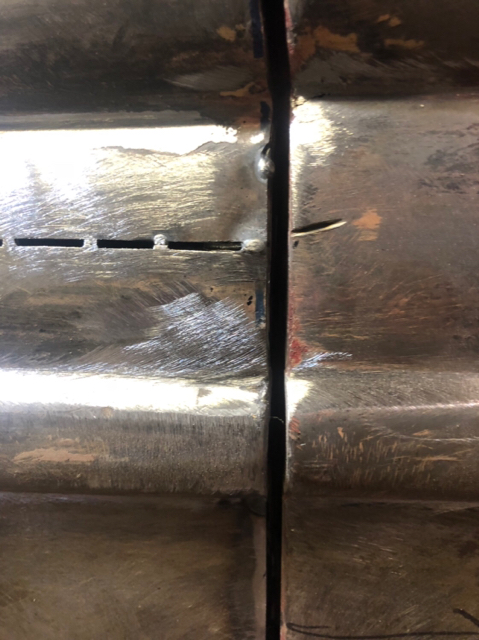

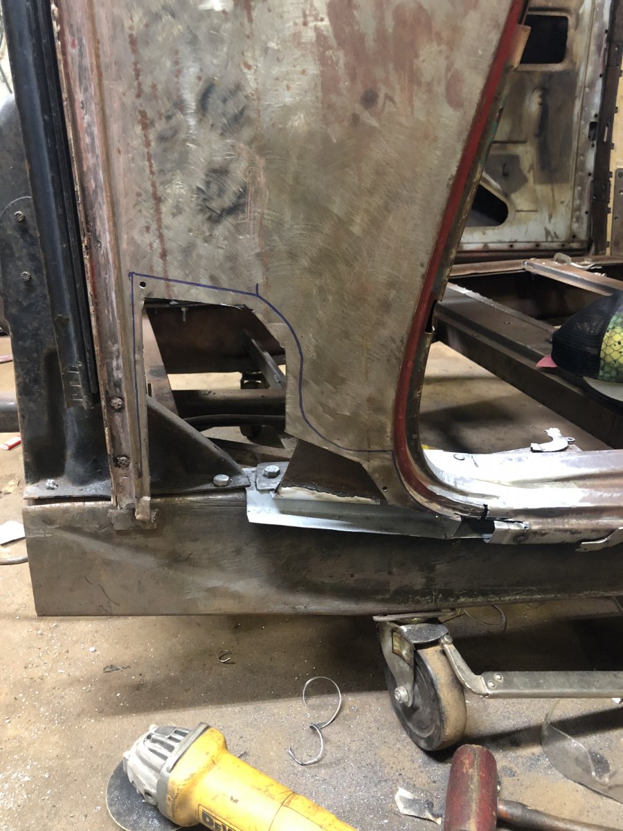

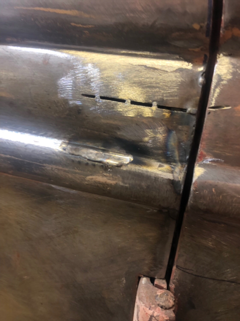

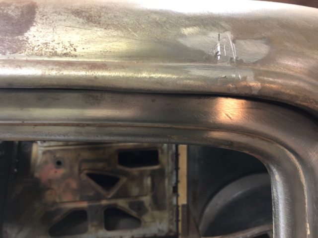

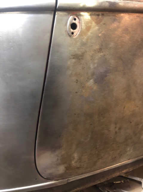

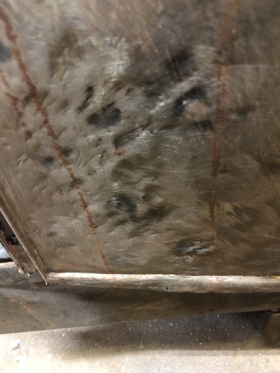

    Got the patch panel I made up welded in
    Time to address the top of the cowlside and the door edge now
    Someone ground the edges off to make gaps
    Als27T, ls1yj, tb33anda3rd and 7 others like this.

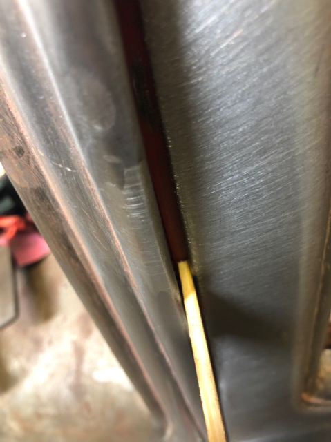

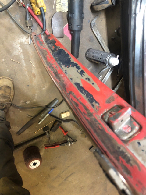

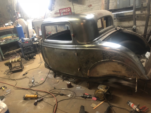

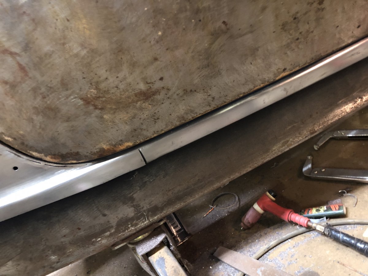

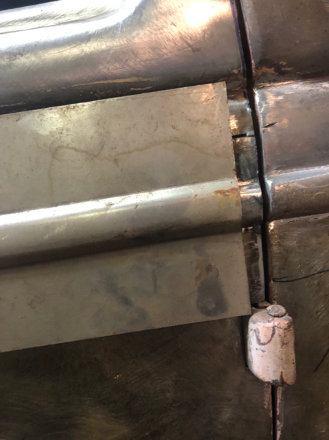

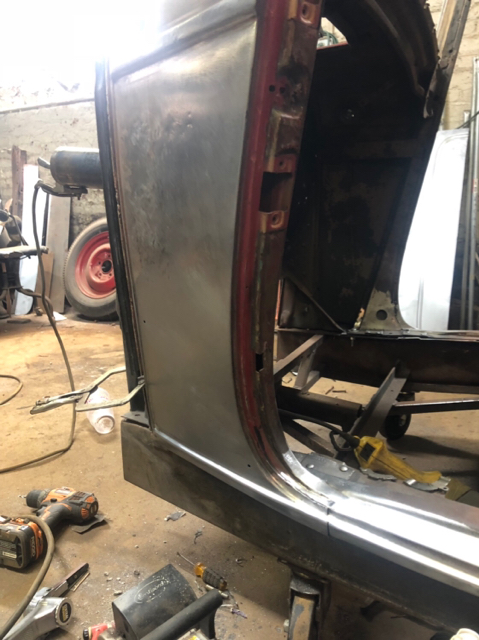

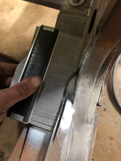

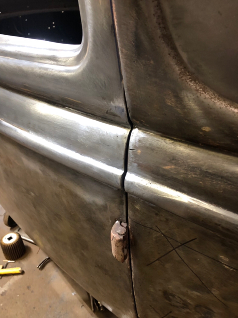

    Door didn’t line up
    Ohhhh it was all made of lead [​IMG]
    Difference in body line where the lead was shown here
    Luckily 32 roadster body line is damn close and I had some laying around testing a pullmax die out

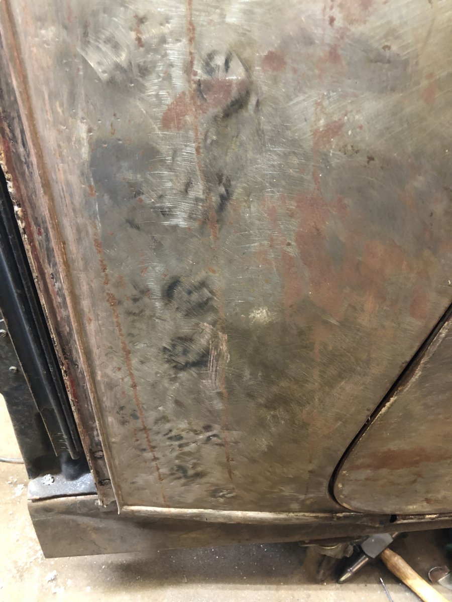

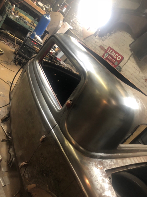

    Fixed some ford work up [​IMG]
    Quarter moved along
    Dents and mig welds
    File it out in the morning
    Tomorrow looking me in the face
