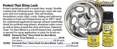

    what a timely post- i just took the offy valve covers off my car and spent a long time polishing the various stains out of em- am too cheap to buy zoop, but i ordered a clear from eastwood that they say will protect it and maintain the shine, i will let you folks know how it works

    Is the Eastwood stuff different than regular clearcoat?

    this is all i know about it so far

    Eastwood Diamond Clear- took my offy valve covers off- they were oil covered and white from watermarks. polished em up with wenol- got them really shiny- not the factory mirror buff, but still pretty shiny. layed on three thin coats of eastwood. the stuff has glazed a little bit- had the covers been mirror smooth, they certainly wouldn't be now. but on the non mirror finish, it is not very noticable. i wouldn't use this on something that didn't take a lot of abuse but i run an open hood car, the covers get oiled and watered pretty regularily, and if this stuff holds up, it will will well be worth it- not a show quality finish though, but they look a damn site better, and if i can just wash em down, then life is good

    i used that eastwood nylac stuff...i don't know if it's the same as their crystal clear...but i hated it,it sucked,flaked and looked hazy...pure shit

    no it's not, the nylac stuff turns yellow and isn't gas/oil resistant- this stuff supposedly is, but time will tell
