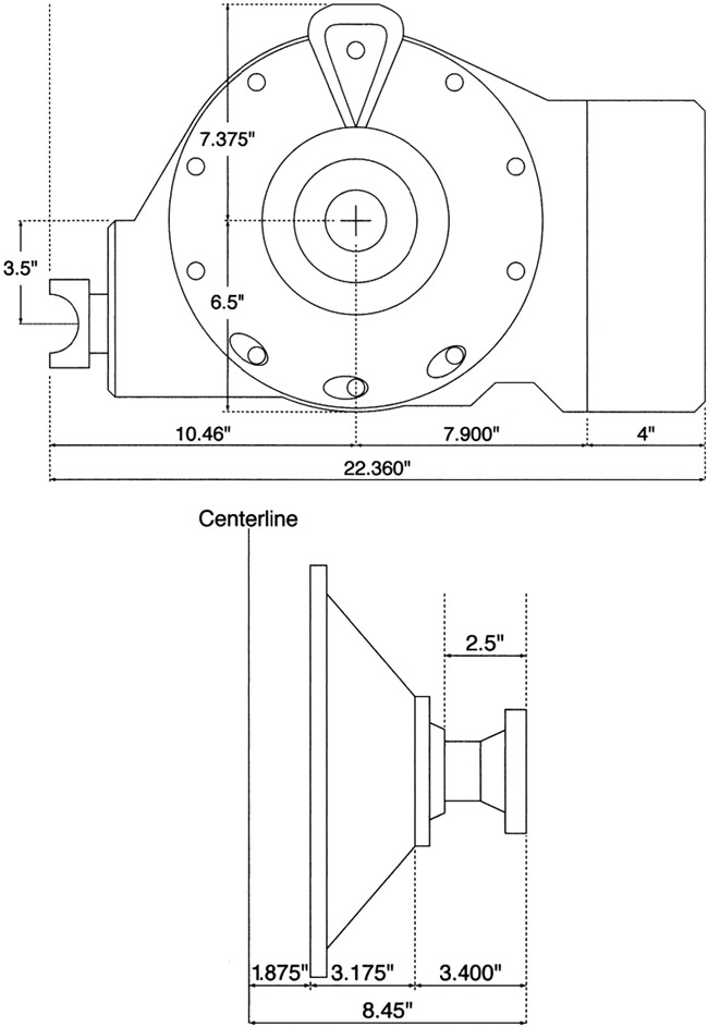

  9. DDDenny
    Posts: 19,270
  10. raven007
    Joined: Jun 27, 2011
    Posts: 33
    raven007
    from Georgia
    Nice. I am guessing waaaay more than I could ever afford. The measurements are good to have though.
