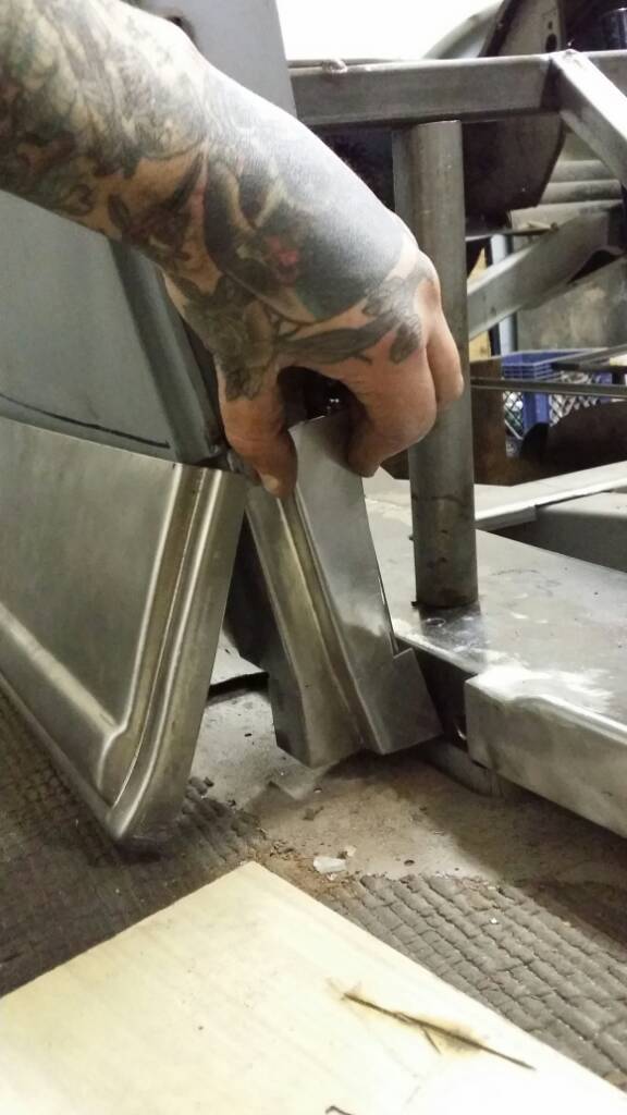

    Today I had some direction so armed with a zillion measurements I made some cowl feet, and got the A pillars mounted to the subrails! Definitely a milestone. The b-pillars
    Kind of fell in line and after some headaches I got the drivers belt line lined up, however my door belt line is a slightly different width than the 1/4. I think I can work it .I kind of have a plan.

    I ended up having to mess with the tail pan area to get the pillars in line, and that all fits better now too. I test fit my trunk floor and it fits great now. Once these doors and pillars are in the bag I'm gonna be able to open all kinds of whoopass

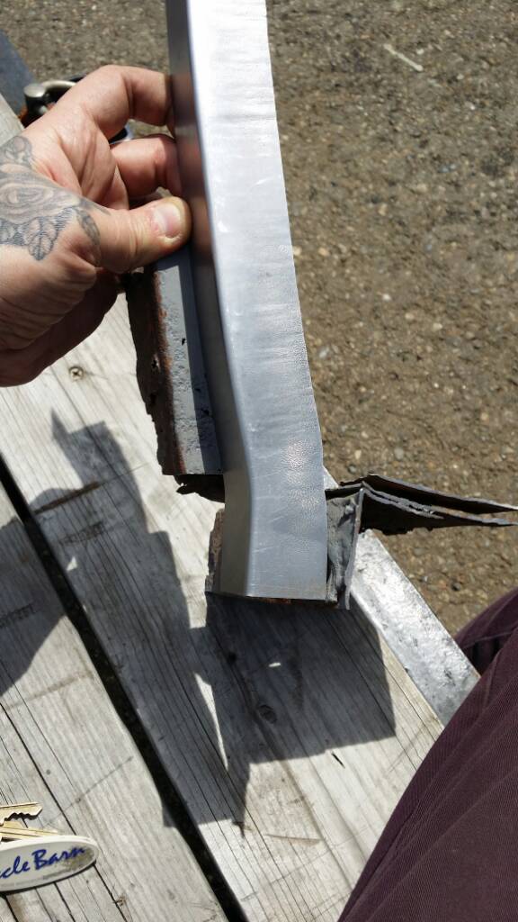

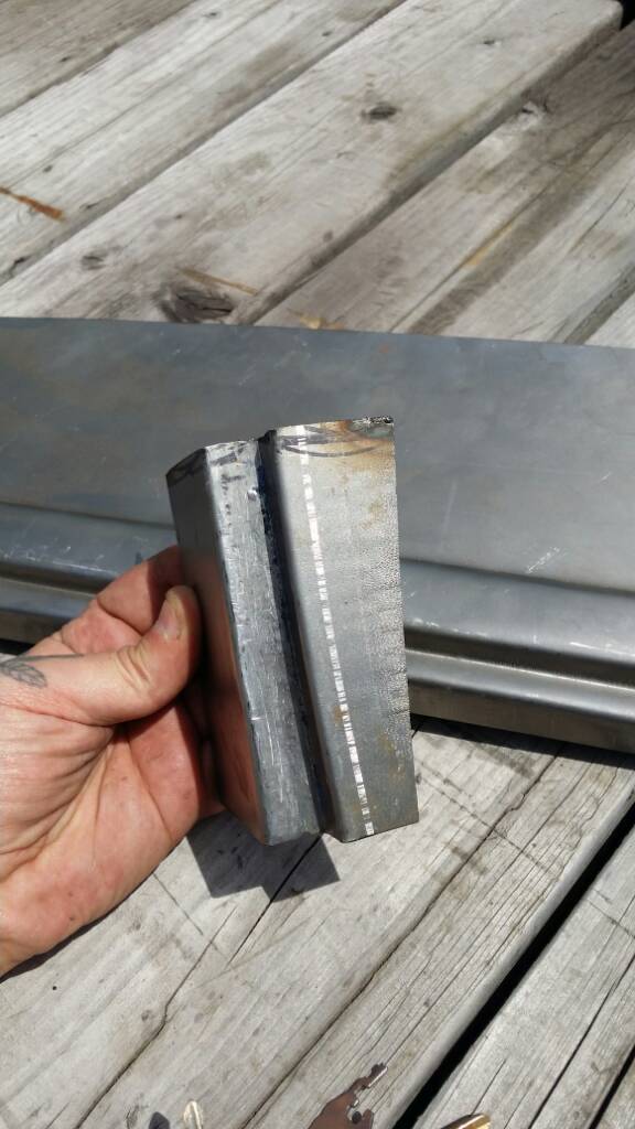

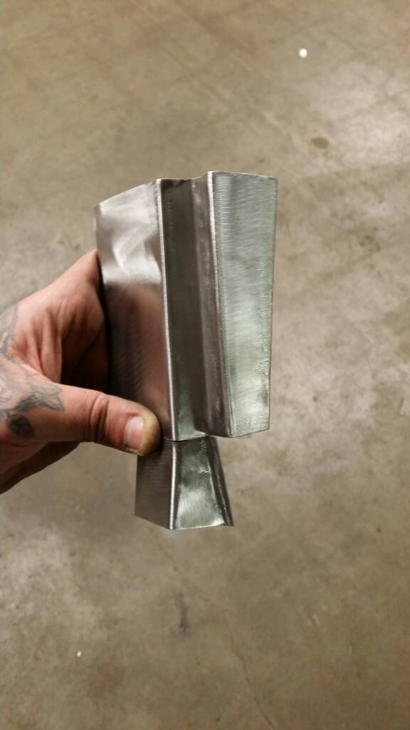

    So now it's on to rebuilding the b-pillars. I got to use Marshalls eckold hand former which made things easier.
