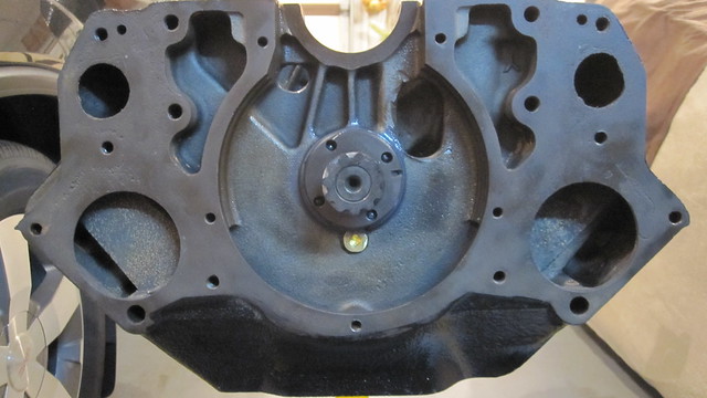

    Its happened. The building has begun. Its going to be a long road but one that should result in one lumpy sounding flathead.
    Like I said, its slow but I'm wanting this to be done right, so I'm studying as I go and thought I'd share where it is at this point.
    A few weeks back I posted a question regarding valve assembly installation and received some great help and advice so thanks to everyone that chimed in. Below is the result. I hope it's the right process. Chime in if you see something out of sorts.
    First I wanted to clean up some of the machine work, relieved the ledge at the valves and added a relief to the lifter area for future valve adjustment.
    Installed the infamous front oil plug and cam.

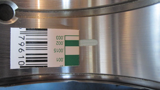

    Then checked the crank clearances which came well, but I couldn't install the crank officially because I was without my upper rear oil crank seal. (unfortunately it went the way of the dodo as soon as it hit the hot tank. I'll take this as my official new-flathead build mistake.)
    So without the seal I turned my attention to prepping the valve/spring assemblies.
    I wanted to approach the valve assembly as a big methodical process. I began measuring each valve individually and marking tagging them individually with there specific location in the block. Then replicated that spring height on a valve spring tester and shimmed the spring to meet the appropriate spring pressure while maintaining the installed spring height. (I hope that makes sense.)
    So now each valve/spring assembly is set to its own specific height with the appropriate shims to achieve a uniform spring pressure of 75psi.
