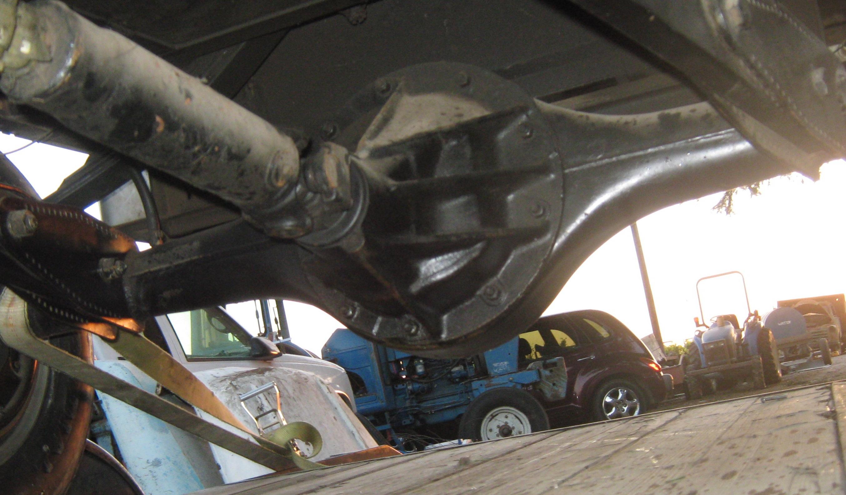

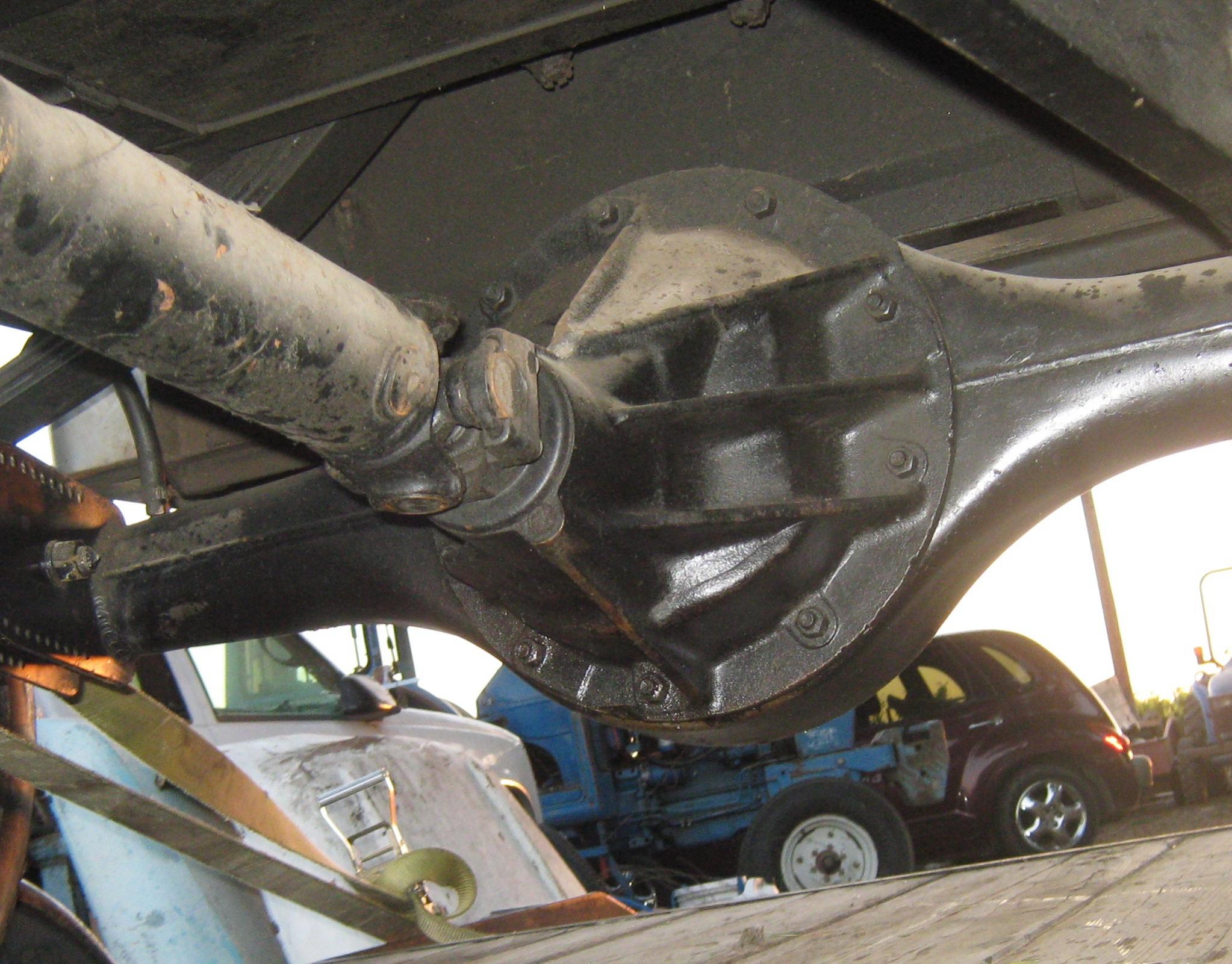

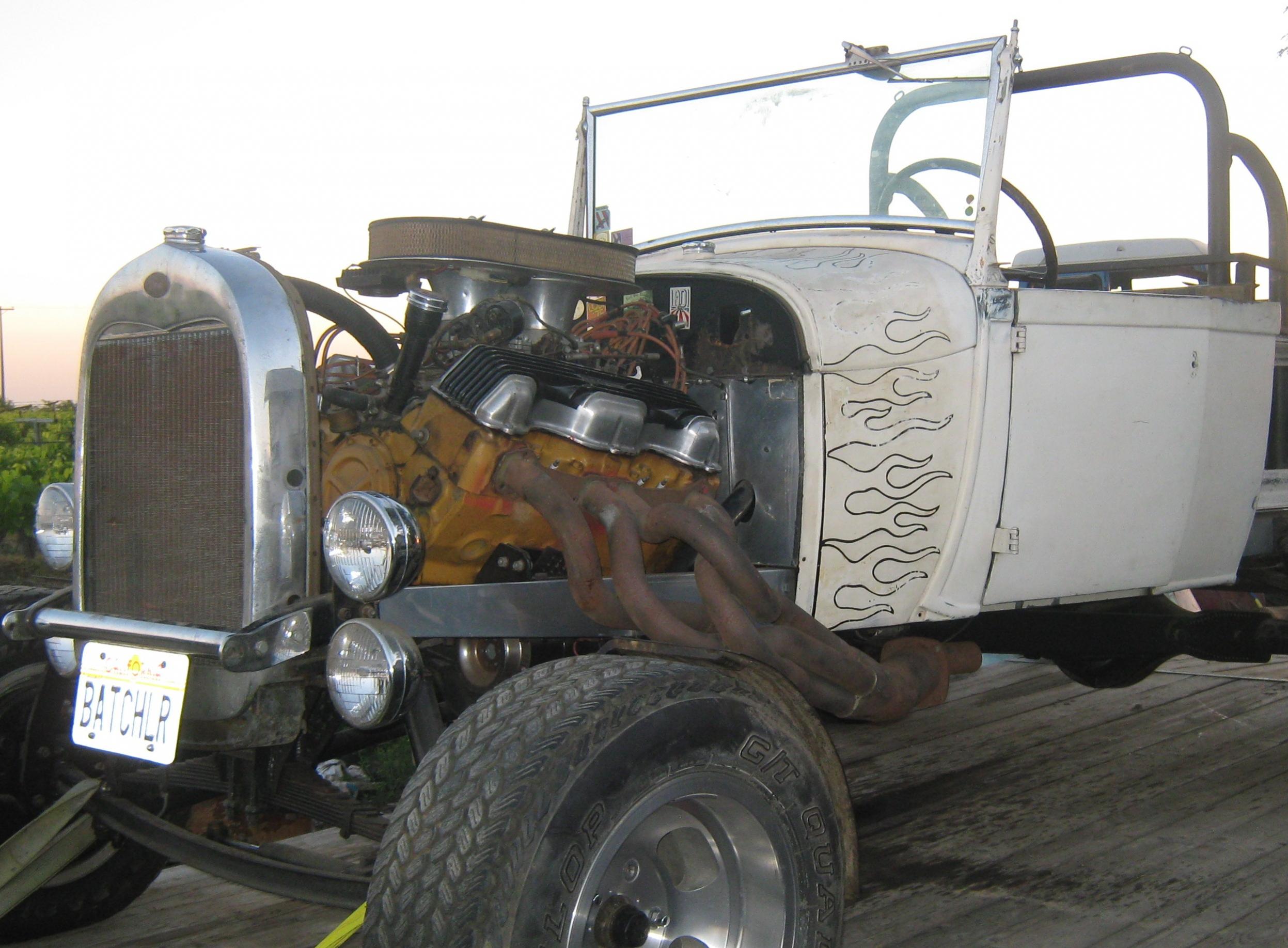

    I have a 29 RPU I just purchased. It has ether a Olds or Pontiac rear end I need help to ID so that I can order some brake parts. Also Is there a year or model like wagon maybe that has larger brakes. Planing on only running rear brakes with 12 spokes on the front. Here are a few pictures I can get more if needed. Thanks for the help in advance Jim
  2. Center section or the drop out is 59-64. Could be a 57 housing. Never the less, 57-64 is the years of application.

    Jim,
    The rearends are the same olds/pontiac.What you need to check is the size of your brake drum.You need to measure the the drum both ways diameter and width. ( should be something like 11 x 2 or 11 x 2 1/2 )

    So Jim, the photo shows a street plate. Am I to understand that you plan to run the beast on the street with no front brakes?

    The pictures you show are of the center section that fits 57 to 64 you need to check your drums and or backing plates. You can order all the brake stuff for a 59 to 64 Pontiac try it and see what works, I only run Pont./Olds stuff and there are differences in the backing plates , shoe width and drums. More info is needed but the parts are available.

  18. It appears to be 3rd gen, 59-64. But, if you want to know if it's a Pontiac or Olds, you'll need to get the casting number off of the center section. The date code will also verify the gen. Facing the pinion snout, they shud be at approximately the nine o'clock position, either out on the center section flange or in closer to the snout. Numeric casting number and alpha-numeric date code. If it is 3rd gen, your rear brakes are #228's, 11x2, either Olds or Poncho. According to my '63 Pontiac service manual, the big brake option for Police, Ambulance, etc., consisted of a bigger brake drum (finned) with standard brake internals. This drum also required the use of 15" rims instead of the standard 14" rims.
