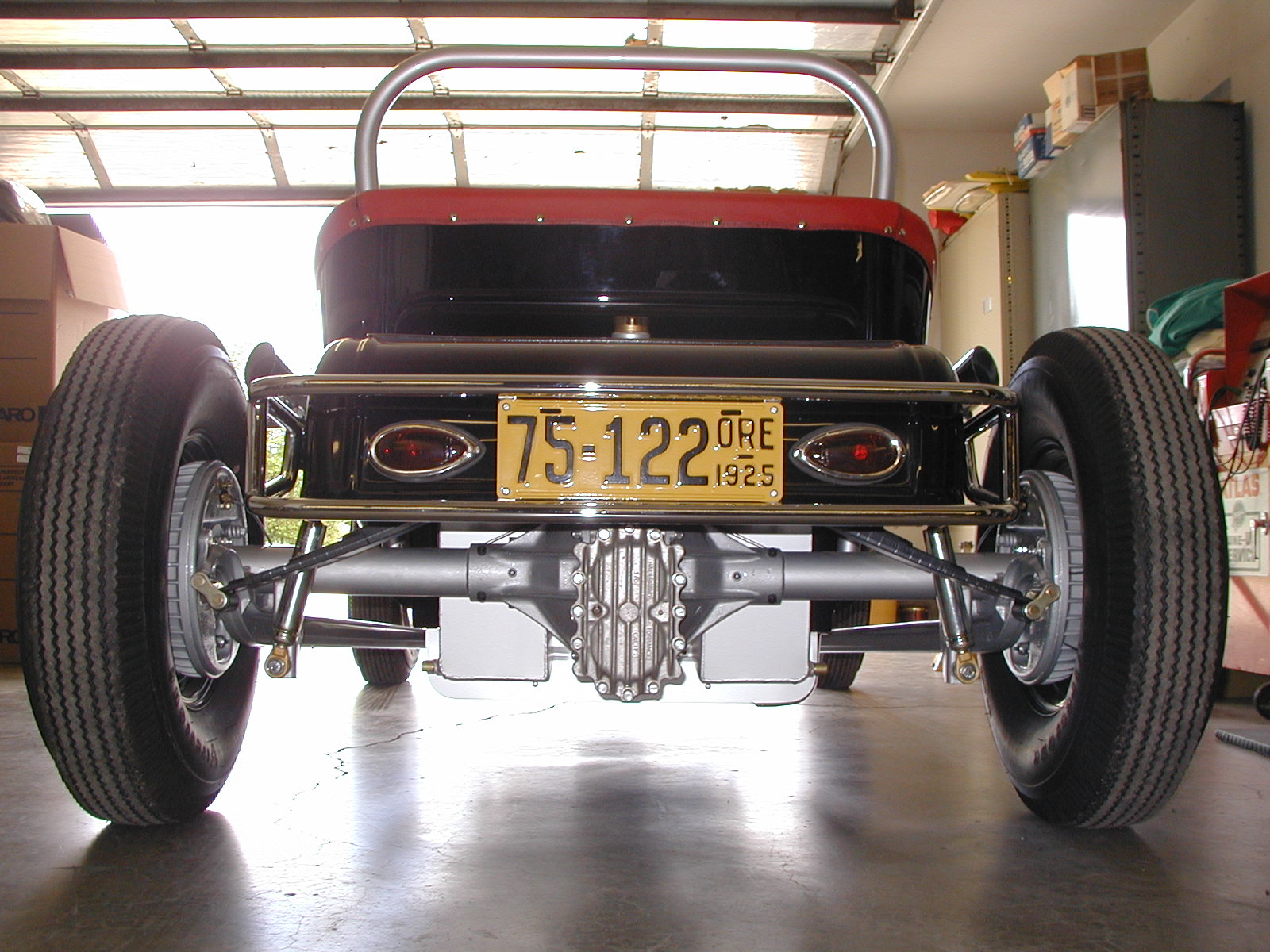

    Not at all familiar with the Highland, but 99% sure those axle housings in the photo are Timken. It uses the modified Timken long section as the QC as well as the short side.

    The first pic is a 39-41, Ford 3/4 ton rear. 39-48 passenger car backing plates will fit, however the hubs are the hard part to find. Also 37-39 pass drums will fit the floater hubs. Another thing to consider is the 12 spline carrier and axles. If you use 9" Ford axle bearing cups, having custom axles for the 12 spline will be spendy! The Halibrand rear in the roadster uses 2 of the truck housings, along with aluminum Safety Racing hubs, that fit the original 39-48 brakes. Finding some original Ford or Safety Racing hubs would be your cheapest and easiest route.
