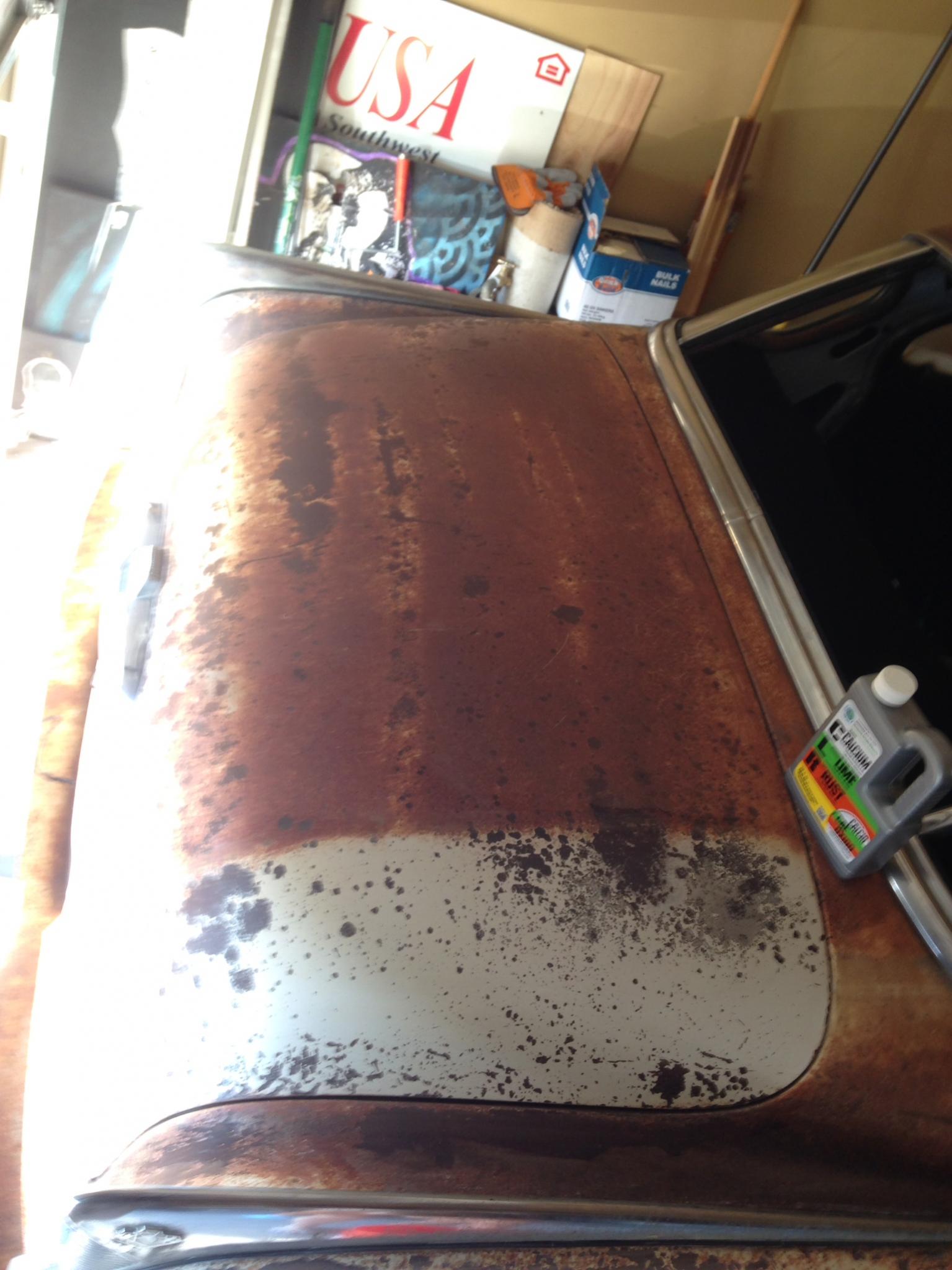

  9. CruisinJRod
    Joined: Apr 9, 2014
    Posts: 28
    CruisinJRod
    from Arizona
    Alright guys... IM SO EXITED :D:D:D I tried CLR. CLR REMOVES SURFACE RUST!! I Didn't have time to do the whole car so I started with a piece to see how it worked. It didn't work with just a rag so I started using a scotch brite pad. As soon as I started scrubbing with the pad it was coming right off.
    Home depot had another brand similar to CLR. The other brand is double the size for the same price. I might try that too. Ill post more photos as I clean off more.
    Here are some progress photos:

  10. low budget
    Joined: Nov 15, 2006
    Posts: 5,564
    low budget
    from Central Ky
    Hey thats lookin pretty good, maybe you could try using just the scotch brite pad
    (or the 180 sand paper)and water to show us all if the CLR is really doing it or the scotch brite pad so we can see if the CLR is really worth the money for this or not.
    I used the 180 and water for similar results cheaper than CLR but it may have scuffed the paint a little more than a scotch pad,not sure?

  18. CruisinJRod
    Joined: Apr 9, 2014
    Posts: 28
    CruisinJRod
    from Arizona
    Good Idea! Im going to work on it this weekend. When I do, I will try without the CLR to see if it still works.
    I was so sceptical about this because there were so many videos online showing you all the options to remove rust and nothing worked for me.
    Stay tuned everyone! I'll post some more progress photos of the cleaning process.

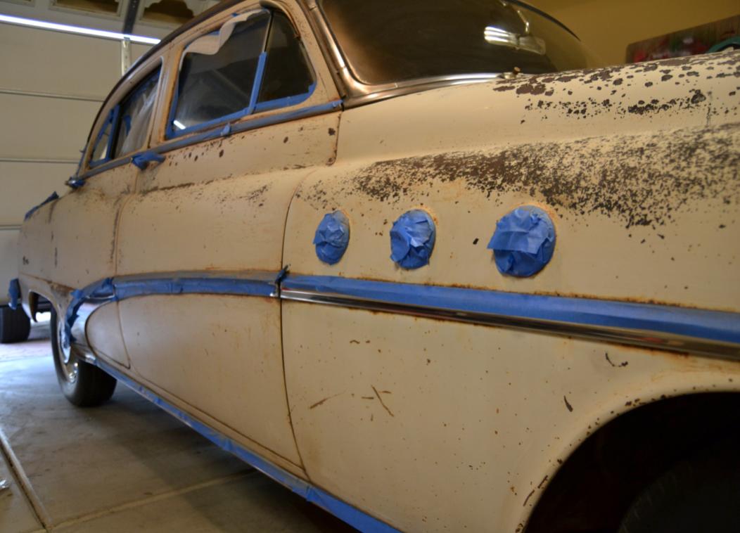

  21. CruisinJRod
    Joined: Apr 9, 2014
    Posts: 28
    CruisinJRod
    from Arizona
  22. CruisinJRod
    Joined: Apr 9, 2014
    Posts: 28
    CruisinJRod
    from Arizona
    Here are some more progress photos.
    I tried just using the scotchbrite pads with water and it was not dissolving the rust as easier.
    kidcampbell71 likes this.

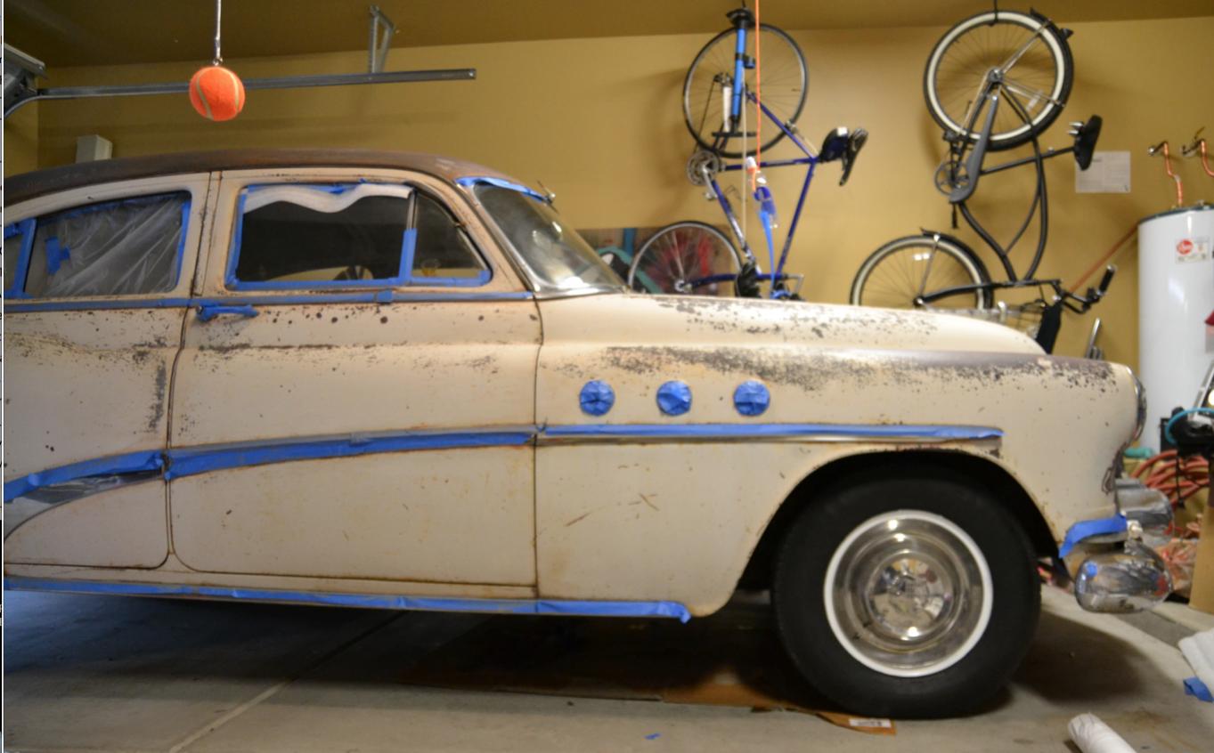

  25. CruisinJRod
    Joined: Apr 9, 2014
    Posts: 28
    CruisinJRod
    from Arizona
    I'm going to buy the zep brand to try it out. I don't know about the dollar store one. Might be worth a try if you have a location by you. I don't have one close by.

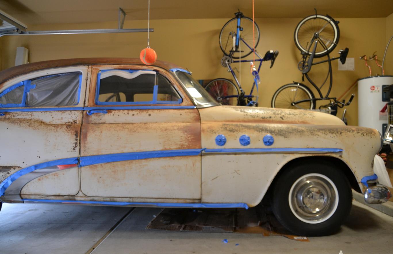

  27. CruisinJRod
    Joined: Apr 9, 2014
    Posts: 28
    CruisinJRod
    from Arizona
    So I had a couple hours this weekend to finish up the right side of my car. I continued to use my leftover CLR I bought. The CLR has brought so much life to my 52 :D.
    Here are some Before and after Update photos:
    (sorry dont know how to resize image to fit perfectly in forum post.)
    kidcampbell71 and a boner like this.
  28. a much better looking ride after a little elbow grease! keep it up
  29. Landmule
    Joined: Apr 14, 2003
    Posts: 456
    Landmule
    That looks much better. It's amazing what a few hours labor and modern chemistry can accomplish!
  30. CruisinJRod
    Joined: Apr 9, 2014
    Posts: 28
    CruisinJRod
    from Arizona
    Thanks guys! Its amazing what CLR will do. Now that I know it works well I will be using it on all my tools that have accumulated rust.
