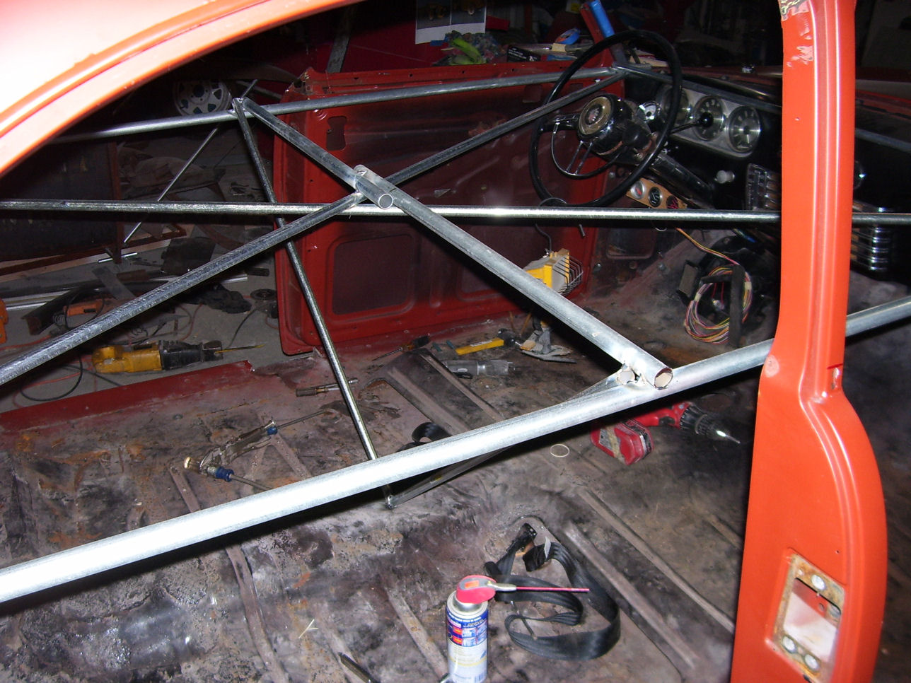

    Just had a quick question as I am doing the same thing to my 55 clipper. So when the doors are all off and there is just the b Pillar and top where do i properly brace the car? from package tray to floor? roof to floor? Thanks

    You can kind of see how the bracing is it's pretty much a rectangle from A piller to C piller then some additional bacing to the floor. As for the glass it is a little harder to deal with then most and cutting glass is a 1 in 5 chance it will brake so be careful and keep an eye out for just in case replacement glass. You can also sink the windshield into the firewall to avoid cutting it. A good Idea too is to pick up some books on chopping tops Tex Smith makes a pretty good one. Good Luck
