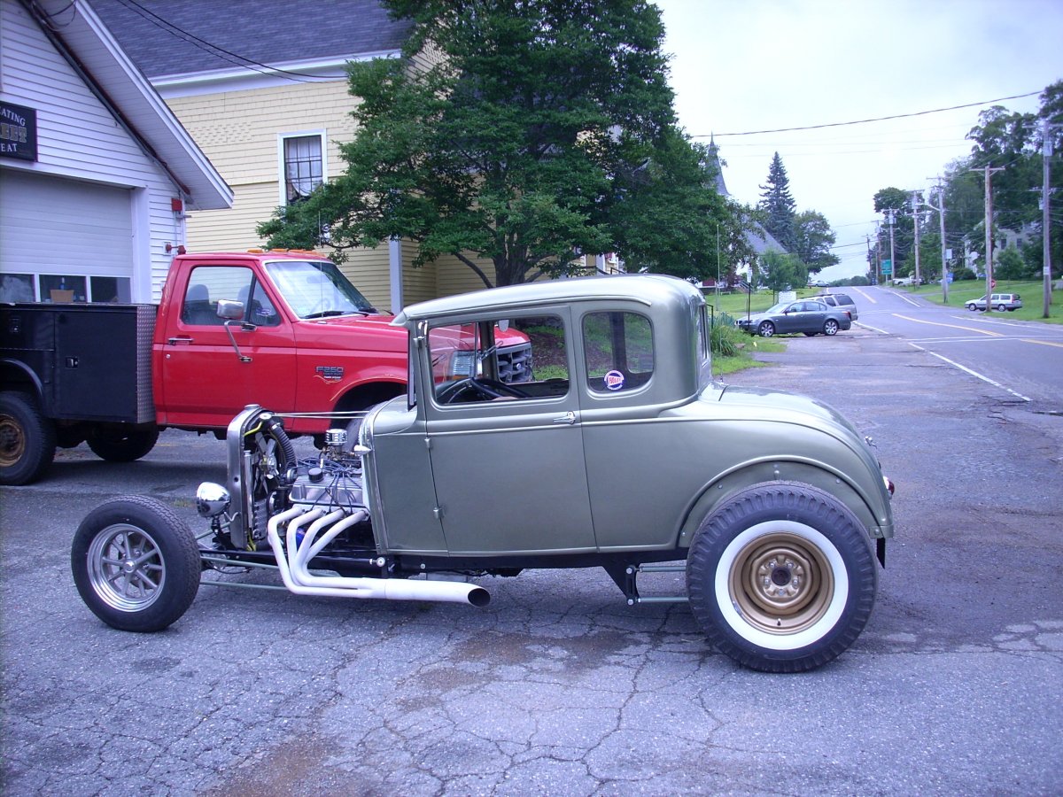

    And there is a picture "in the glory days"

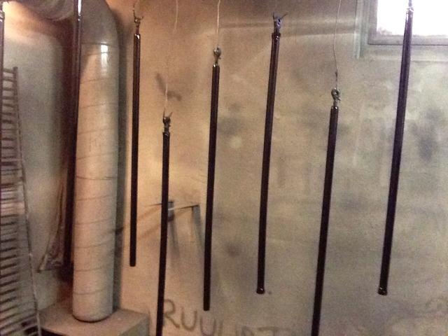

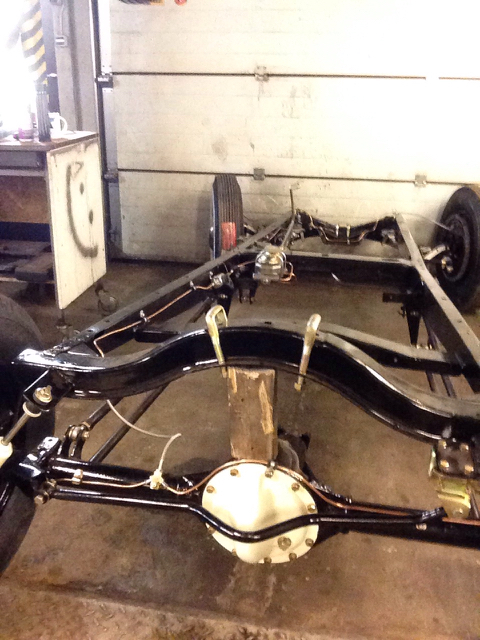

    Re-making the box fitting. Reversed box trough the frame. After that i can paint the frame.
    Cleaned rear axle.
    And painted 4 links
    And front axle
    Doors, good as new. Blasted + Primered epoxy.
