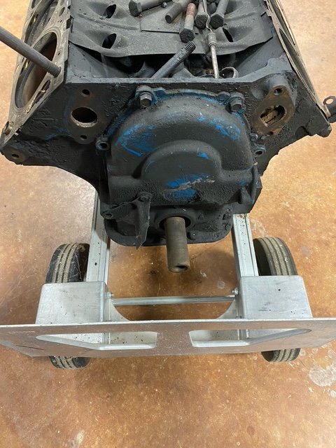

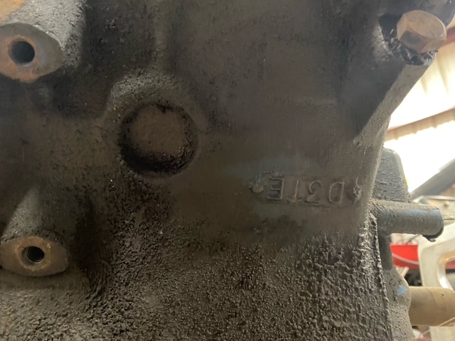

    IMG_2259.jpeg IMG_2260.jpeg So, I have a 360 coming soon. It was in a 74 F100 and thre price is right.....free. A buddy has one down in DFW. I just have to pick it up. I'll wait for the crappy weather to set in and then I'll go get it. It's a D3TE casting, but with FE's that doesn't mean a lot.

    Who knows until we tear into it. I need to get it to the machine shop and get it in the jet blaster.

    "Late" model truck block. Unless it shoved a rod out the side, chances are pretty good it will be useable.

    Supposably, a 1974 360 truck block. Supposed to have been a running driving truck. But, they all are...right up until they quit.

    The D4TE should have the reinforced main webbing that first appeared on the high performance and industrial blocks.

    Does the block have the “ backwards 105” on it? It should. That’s considered a good thing in FEs.
