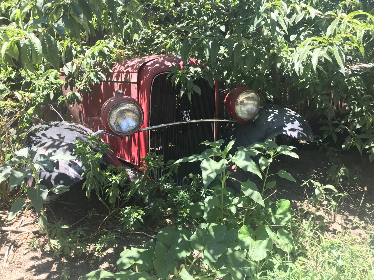

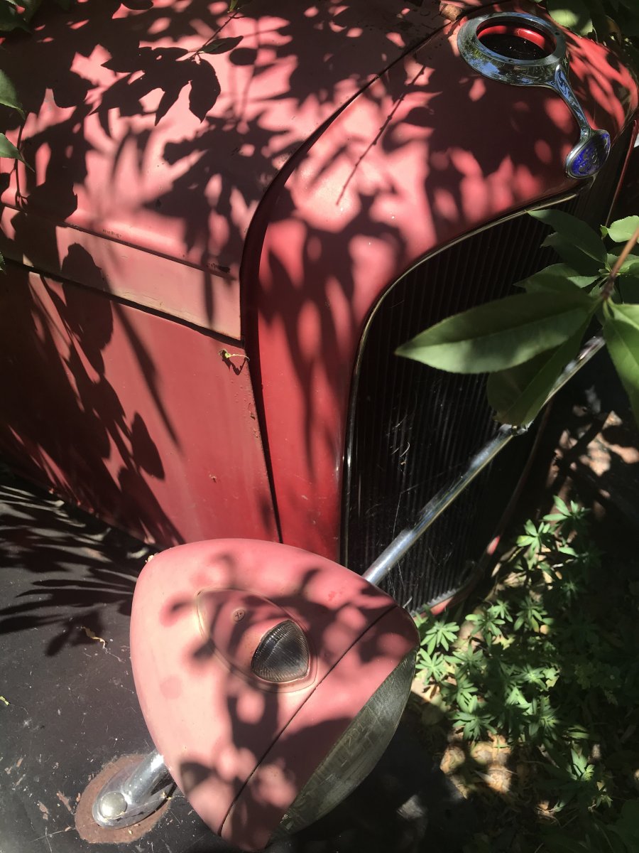

    My yard art was ratttlecanned with red rustoleum, no prep, care or maintenance and it’s been outside for at least 7 years, headlights even longer than that.
    Looks like some areas are holding up better than others. I wonder what a buffing would do?
    E4F90505-B81C-4937-89F7-A32803F8520F.jpeg 99480C5B-B6D1-46ED-8979-C3A636E383A7.jpeg
    alanp561 and LAROKE like this.
  8. Los_Control
    Joined: Oct 7, 2016
    Posts: 668
    Los_Control
    from TX
    Looks like it gets buffed daily from the wind :D
