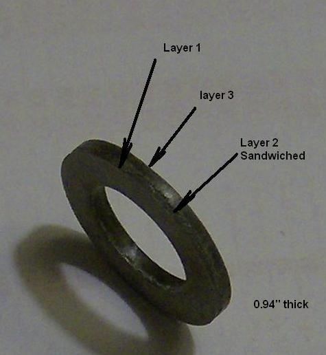

    The parts catalog shows a thrust-washer between the distributor and the oil- pump. (Apparently, the original one did not make it into the pile of old-parts when the motor was torn down to it's bare core.) According to the parts catalog it is 1/2" I.D. X 7/8" O.D. Unfortunately they do not specify the thickness or the material.
    In my gasket kit, in along with the oil-pump gaskets, they include what looks like a multi-layered washer that is 1/2" I.D. and 7/8" OD and 0.094" thick. It has what appears to be some type of impregnated layered material. It looks like the outward layers are some sort of absorbent material as some oil drops have seemed to stain it? The center layer appears to be metal? I don't know what it is made of? But the whole thing is very stiff.
    Could this be thrust-washer 1.666? What is the thickness suppose to be of this thrust-washer? What material is normally used? Is it suppose to be layered?

    The part in the gasket set is the oil pan drain plug gasket.

    Good peg! Oil Plug Gasket, makes perfect sense.
