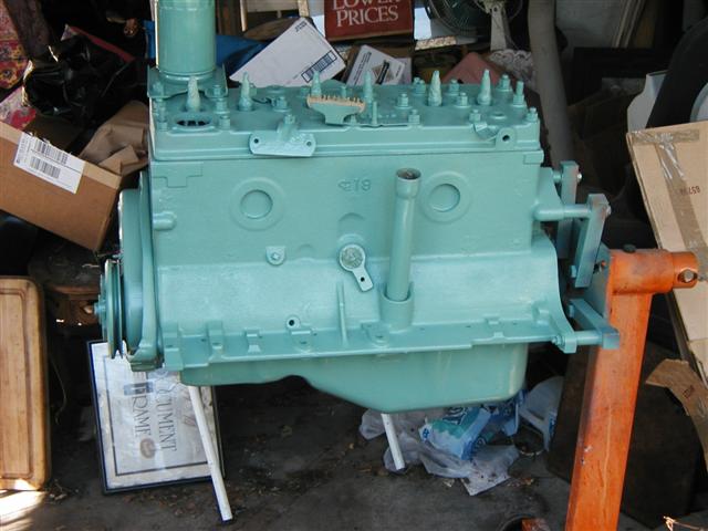

  8. a/fxcomet
    Joined: Mar 31, 2001
    Posts: 554
    a/fxcomet
    from Eugene, OR
    That is why you use one of these:

    wow, thats real purty....i would put a HV Pump in it if it was mine
  10. Kustm52
    Posts: 1,981
    Kustm52
    Send some of the excess pressure to Grimlock for his flathead... :D
    Brian
  11. El Caballo
    Posts: 6,302
    El Caballo
    Is that the engine from your Neon?... :D
