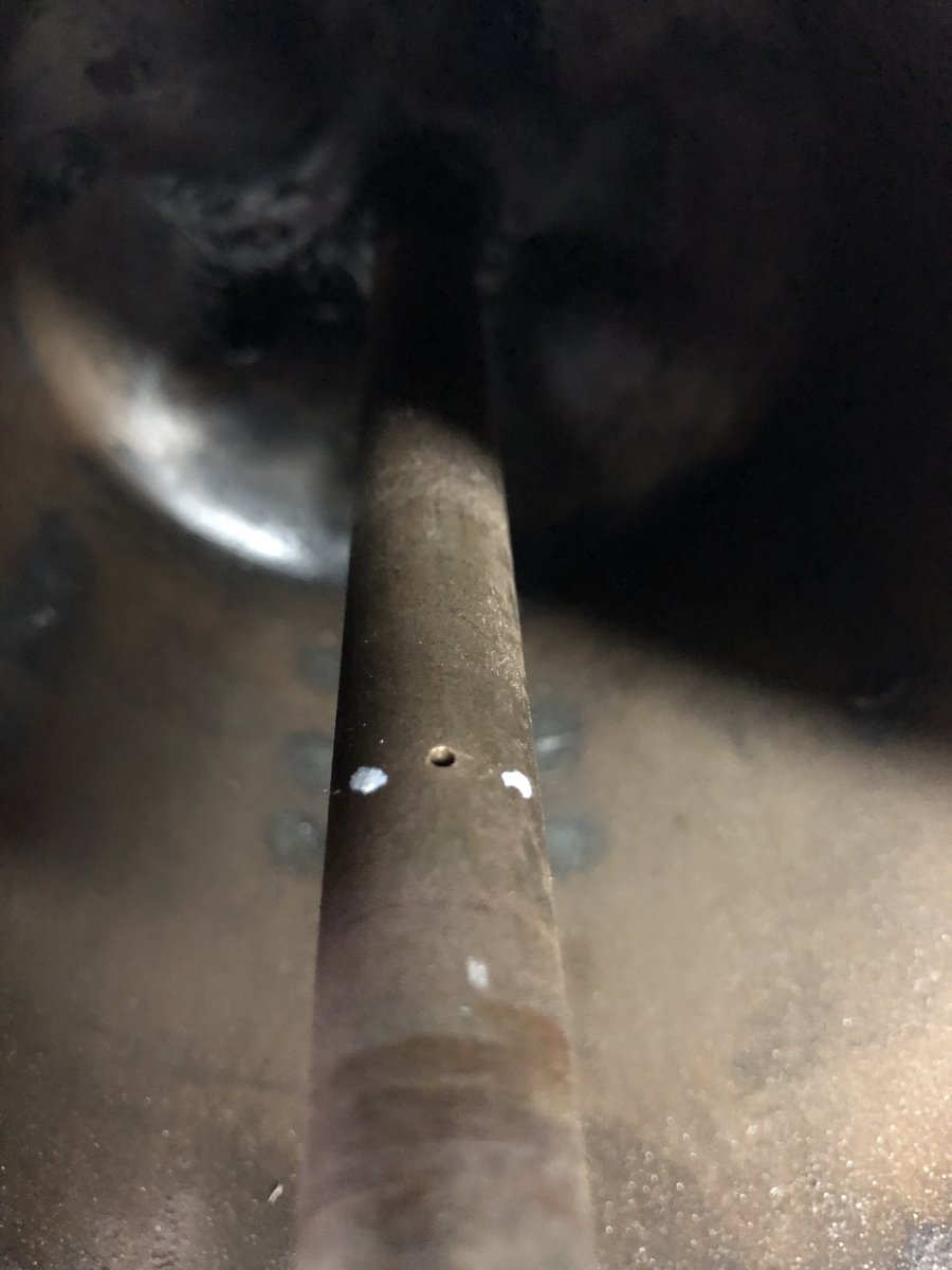

  7. Hey Warbird,
    So the line has an orifice,,,and the inner housing tube as well.
    The line from the block to not over pressurize the can,,,and the tube inside the can for the oil to flow back ?
    Like my pic shows ?
    Tommy
  8. Yes, somewhere in the inlet line there should be a fitting with an orifice, and also the holes in the center tube. I put one of those filters on an early Cad 331 before I knew about the metering orifice... couldn't get the filter sealed up and finally did some research. Filling a fitting with solder and then drilling it out to .090 solved the problem.
