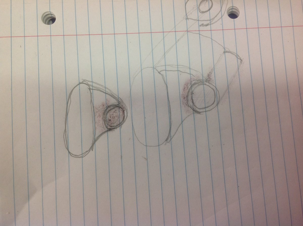

    I'm with Torana68, I would also like to see the tube go thru a drilled hole in the main steel mount bracket and welded..
    Here in New Zealand, I don't think that original design would pass the certification process to allow it's use on the road.
    Stogy likes this.

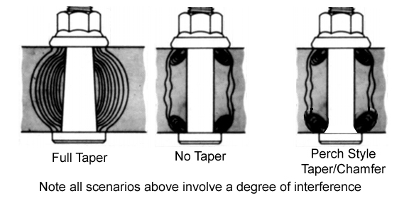

    I would just like to elaborate on my Taper tech I discussed. I now realize that the taper on these Ford and or aftermarket Ford perchs is a sharper angled chamfer near the spring attach end as opposed to a taper over the length of the perch shank. So while it would spread out grip area I don't believe the lock I was describing from Taper would happen...Just sayin...;)
    Below is tech info I gleaned online what I was going on about...
    I drilled Taper Lock Fasteners (Left Image) for years...
    which are a really cool concept acting much like a morse taper on a drill.
    Center image is non tapered. Right image is my modded illustration
    I believe what Perches are like.
    The fancy swirls are how the fastener it effects the structure
    it contacts when pressed/driven in.
    The Blurb about Taper and Non Taper
    Regular Fasteners must be driven or pressed the full
    length of the hole when attempting interference fits.
    This procedure forces the walls outward, tending to
    promote seizure, galling, plating damage and
    broaching the hole. The result is non-uniform
    preloading. This action creates areas of concentrated
    and near zero stress. Thus the fastener purpose is defeated.
    The Taper Lock Fastener fits freely into the
    greatest portion of the hole and need
    travel only a short distance to
    become full interference, uniformly preloading as the
    walls expand. This provides longer wear and
    greater strength.This allows Taper
    Locks to be removed without damage to the
    fastener or the hole.
    In light of all that's happened it may have been as described...shit metal...
    but understanding how things work and discussion is all the good that comes out
    of bad situations.

  26. The tube can not go thru the bracket. The material or bracket that would wrap the tube would need be minuscule and useless to avoid contact with the spring.
    A better idea.
    The wishbone would have to be torn like a sardine can or broken into 3 pieces for this to fail. Again the wishbones were not meant for this either so it's possible to do that.
    A Substantial bat wing bracket would be better.
