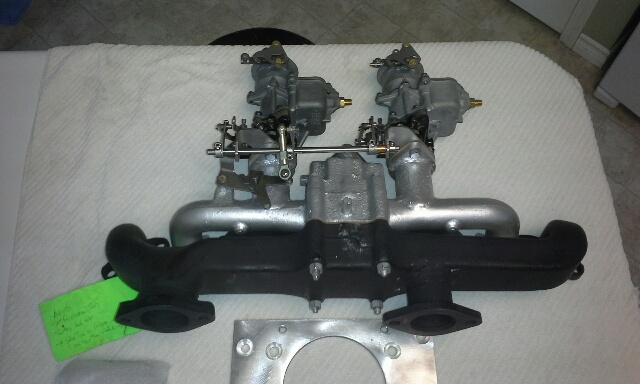

    Today my new George Asche/Kingsbury AoK Racing dual carb intake, tru split exhaust (not just a 2nd dump) , large bore/cfm truck Carter B&Bs linkages, arrived.
    This is going onto my 1955 Fargo 238 Chrysler flathead 6 engine.
    I plan to use this set-up on this engine, for the time being, and do have a high-perf 265 Mopar flattie in the planning stages.

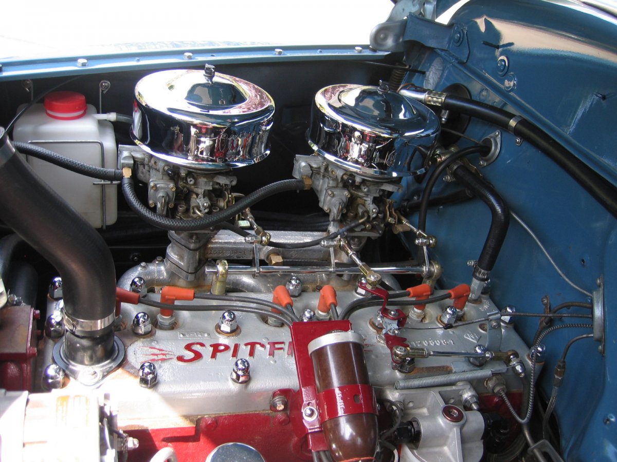

    '54 Chrysler 264ci, balanced and bored, Spitfire head cut .125 and cleared for valves, factory 2.5" Dodge truck intake& exhaust,Webber 2barrels, Heim joint custom linkage. 5spd. In my '47 Plymouth Deluxe. IMG_2949.JPG IMG_2937.JPG
    DOCWHIT, 504640, Truck64 and 11 others like this.

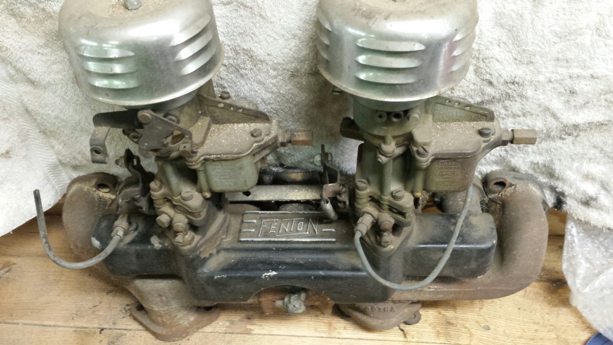

    I put this Fenton intake system together in the late seventies and ran it on my '40 coupe for many years. These flat head sixes look, run, and sound great with the dual intake and split exhaust! Fenton intake.jpg
    64Kaddy, burnzy37, mgtstumpy and 3 others like this.

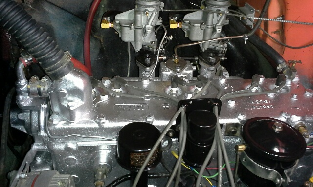

    Well a little progress, have a new gasket set for the manifolds.
    The manifold stud nuts back off easy, the good news, bad news is 2 studs are backing out, so have to drain antifreeze, no big deal.
    I had the manifolds off less than 2 years ago, so the bugger of a job was back then.
    I have a carter glass bowl filter, so will mount it with the fuel block, and it will be on the firewall far away from the exhaust...
    Hope to install the duals soon, tossing around whether I will repaint engine and paint up all the parts..

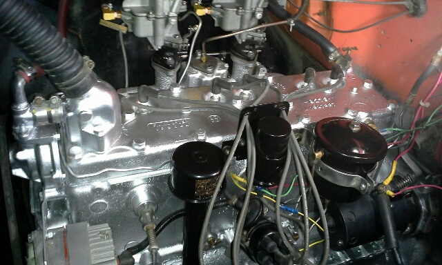

    Here is a video I made earlier today, did the install last week, still need air cleaners and a little more exhaust work.
    I built all the exhaust at home with what I had,
    Hollywood-East likes this.
  19. Flat Six Fix
    Joined: Feb 6, 2010
    Posts: 940
    Flat Six Fix

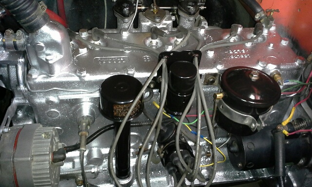

    Here spruced up the engine, waiting on air cleaners, but done for now, if that's possible.
    The engine is a little tired, but gonna build a 265, hotter cam and shaved head yada yada, and swap in at some point, that will liven up things.
    Big Swede, mgtstumpy and Johnnyr13 like this.

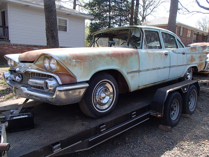

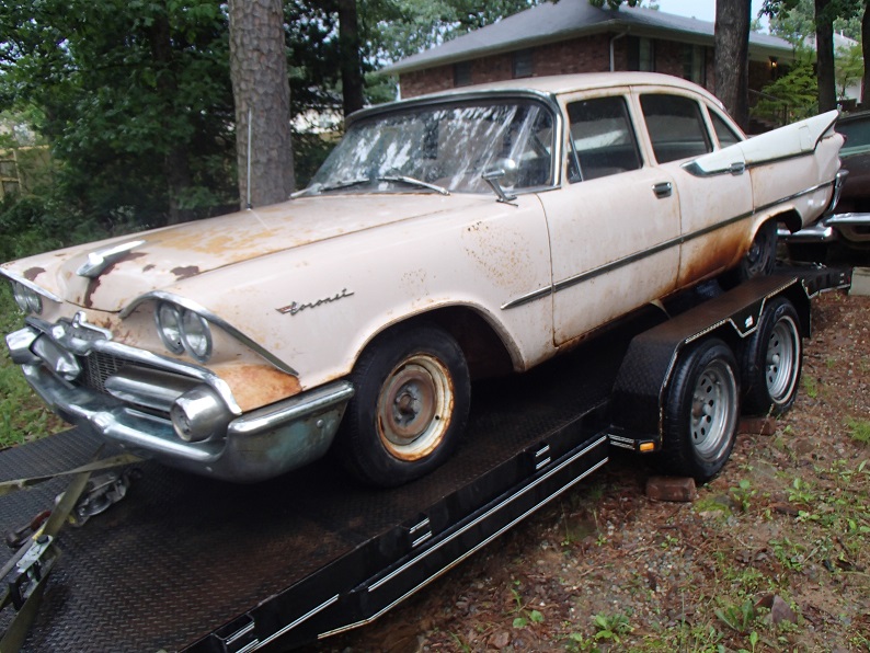

    What is the approximate cost to do a dual carb and exhaust for the 230??? Ya'll have me itching to do this to my green '59 Dodge Coronet 4dr sedan. I need to sell the tan colored '59 which also has a flathead in it.
