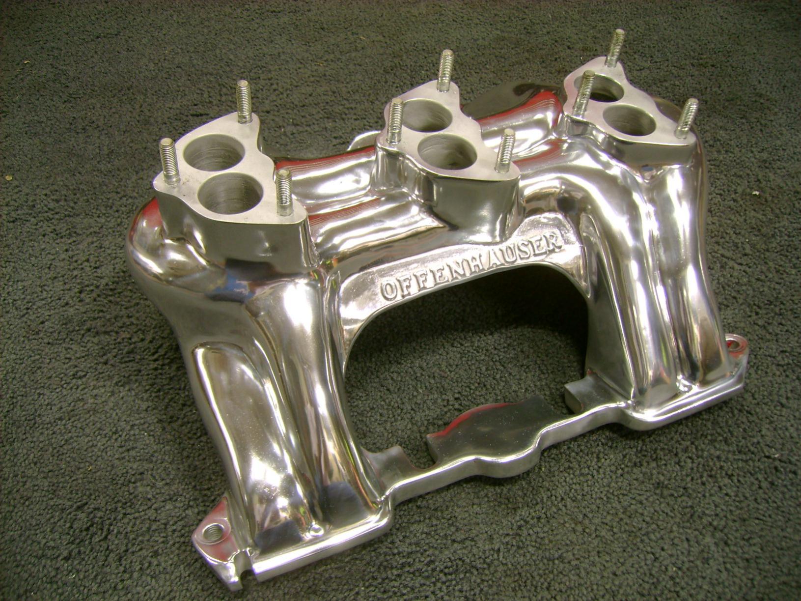

    The last Offenhauser 3X2 for the early Cadillac to go ebay this sunday.
    Sadly I will have to part with one of my all time favorite hot rod manifolds soon, but it was either this one or the injection set up so off to evilbay she goes to hopefully find someone with a hot rod that will use her as intended and not hang her on a wall.
    A good friend of mine worked for Offenhauser in the early 80's and this manifold was the last of the old Cadillac stuff sitting on the shelf when he left, 1981.
    Since then they have obviously been recasting the old lines but the 3X2 Cadillac manifold has never been reissued because according to him the pattern was lost long before he started there in the mid 70's.
