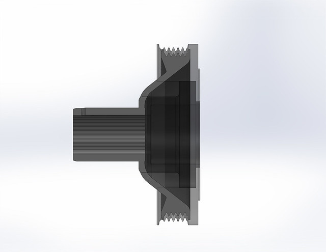

    The Scat crank was never considered as an option. To me it doesn't make sense to spend that much on a crank that still uses the Model A journal size.
    One thing I didn't mention, was a harmonic damper. possibly a Murray Horne unit. I talked to ATI Superdamper last year at SEMA. They have a 5.5" serpentine damper that I think will clear the front U-bolts. Since the hub bolts into the damper, it would just be a matter of building a hub to fit the A/B crank. They told me they had made flathead dampers. I would want to use a larger water pump pulley, to compensate for the larger diameter damper, which are available from the stock car guys.
    Here is my concept overlayed with a Clings pulley.
    [​IMG]Harmonic Balancer Assy by nomadpsd, on Flickr
    Jet96, burl and Old Dawg like this.
  6. johnneilson
    Joined: Apr 12, 2011
    Posts: 1,169
    johnneilson
    Phil,
    I know there is a lot of information about harmonic dampers on the web. Some swear by them, others not. There is a real potential here on these motors.
    I will caution you that there might be a snag in the application. Granted, the failures I have had are possibly not applicable to all, but, the drive key should be a source of attention.
    There is a reason the Small Chev V8 has more key and a press fit onto the crank. And yes, we shook the Mazda race ones off also above 9k revs (not press fit, solution was to make press fit).
    John
    Jet96, winduptoy and Old Dawg like this.
  7. Phil Damon
    Joined: May 8, 2020
    Posts: 13
    Phil Damon
    from San Diego
    Yes, the press fit was something I discussed with ATI and they said was needed. I also thought of adding a second key.
    Again, this is probably not really needed for my application. But, I like thinking outside the box.
    I would like to run some kind of damper. Because I think they are beneficial. And, I want to run a serpentine belt for better belt engagement on tiny alternator pulley. Which leaves me limited on options.

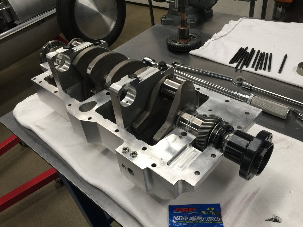

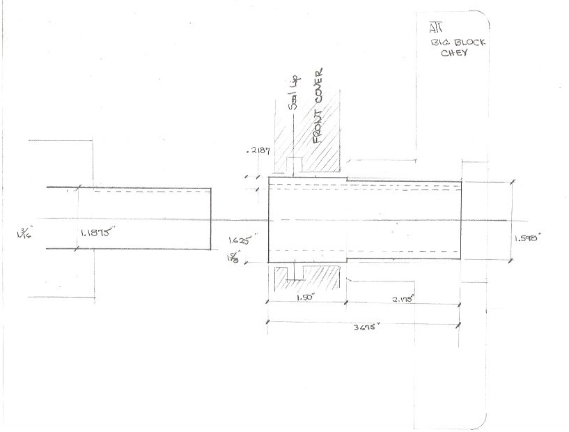

    I run a ATI SBC damper on my Bonneville B engine, I made a hub adapter with a full length 3/16" ket way with a press fit on the crank snout, it is a moldex crank, not that would make any difference. A crank snout damper will not be effective unless it is a press fit.

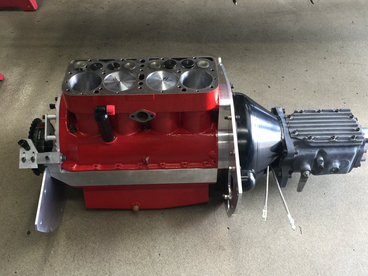

    1. Picture of Moldex Crank, girdle, cam supports, ATI Damper hub, and adaptor installed on crank.
    2. drawing of crank to hub adaptor with 3/16" keyway the full length of the adaptor welded to ATI Hub then ground to spec for press fit then keyway was cut.
    3. Assembly installed on engine.

    Hey Steve,
    THANKS for sharing.
    You do nice work.
    You running a FLATHEAD ?
    Picture is ‘ fuzzy’ , on my screen. Cant see intake valves....maybe because aint none. Got to change oil ... on this screen. lol
