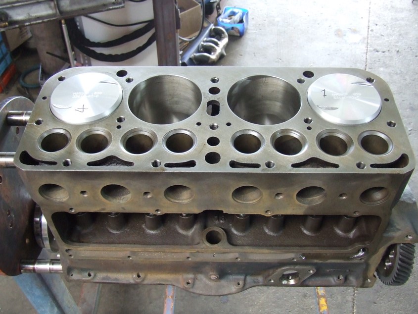

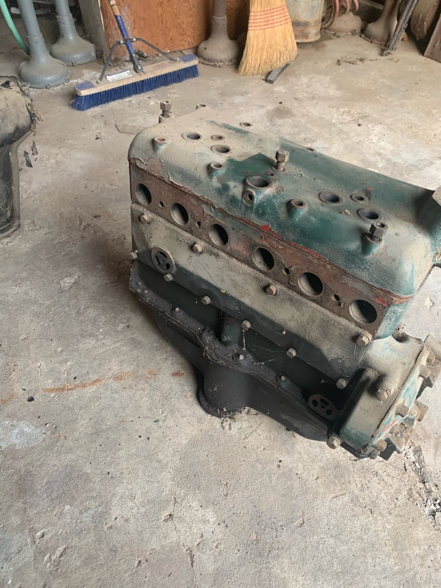

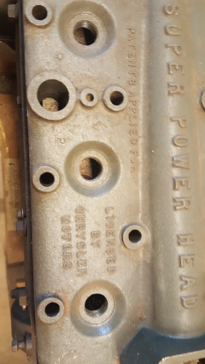

  5. Checking in! It's been a minute since I've built a banger but I'm back at it!
    Picking up this 5 bearing block later today, and should be getting a Simmons Super Power head soon.
    Does anyone know the advantages of a 5 bearing block opposed to a 3?

  7. Assuming a 5 cam bearing block?You can run a more radical cam. Well - slightly more radical...

    That would be cam bearing. Early block. Looks like maybe an early oil pan too. Still has three main bearings

    railcarmover

    If thats a ‘28 A blk, you are talking 5 CAM bearings...unless maybe a girdle with 5 MAIN bearings. OR, new Burtz blk with 5x5. Or D block 5x5.
    The 5 cam bearings in the ‘28 A blk, provide more cam support to lessen cam flex Under STRONGER valve springs, and/or at high revs.
    which CAN mean better running engine at higher speeds. You can also use 3 or 5 bearing cam, if wanted or out of necessity.
    A 5 bearing cam new can be pricy.
    Jet96 likes this.
  12. Retson,
    That would be a '28 block, 5 cam bearings. no girdle, 3 mains.
    There is quite a bit of documentation showing the progression of the blocks, the '28 has some strength issues at the rear main.
    Don't fret, it can still make a good running motor, and check the cam, it may be a good 5 bearing one.
    J

  15. Thanks everyone for great advice and knowledge.
    Currently debating pulling the cam and having it reground or putting something like a b cam in it.
    Got it sitting in my shed!

    pull the pan,post picture of the crankshaft..the lightest stock rotating group starts with the beaver tail crankshaft,which it should have if its a five bearing block.your camber is perfect for figure eight stock car racing btw..

  20. Will do! Believe or not, I did the dukes of hazard jump that’s why the wheels are all cambered out!

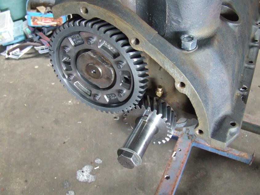

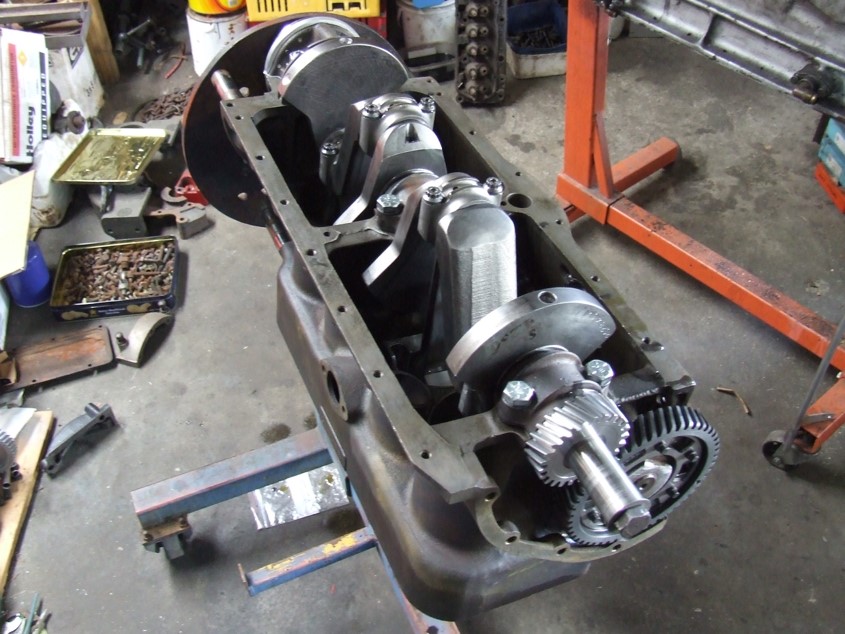

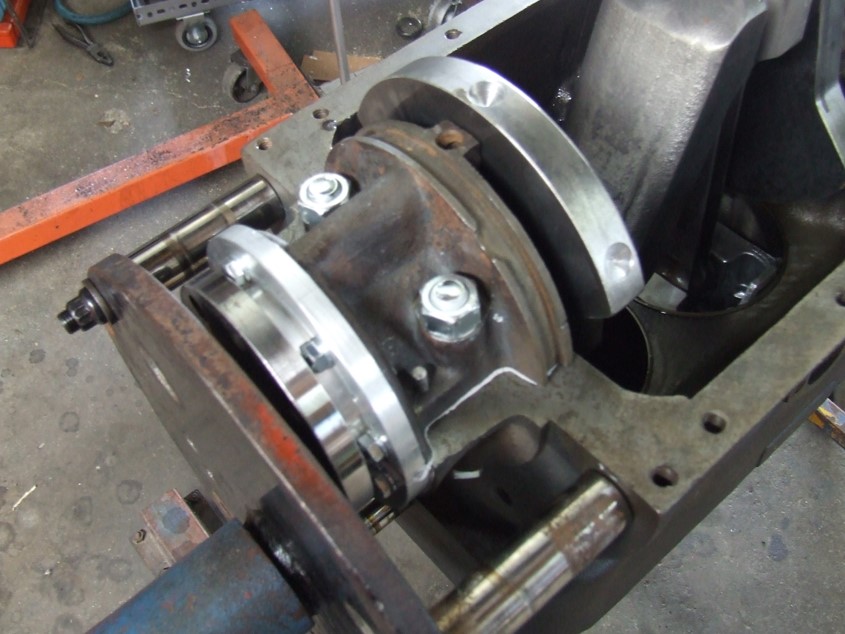

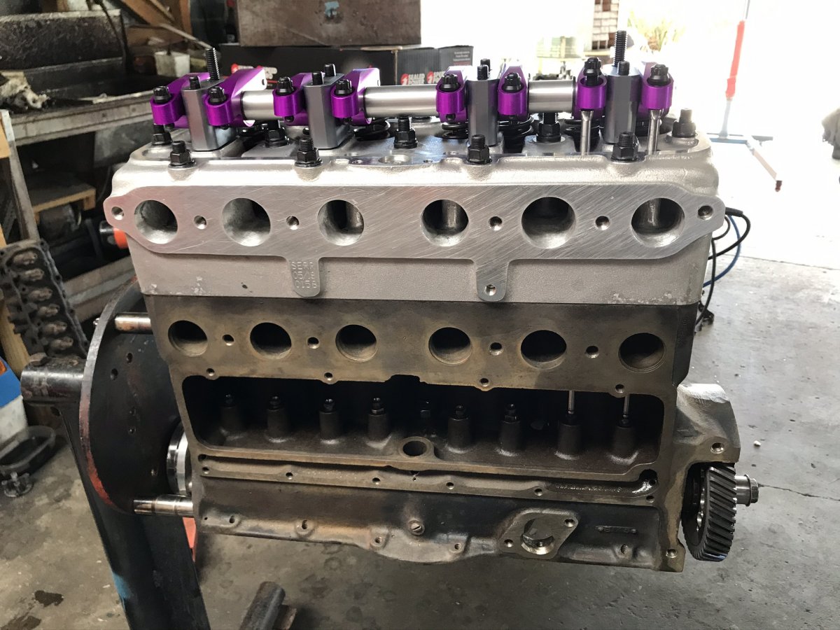

    Kiwi 4d
    At long last , since Xmas , all washed up and ready for some final assembly begins on our Miller OHV diamond B . E81FD530-042F-4B8A-B29F-63CE7739CA66.jpeg B1BA8566-12D1-4CB2-B279-0D107751995E.jpeg F6C6F708-6498-42BB-9B8B-5F1A8117D21B.jpeg 2415C868-FA09-4242-AA43-CE7BEAB32874.jpeg
