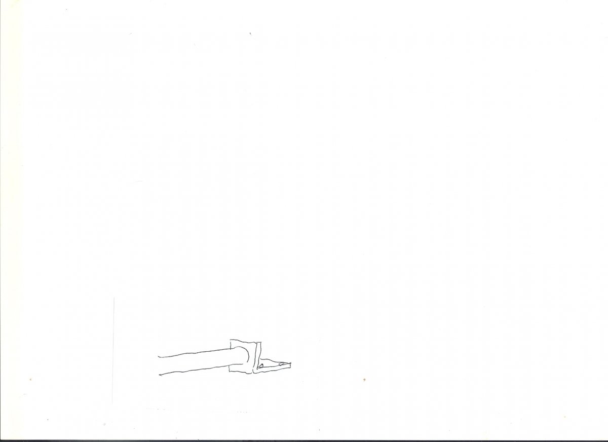

  19. ...you can use the round tube you have, just get 2 angles like so, and cut your tube to fit between em, bolt it to the frame flanges...see sketch below...

    Good call, at first I figured I'd go under the frame like chassis engineering for additional support, but you're right, cross members don't usually do that!
    The bottom plate would have to extend past the original side plates (front to back) in order to capture the flanges on the inside of the frame rail. So I'd actually cut the flange so the side plates can be flush with the bottom of the frame rail, and then could grab 4 bolt holes when I weld the lower plate to my cross member
    Sketched a picture below. The new iphone notes sketch feature is pretty awesome by the way!
    Black=frame rail
    Light green=current crossmember
    Dark green=new lower plate per your suggestion
    Blue=bolts
    The upper picture is the cross section of the frame and the bottom picture is a top view(despite the fact it should of actually been on the top lol)
    Let me know your thoughts!

    I have made many rear shock mounts for early Chebbys , by just using a triangular shaped plate bolted to flange . 2 bolts inside , one outside , with a tab welded on to use the same shock stud/bolt as you are using . Lower was a piece of angle , 4 holes for u bolts and one for center pin of spring , other side of angle trimmed to triangle shape , with shock stud /bolt for lower mount . You will notice when you get deeper into build than rear axle is not centered into fender opening . Using angle lower plate bracket will allow you to drill center pin hole 1 inch to rear to correct wheel spacing in the opening . Try to locate images of OEM , rear axle mount and you can see why installing a later axle changes wheel in fender opening . Remember these early springs where not designed to with stand the torque of a V8 they were just to support body weight and suspension , they had a torque tube to limit torque load on springs . I twisted up a few pairs of OEM 37 springs before I got wise to traction master style bars to stop spring wrap . Good Luck your doing great work and you will enjoy the 37 great classic body style even if it's a Chebby ! Just stirring the pot I owned one for many years and many fun miles

    Something like this? Arrow is pointing toward inside of frame. I kind of like that as long as I can get a short enough shock to accommodate. Stays out of the way of exhaust when I route it

    You got it ! Sorry not smart enough to draw on this thing ! But you got the idea , it works great

  25. ...I made mine like your last sketch, but like this...which allows for a longer shock....no crossmember from rail to rail, just these mounts
