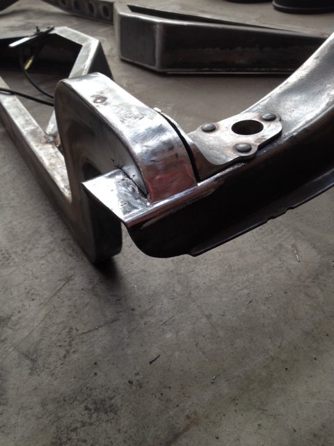

    Thanks mate! Unfortunately I'm grinding these off as I've pinched the frame and the centres will decrease for this style of engine mount.
  3. jugheadjones
    Joined: Jun 6, 2011
    Posts: 182
    jugheadjones

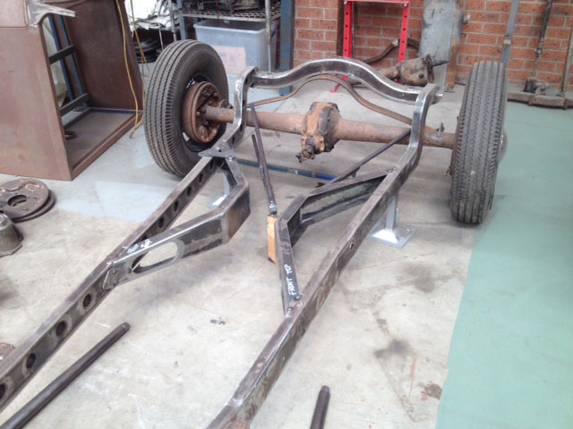

    I had to re do the engine mounts as I pinched the frame. Here's the new ones mocked up.

    I finished welding the rear crossmember while I was at it.

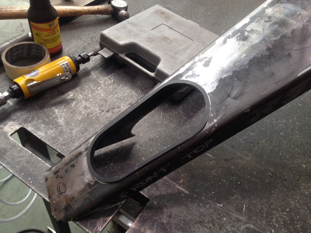

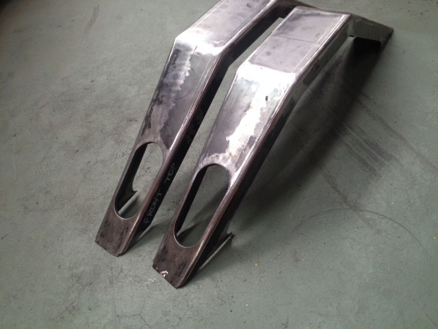

  5. OFT
    Joined: Jun 1, 2005
    Posts: 574
    OFT
    Looking very good!!
    The "speed holes" on boxing plates are neat. I've only added access holes in past, really like the looks of your frame!
    Earl

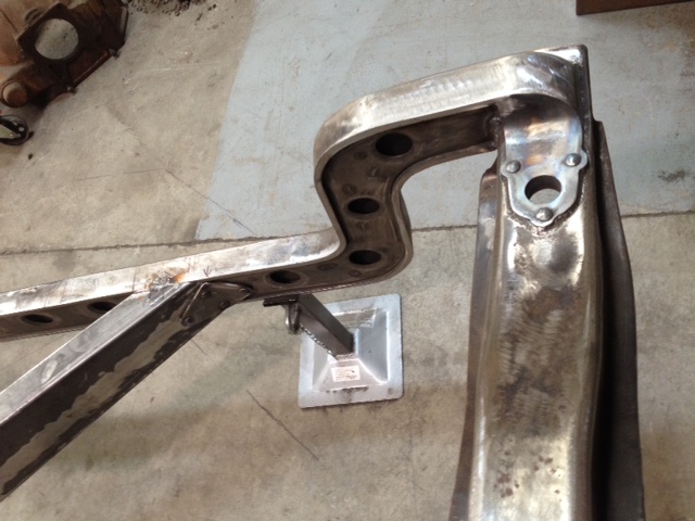

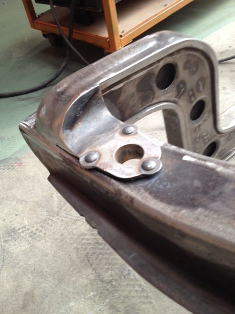

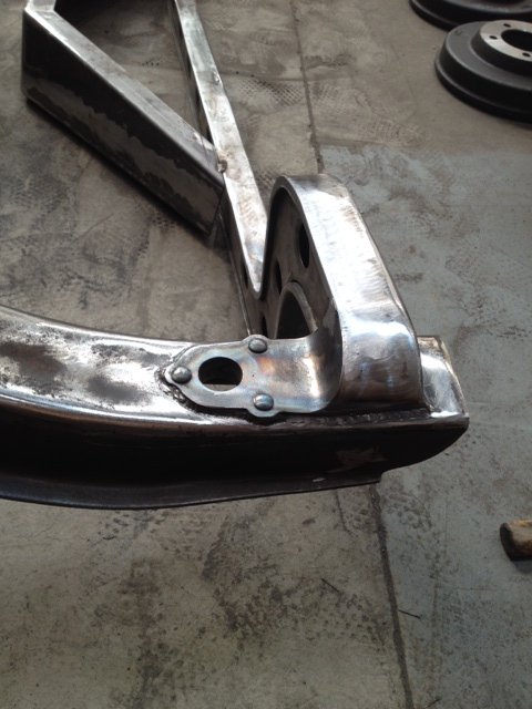

  7. It looks great, many small things that will have a profound impact on the finished product. Hats off to you sir,
  8. jugheadjones
    Joined: Jun 6, 2011
    Posts: 182
    jugheadjones

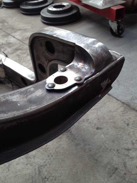

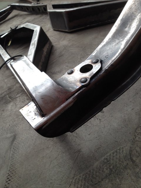

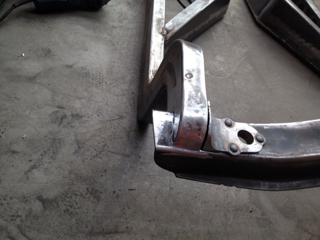

    Making faux mounting brackets for the K member I fabbed up.
    image_1.jpeg image_7.jpeg image_15.jpeg image_14.jpeg image_13.jpeg image_12.jpeg image_4.jpeg image_2.jpeg image_10.jpeg image_5.jpeg image_4.jpeg
    AHotRod likes this.

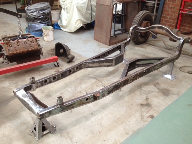

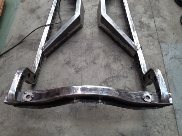

  12. jugheadjones
    Joined: Jun 6, 2011
    Posts: 182
    jugheadjones

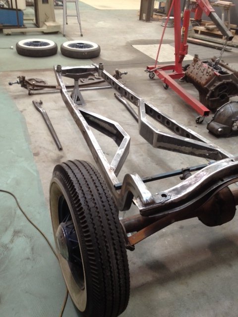

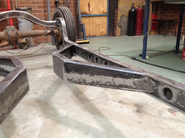

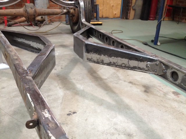

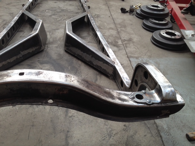

    Front crossmember welded up
    AHotRod likes this.

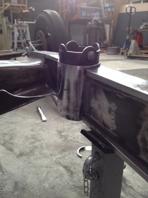

  15. jugheadjones
    Joined: Jun 6, 2011
    Posts: 182
    jugheadjones
    Thank you very much guys!
  16. jugheadjones
    Joined: Jun 6, 2011
    Posts: 182
    jugheadjones
    I'm doing a Doane Spencer or Rolling Bones [ google these ] style front end if that's what you mean?

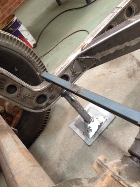

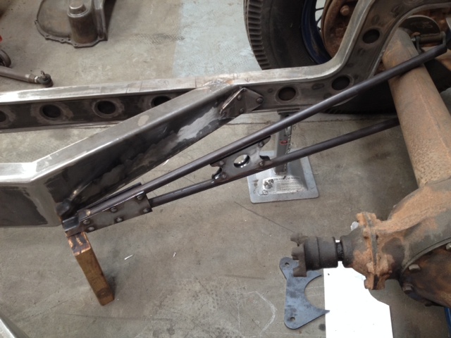

    Ladder bar R & D / mocking up before fab time.

  18. Great work, can't wait to see more

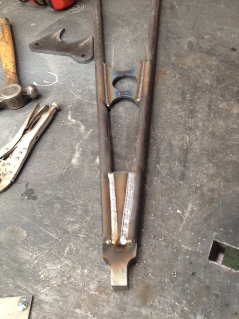

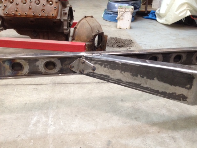

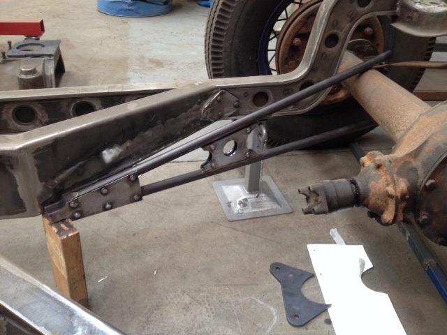

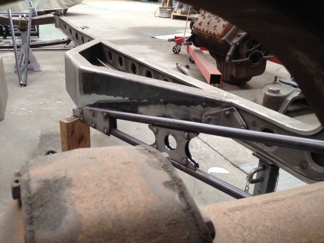

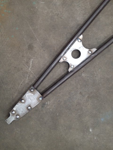

  22. jugheadjones
    Joined: Jun 6, 2011
    Posts: 182
    jugheadjones

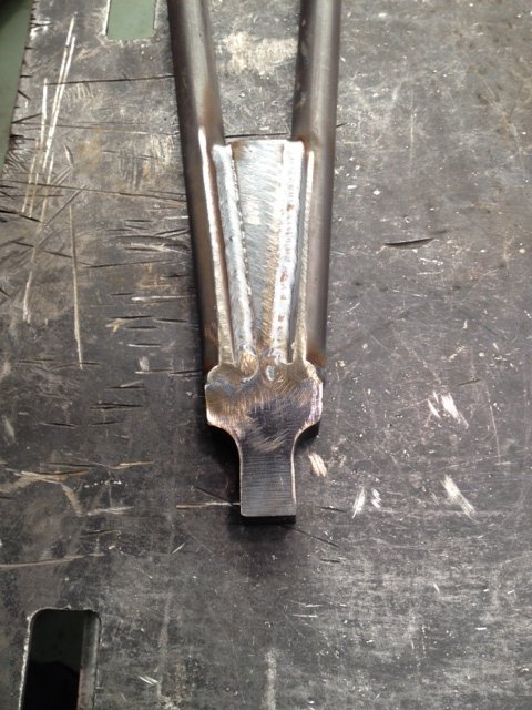

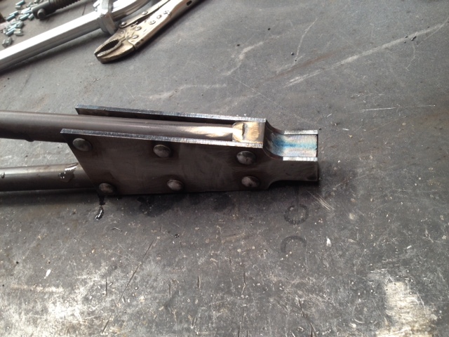

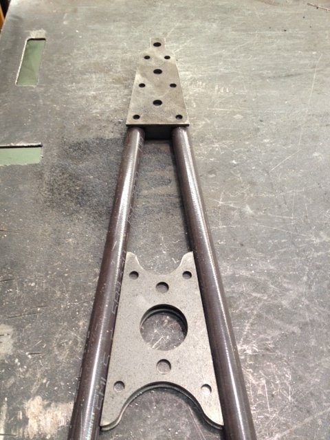

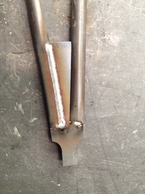

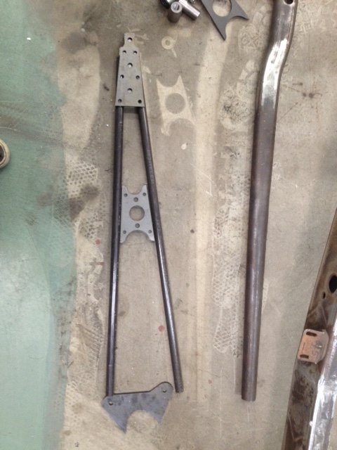

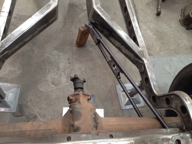

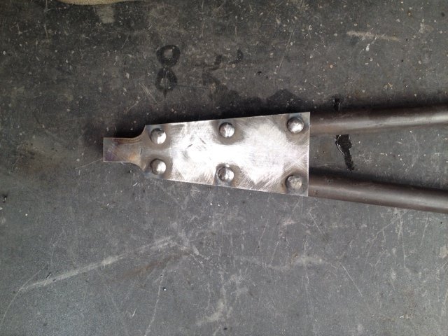

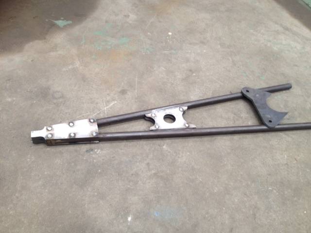

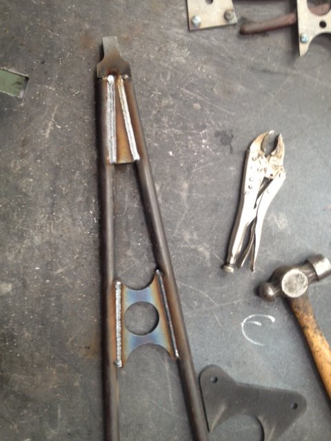

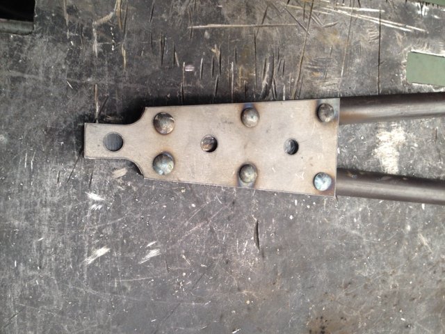

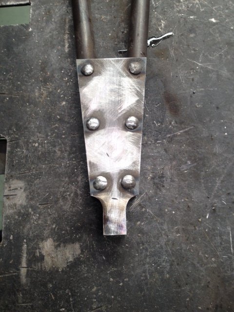

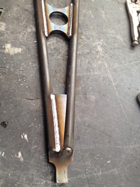

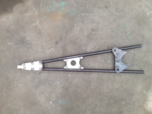

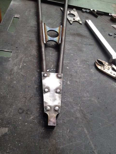

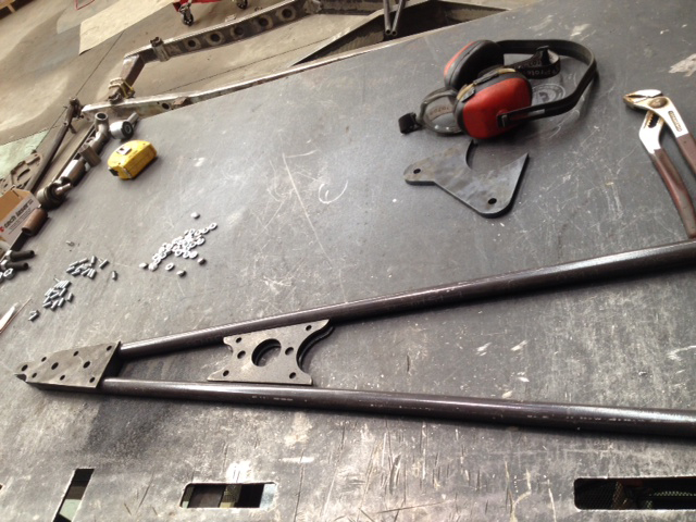

    Fabricating ladder bars today. I wanted something that looked era correct... Hopefully that's achieved image_2.jpg image_3.jpeg image_4.jpeg image_5.jpeg image_6.jpeg image_7.jpeg image_8.jpeg image_9.jpeg image_10.jpeg image_11.jpeg image_12.jpeg image_13.jpeg !
  23. jugheadjones
    Joined: Jun 6, 2011
    Posts: 182
    jugheadjones
    A few more pics
    image_13.jpeg image_14.jpeg image_17.jpeg image_19.jpeg image_20.jpeg image_21.jpeg image_23.jpeg image_24.jpeg image_25.jpeg image_27.jpeg

  24. jugheadjones
    Joined: Jun 6, 2011
    Posts: 182
    jugheadjones

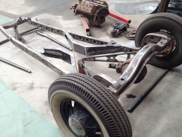

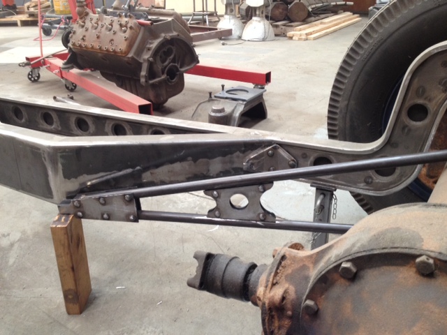

    One down, one to go. Weld the mounting brackets on the dif, fabricate the front ladder bar incorporating gearbox mount and she's back rolling!

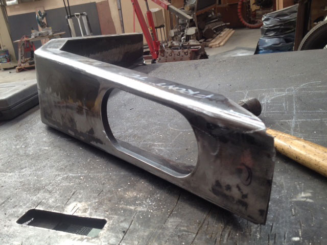

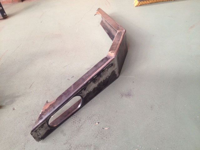

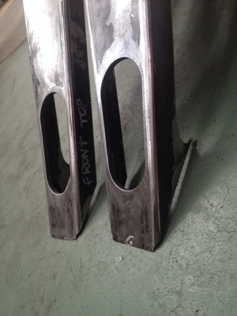

  25. jugheadjones
    Joined: Jun 6, 2011
    Posts: 182

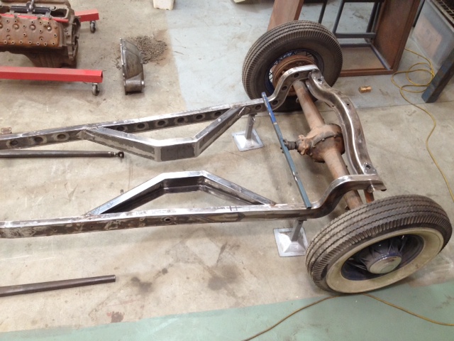

    jugheadjones

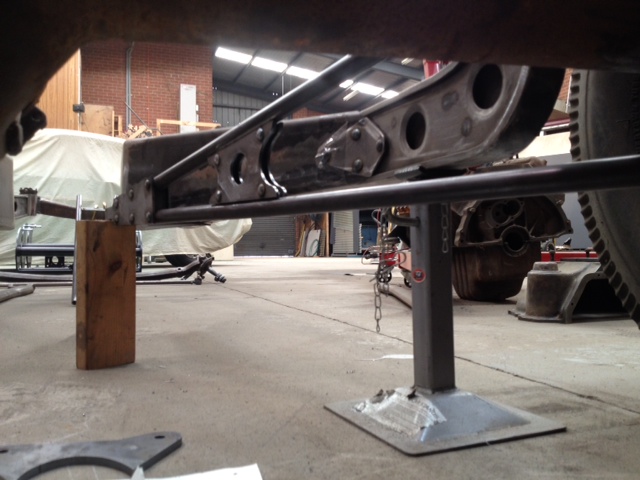

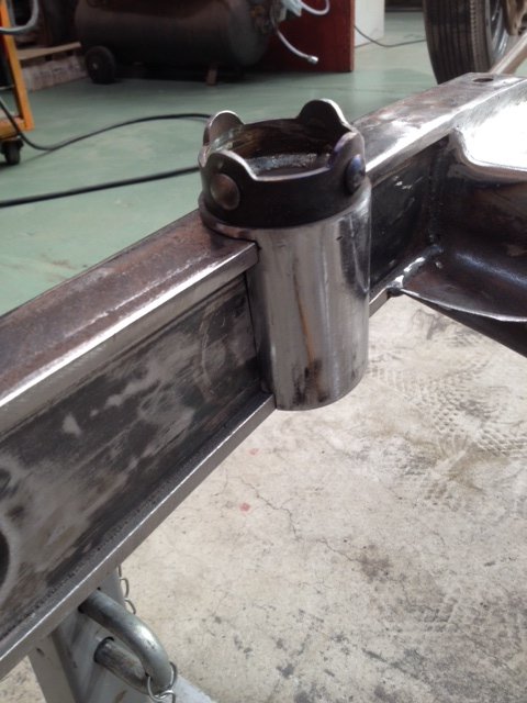

    Finished off the gearbox crossmember today. I'm not sure where I'll run the exhaust but I've allowed for them to run through the crossmember if need be. image.jpg image_13.jpg image_12.jpg image_11.jpg image_10.jpg image_9.jpg image_8.jpg image_6.jpg image_5.jpg

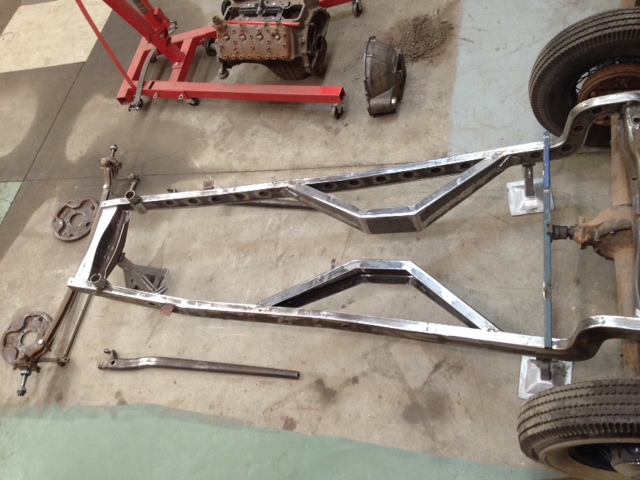

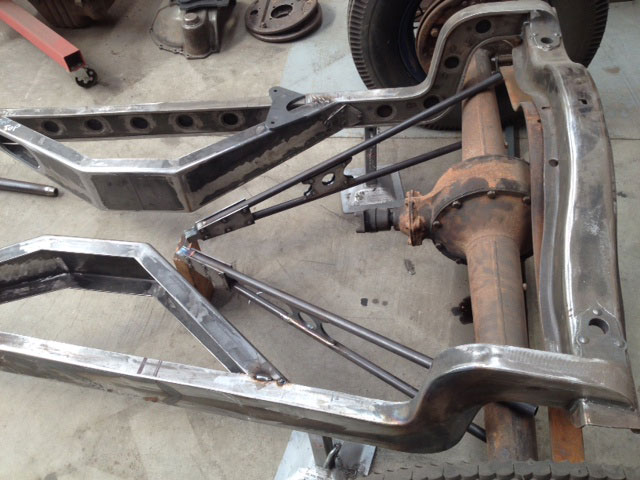

  26. jugheadjones
    Joined: Jun 6, 2011
    Posts: 182
    jugheadjones

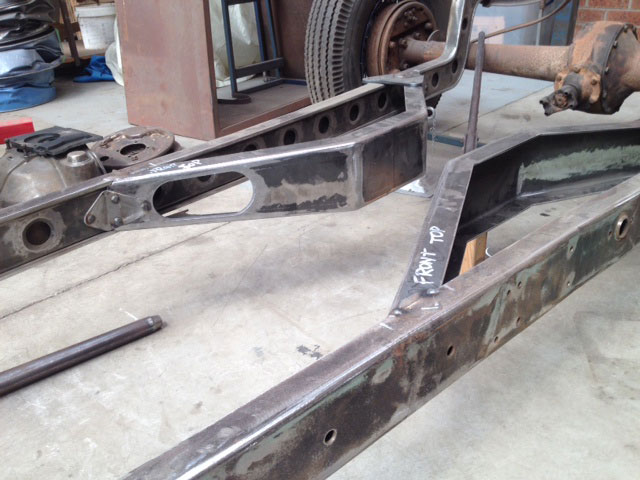

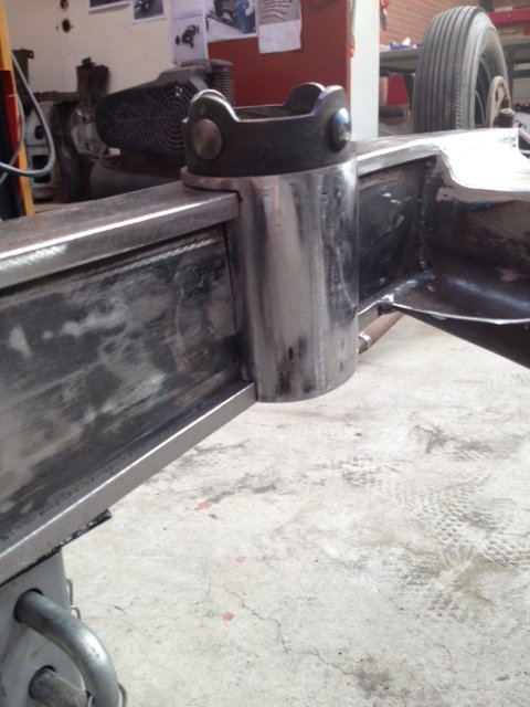

    I also made the second ladder bar and mocked them up in the chassis to size up the mounting plate that will support the gearbox and secure the ladder bar pivot points image_24.jpg image_23.jpg image_22.jpg image_21.jpg View attachment 2725224 image_19.jpg image_17.jpg image_16.jpg points
    AHotRod likes this.
  27. jugheadjones
    Joined: Jun 6, 2011
    Posts: 182
    jugheadjones
    Above chassis shot

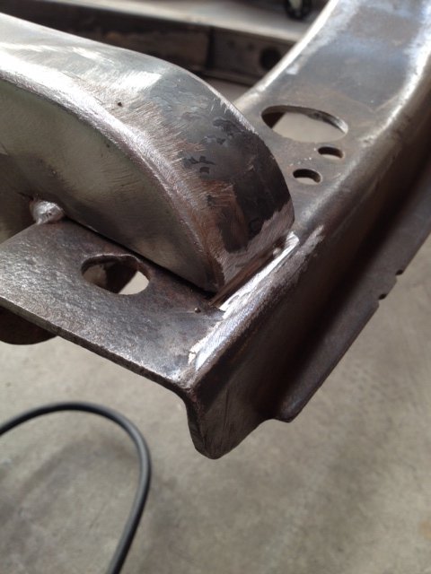

    woa. super nice. im envious of your welder settings, they are perfect.
