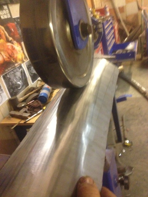

    I'll do a rust repair post for once. Hope this does'nt bore you too much.
    I was hoping to repair the old running boards, but they turned out to be too rusted out, so I decided to make new ones.
    <a href="http://www.flickr.com/photos/101906403@N07/11045297695/" title="zeph 4505 by matsheinrich, on Flickr">[​IMG]</a>
    Since I'm building a custom car, I didnt make them 100% like the originals. I did the outer shape, but I was going to mold them to the car anyway, so I didnt bother to make the inner profiles which I would have done if it was an original restoration. I made the basic shape out of round bar to give it some strength and give a good reference to hammer out the sheet metal.
    <a href="http://www.flickr.com/photos/101906403@N07/11045417184/" title="zeph 4506 by matsheinrich, on Flickr">[​IMG]</a>
    The shape of the pieces are pretty compicated, due to them following the outline of the car, rather than on a ford or mercury, on which they are pretty much straight from fender to fender. The round profile is pretty much the same all the way though, so I fabbed a simple tool to make the braces identical.
    <a href="http://www.flickr.com/photos/101906403@N07/11045415164/" title="zeph 4507 by matsheinrich, on Flickr">[​IMG]</a>
    <a href="http://www.flickr.com/photos/101906403@N07/11045290715/" title="zeph 4508 by matsheinrich, on Flickr">[​IMG]</a>
    <a href="http://www.flickr.com/photos/101906403@N07/11045258205/" title="zeph 4523 by matsheinrich, on Flickr">[​IMG]</a>
    I put one of these bends every 10", and it was pretty straight forward to measure the rusted out panels to cut them to the right lenght.
    <a href="http://www.flickr.com/photos/101906403@N07/11045375776/" title="zeph 4509 by matsheinrich, on Flickr">[​IMG]</a>
    Now that the frame was done, its just a matter of hammering and rolling out the panels. I made them out of four pieces, due to the shapes mentioned earlier.
