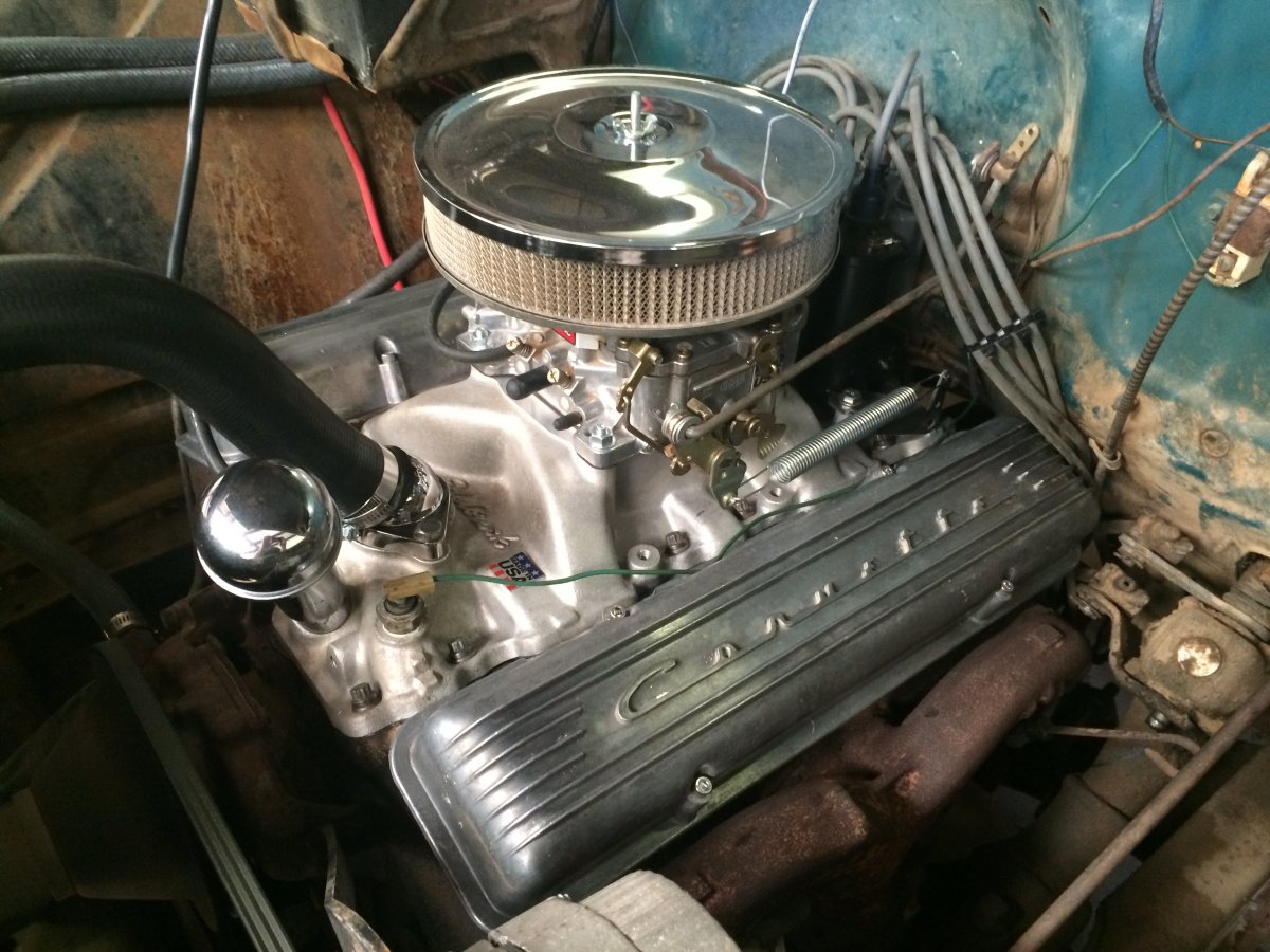

    RPM2.JPG Edelbrock has what you want, #2703 Performer EPS with fill tube. I just put a fill tube in the Performer RPM pictured using a 1 1/8" hole saw (that cut oversize) and took it to 1 1/4" with an adjustable reamer. I have M/T valve covers that I don't want to put holes in and my 327 has the PCV valve coming from the road draft tube hole in the back of the block.
    Gary
