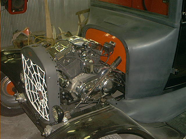

    Here's one that a friend built with A Harley Davidson drive train. I'd like to have a T coupe body to use as a yard ornament.

    Would you put flames on it??? haha
