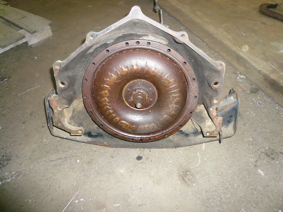

    hydros??...came across these today...
    $$13007204_10154144001627140_2352709304010322784_n.jpg $$13001119_10154144004677140_7582223064056631948_n.jpg $$12472714_10154144017362140_4554217145909678765_n.jpg
