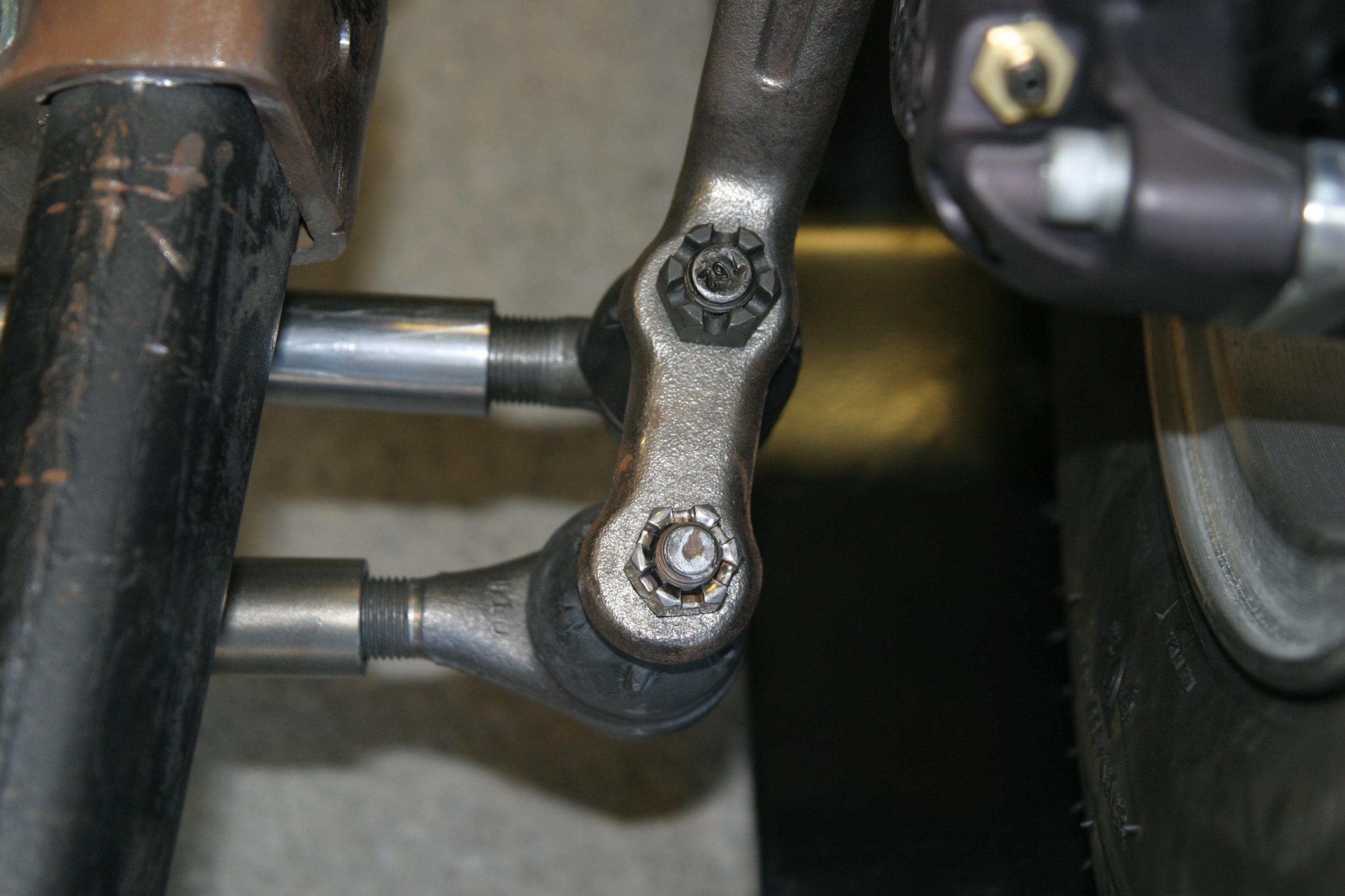

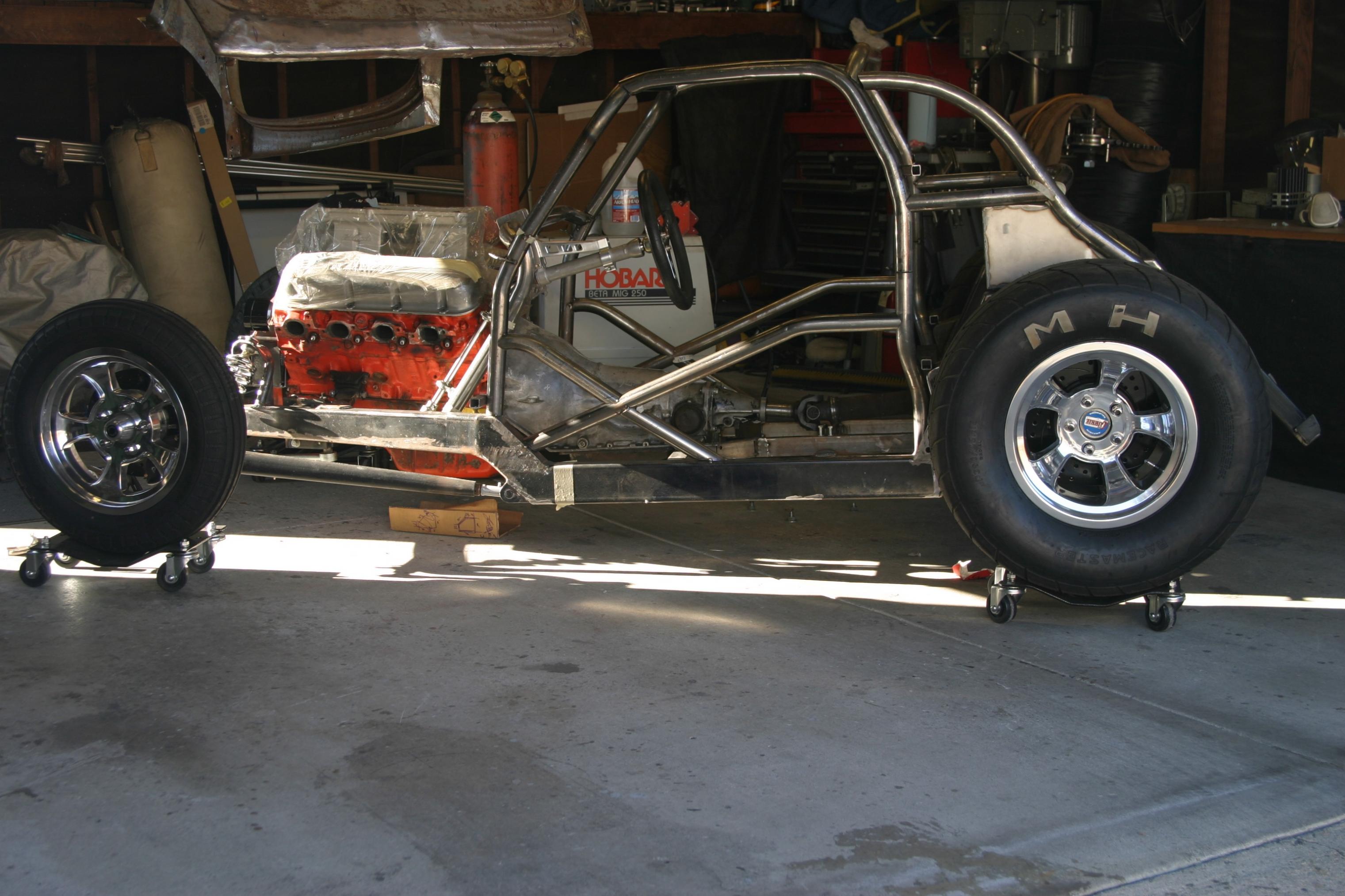

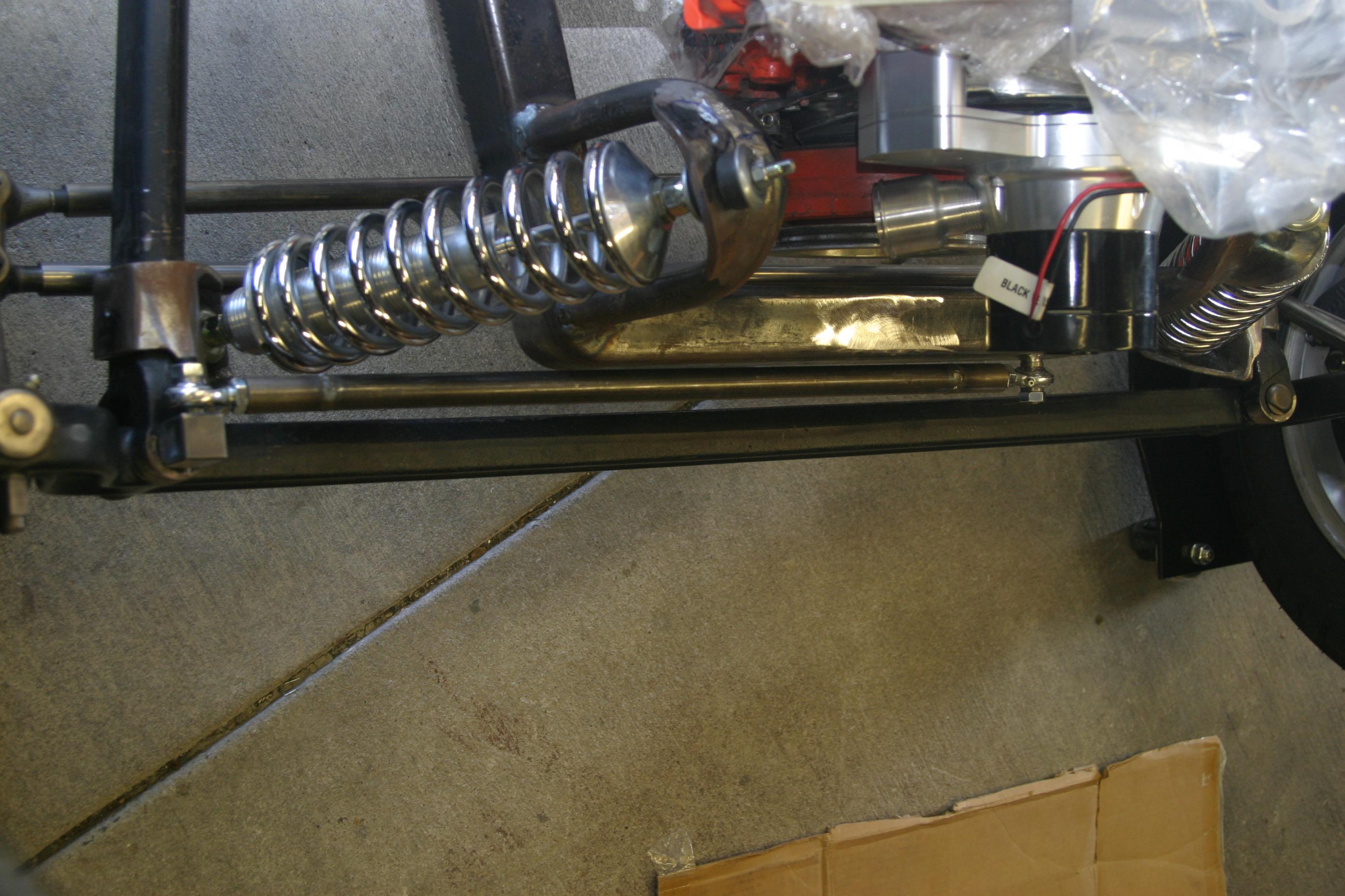

    I also build new steering bars with new ball joints (still have to machine lock nuts for the ball joint threads). I used the same .093 wall tubing and machined, threaded, and welded in the same end plugs as I used on the pan hard rod ends.
    The pics show a view across the front end with the axle, pan hard rod, steering bars, and frame, as well as the pass side steering bars, and drives side steering ball joint.

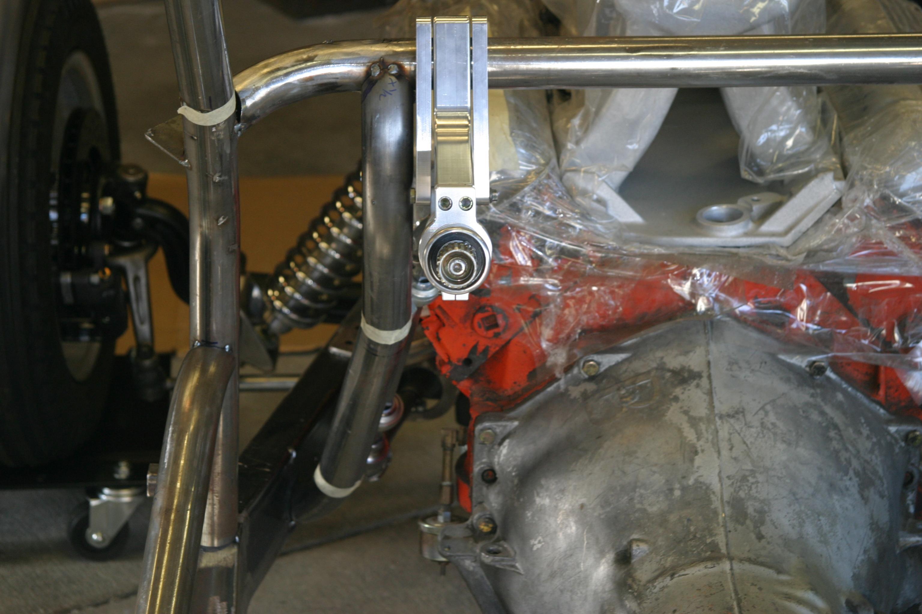

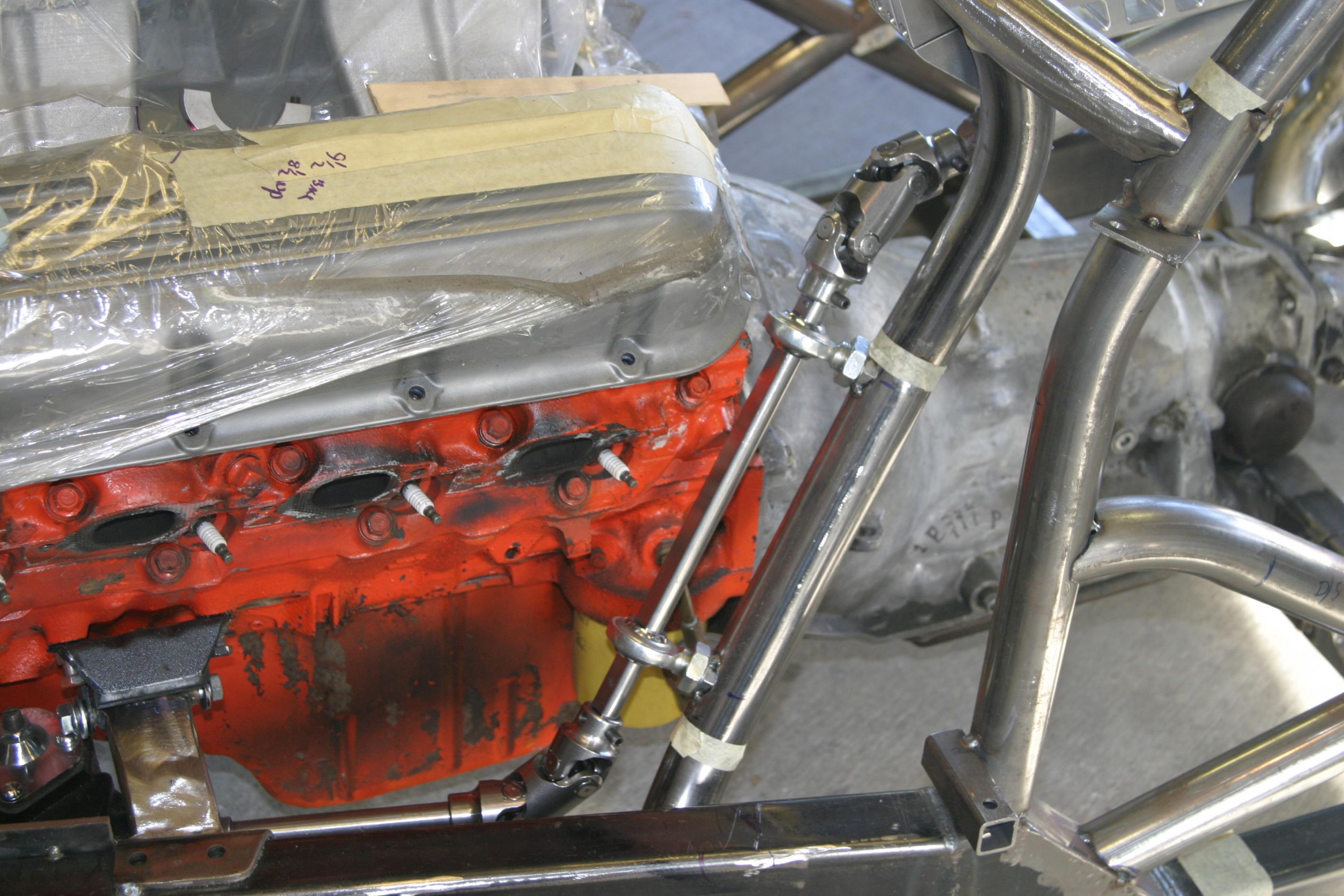

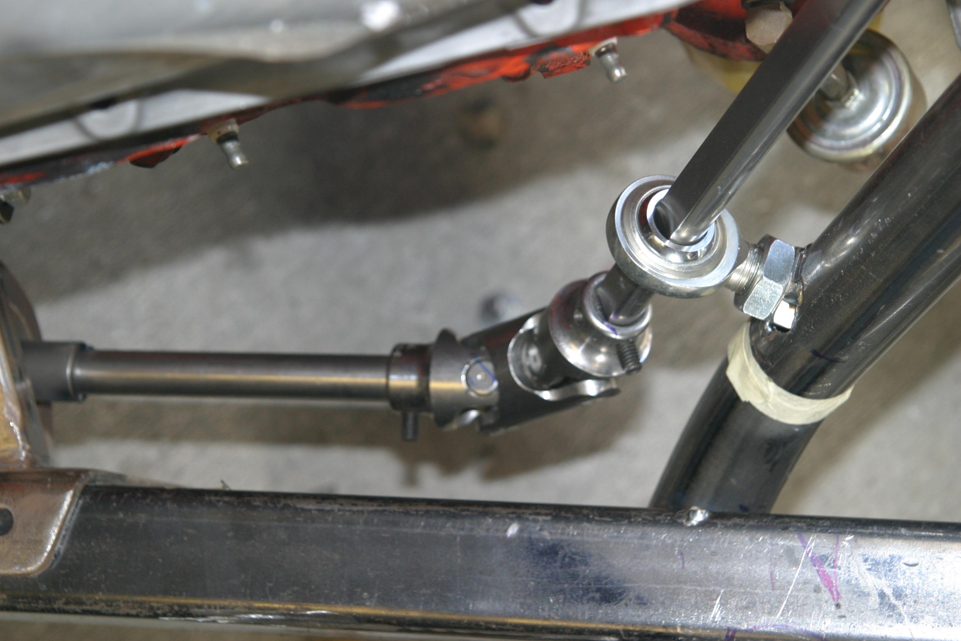

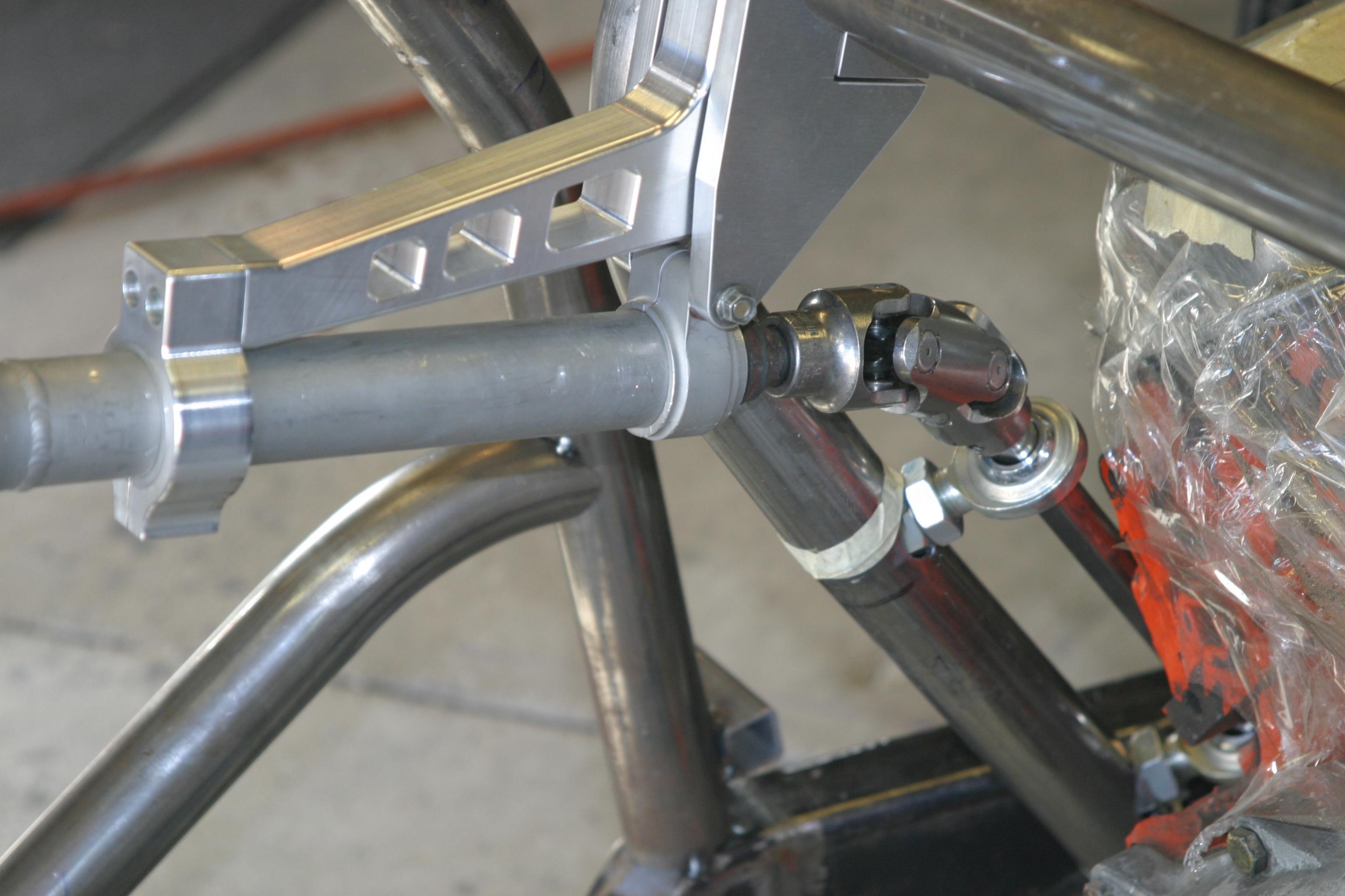

    to get the steering linkage correct I had to go with 2 double u-joints.... 10 pounds of parts in a 1.7# bag you have to adapt.
    this is the 3rd configuration, the first one gave me an idea of how it had to bend, the second was working so perfectly and then I decided to set the brake booster in place (I already knew the header would clear). With the brake lever in place I could then see the most efficient way to build the support down tube, hence the third go round
    I drilled large holes and inset the rod ends second nut (currently tacked in place) the only part not shown (because its not installed) is the rod end that supports the steering bar that rides along the frame rail, I have to install it when the engine is out.
    the second pic is a down view of the bottom double u joint and the steering bar that will get another rod end supporting it, although it works so smooth as it is.
    the third pic is from the drivers seat with the wheel removed.
    the 4th pic from the pass seat looking across at the steering column.

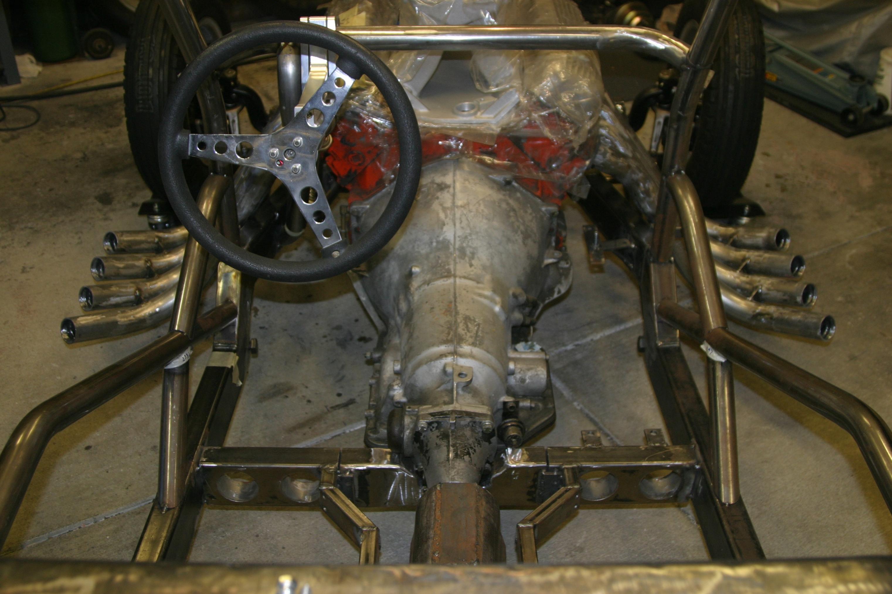

    baffles..... I finally put the baffles in the ends of the pipes, sanded the pipes, and finished the support braces for the drivers side.
    Those baffles are an f ing nightmare to get in.... I built my pipes with a slightly thicker wall than what they are made for and since they are not welded from the manufacturer true and straight I couldn't machine them down a bit... sooooo I had to..... if anyone is planning on installing a set of these baffles in the future let me know and I'll give you all the little tricks I had to figure out to make a "simple" install.
    Here's a few pics of the pipes..... mounted fyi the engine is offset 1" to the passenger side, and, the drivers side bank of cylinders is 3 1/2 " farther forward than the pasenger side cylinders. The end of the pipes are in the exact same place on both sides. (in these pics the pipes look out of alignment, I assure you they are NOT)

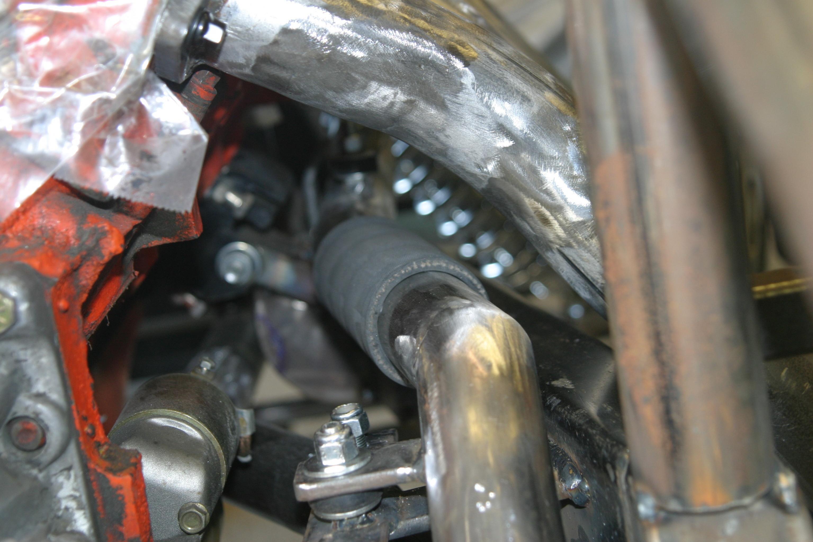

    Radiator pipes... here you go
    1st pic shows all the pipes for the system laid out
    2nd pic shows the lower tube running from the electric water pump back to the radiator (engine hot water), also shows the tube running from the radiator to the manifold along the frame (radiator cool water) you'll also notice the large hole in the front of the manifold... I put that there and am machining a fitting that will be welded in the hole and 90 degree turn and tip down a few degrees to hose connect to the radiator cool tube. The stock water inlet will be used for a radiator cap component.
    3rd pic shows radiator cool line running above and along frame rail and its rubber mounted mount that comes off the motor mount. The engine hot tube is below and behind it.
    4th pic shows the rubber mount system
    and yes... things are almost as close as they look in the pics... almost

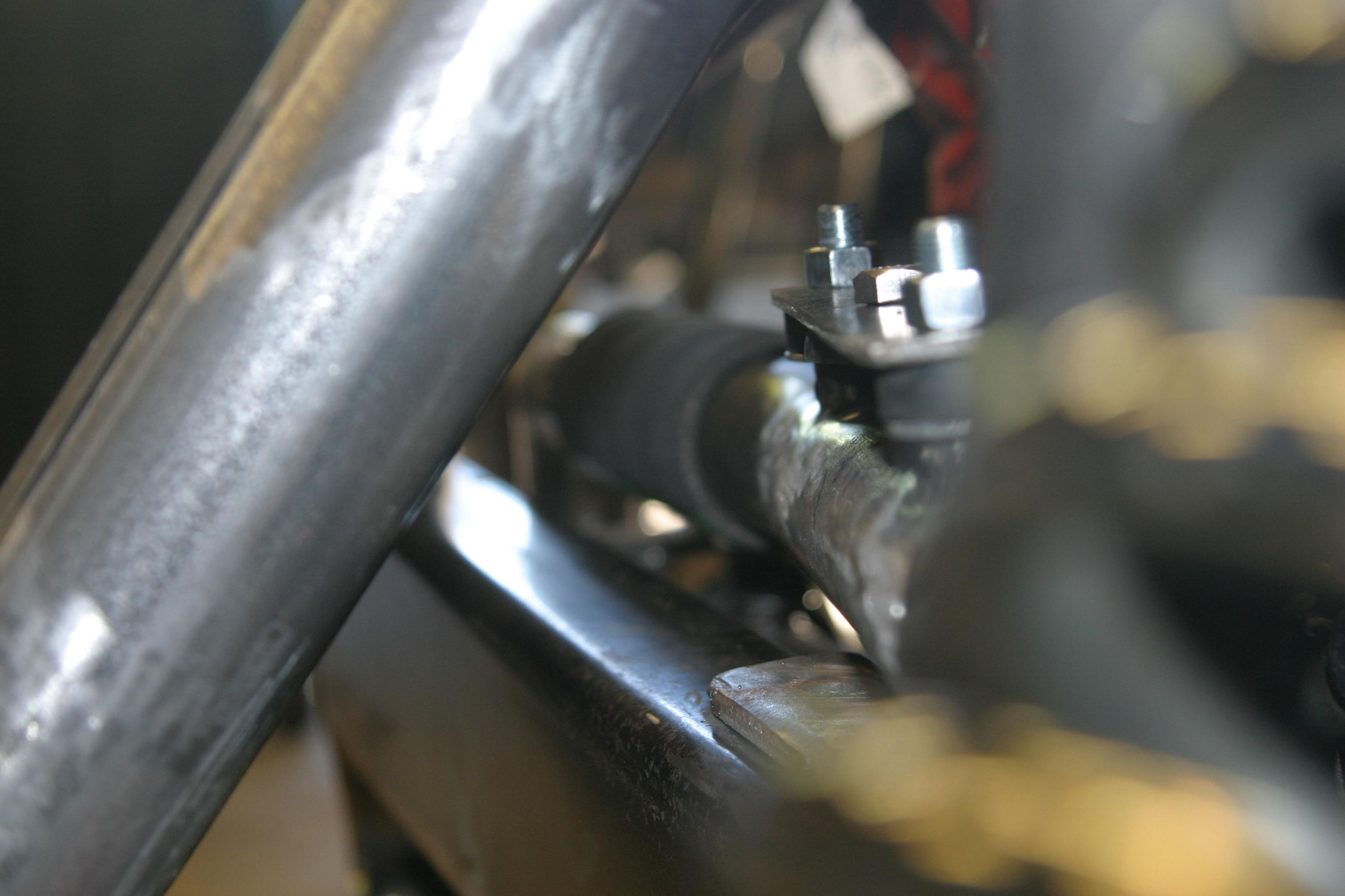

  20. Zoomer
    Joined: May 15, 2009
    Posts: 222
    Zoomer
    more radiator pipes
    still have to finish cleaning some welds up as well as rounding mount tab corners
    1st pic shows where the two pipes share the same mount off the frame at the firewall, they drop down behind the firewall as the firewall drops at an angle and becomes the floor. the forward lengths of both these pipes will be heat wrapped since they travel between the engine and the header.
    2nd pic shows pipes dropping down at about a 45 degree and then separating to travel thru the frame / trans x member
    3rd pic shows the pipes running back to the rear x support and thru, also check out the large cover plate I welded up to cover the front u joint.... still waiting for new driveshaft to get in... hoping to pull car apart next week and finally weld everything complete. the center section of the trans member is now removable and the two side pods are welded to the frame and have tabs extending out that bolts run thru and thru the trans mount center section, the drive shaft loop support tubes (with the Z action) are going to be replaced with roll cage tubing bent to mimick the radiator pipes.
    4th pic shows the radiator pipes going thru the rear frame cross section up and over the rear end and then up to the hot inlet and down to the cool outlet
