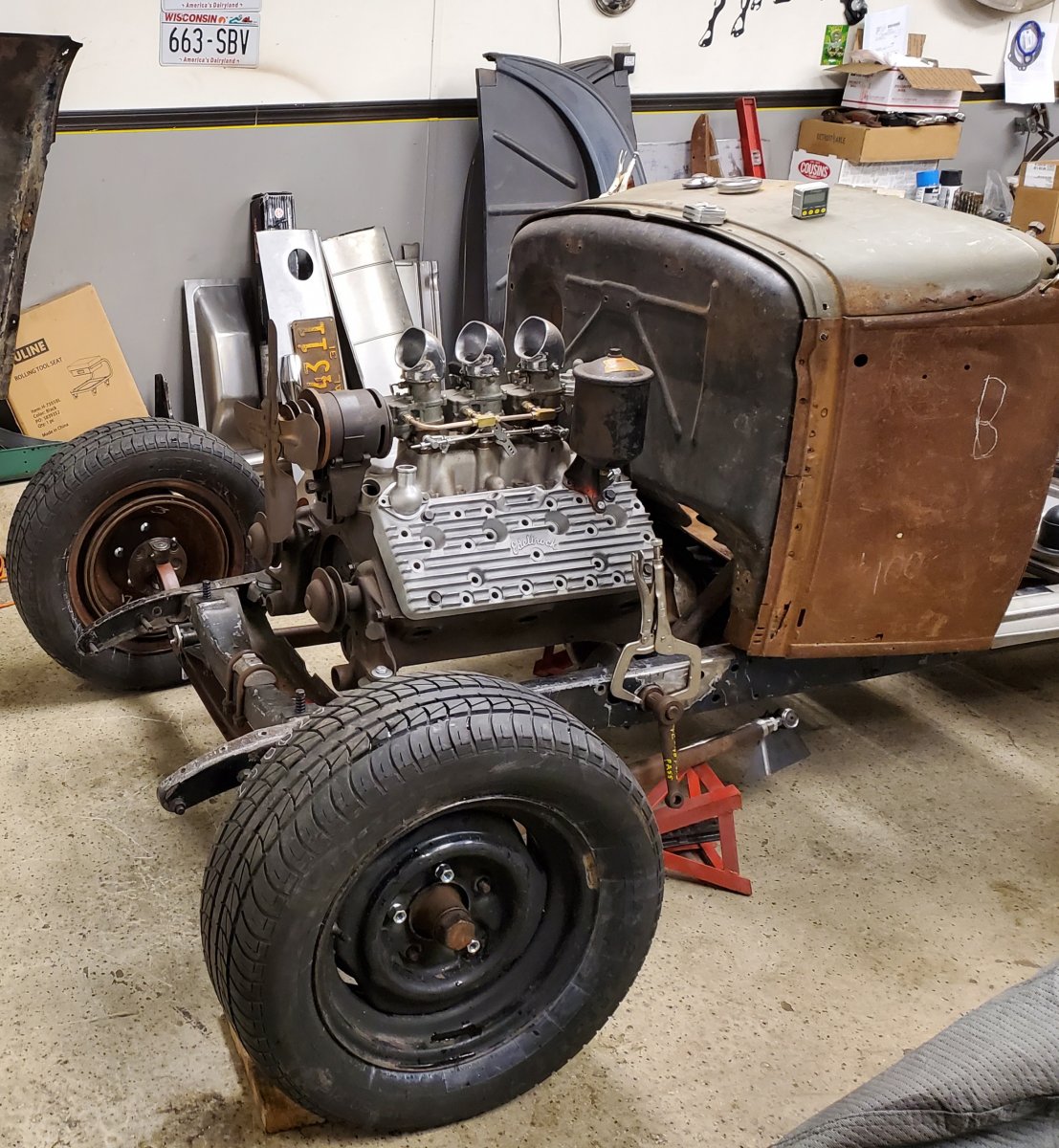

    20201114_193910.jpg 20201114_193910.jpg 20201114_183211.jpg I have not posted in a while too busy in the garage. 1931 roadster all steel with fenders. Going a little different than most. 3" kickup in the rear frame and a 4" drop axle up front. 8BA flathead with 3 Strombergs. Just tacked up some lake headers. Barely fit the cowl and fender but it does. The other side has the F1 steering box. That one will be a challenge.

    The look of full fenders, lowered is always impressive. Enjoy.

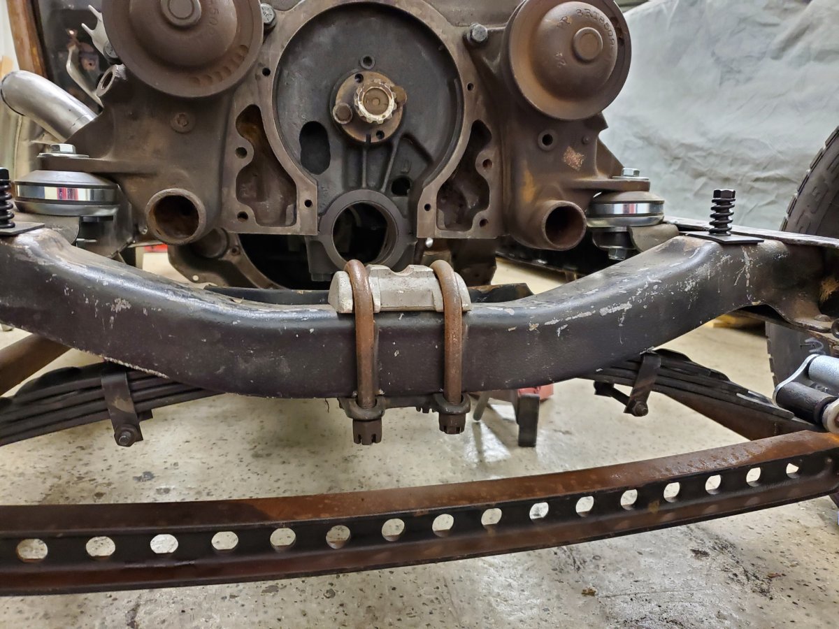

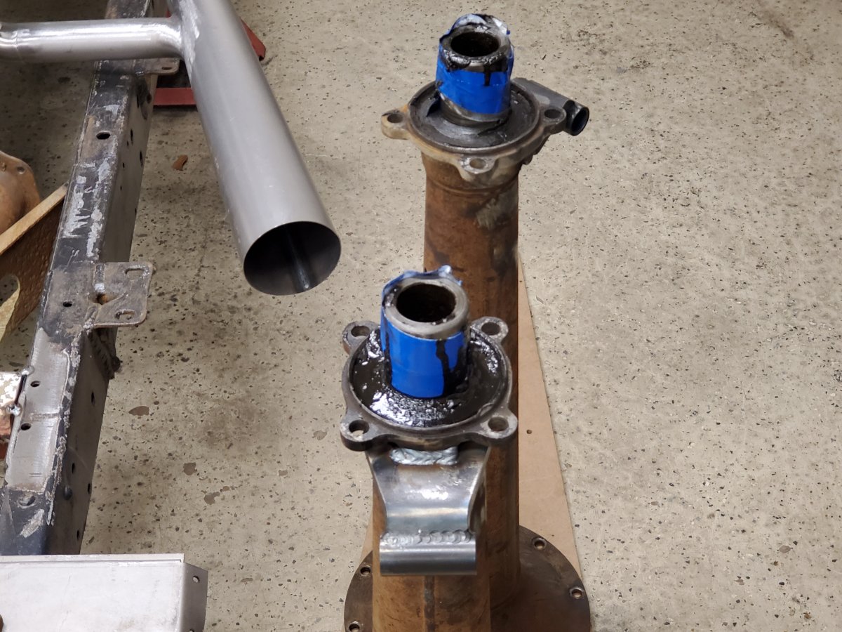

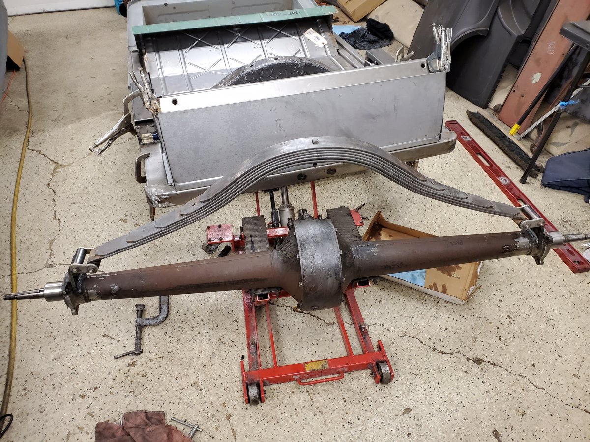

    20201221_150445.jpg 20201221_155449.jpg 20201222_130626.jpg Banjo all cleaned inside and inspected for wear. None! Clean leaves of rust and apply anti seize compound. Mount model a spring with main leaf first and C clamped the rest. Always kept a treaded rod engaged in the center hole just in case. Ended up going from 7 leaves to 4 for a lowered look as well as a softer ride. We will see....at least the shackles ended up at a 45 degree like they are supposed to. View attachment 4917493 View attachment 4917493 20201222_130700.jpg

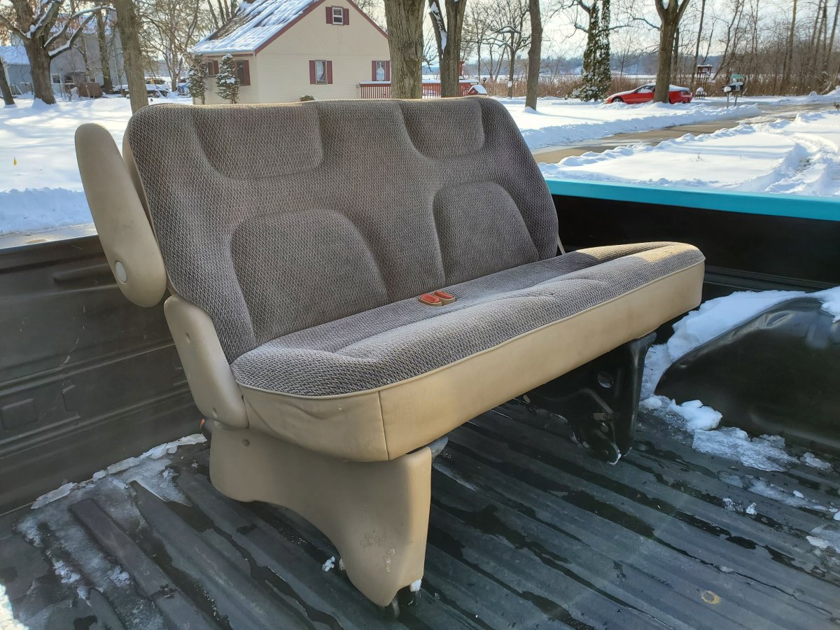

    Little more work done on the roadster. Found a Dodge Caravan second row seat for $20. It was like it was made for the car. Fits right on the seat riser. It will help locate the steering wheel and pedals for a comfortable position. Yes I will be recovering the upholstery at a later date. 20210118_160806.jpg 20210117_172756.jpg 20210109_140228.jpg

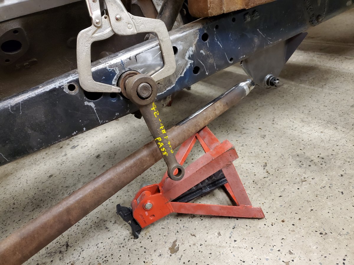

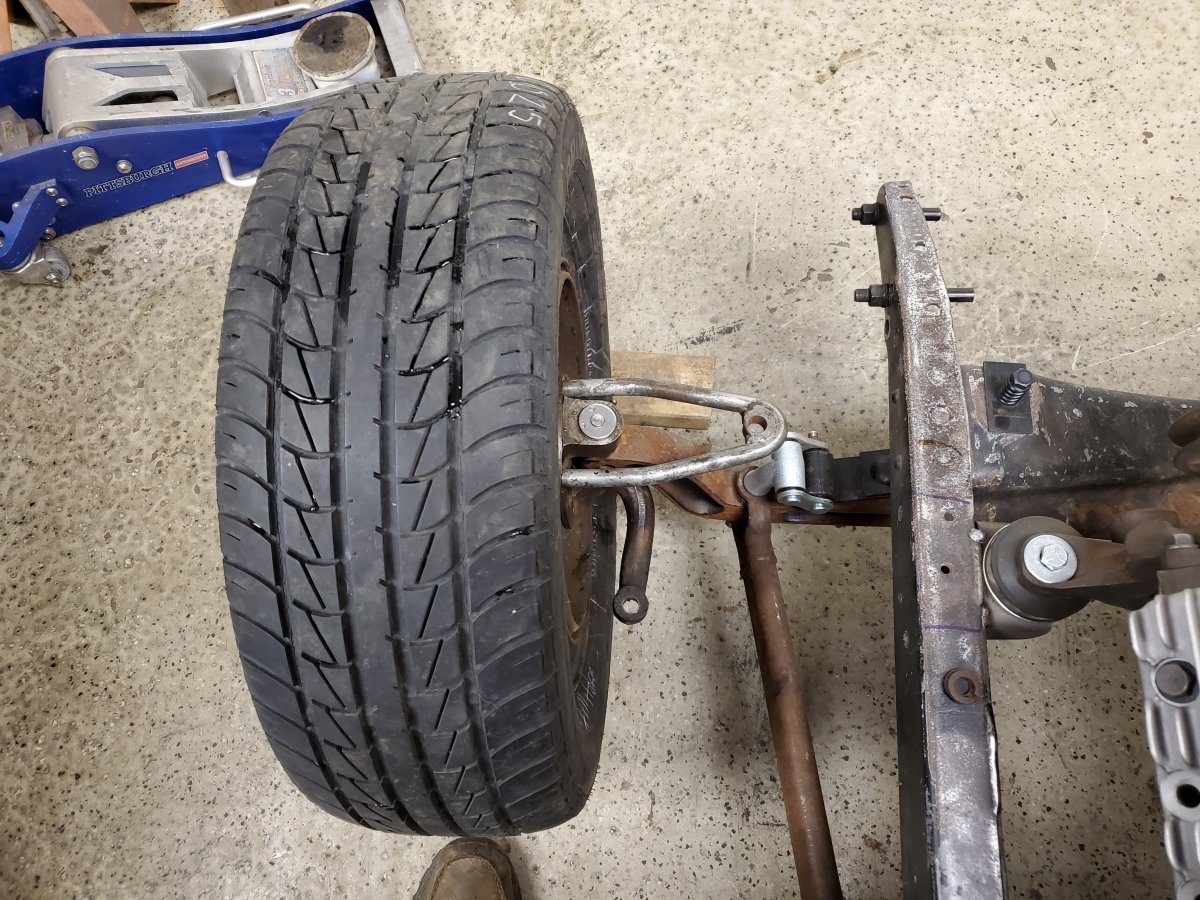

    4" dropped axle. Round back spindles and 40 drums. Posie spring and split wishbones with Speedway mount kit. Not welded just yet. But the chassis with 29.0 rear tire and a 25.0 front I get a nice three deg rake. 20210203_162307.jpg 20210203_144903.jpg 20210203_144928.jpg

    Mine are not attached just yet but are positioned where they go. I noticed the sub rail could have extended a little farther to give the top two holes to bolt/rivet to. 20210204_113225.jpg

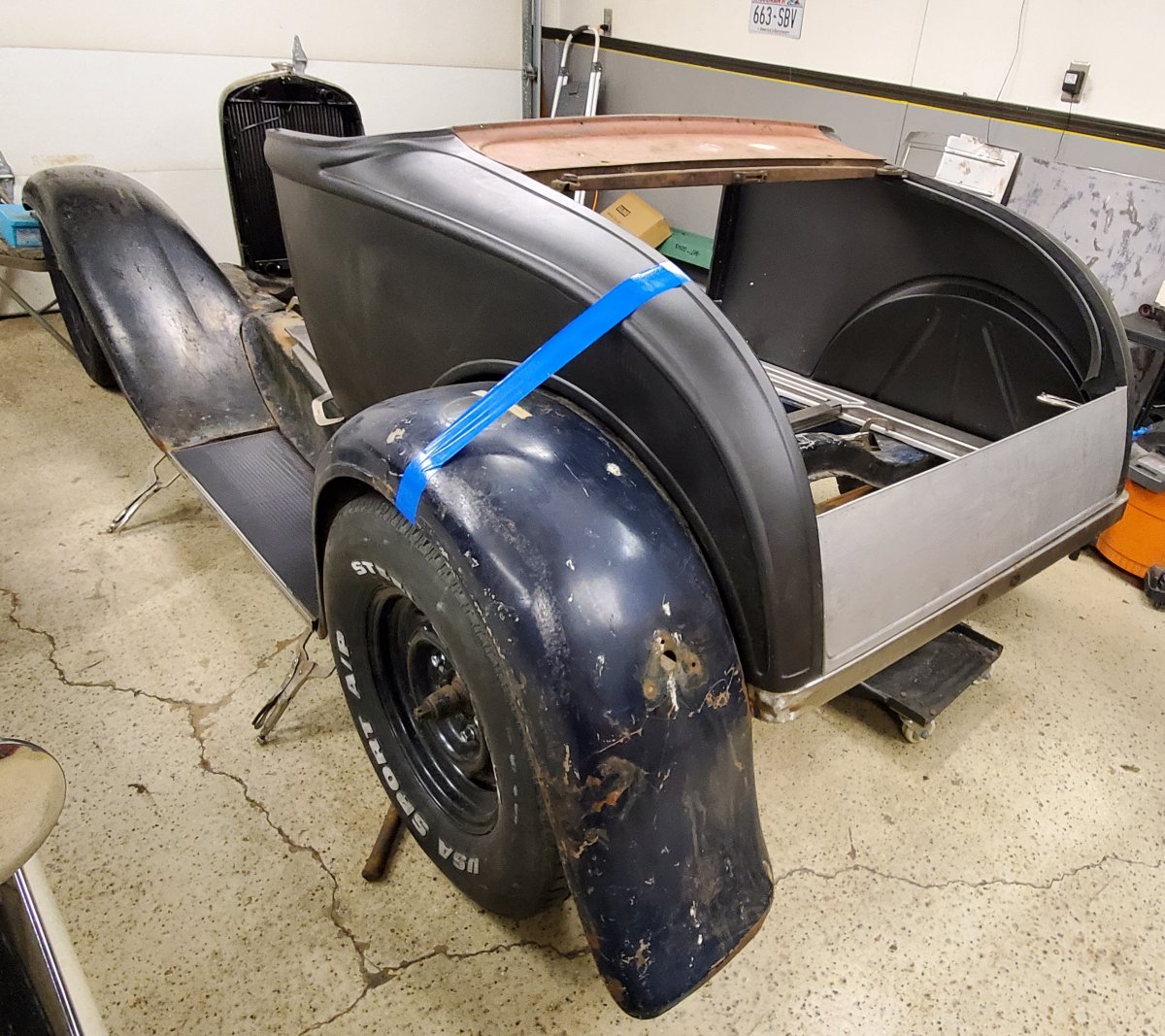

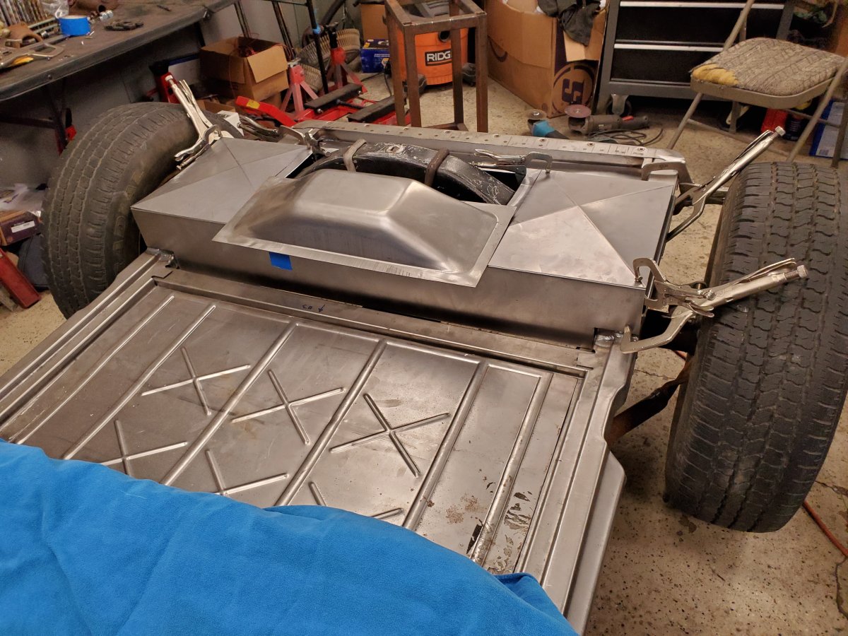

    20210212_132237.jpg I have a 4" kickup in the rear for the rear spring. I did a little sheet metal work today in the shop. Can you tell I have done HVAC work in the past? Don't have a beading tool but it does the job. Small little trunk now. Hope to fit a gas tank in there somewhere. 20210212_145043.jpg View attachment 4974012 View attachment 4974012
    oliver westlund, Tim, Stogy and 5 others like this.

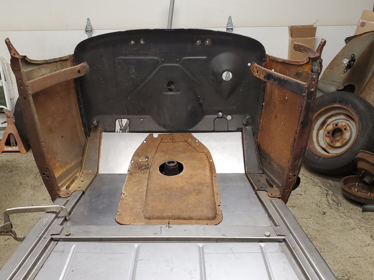

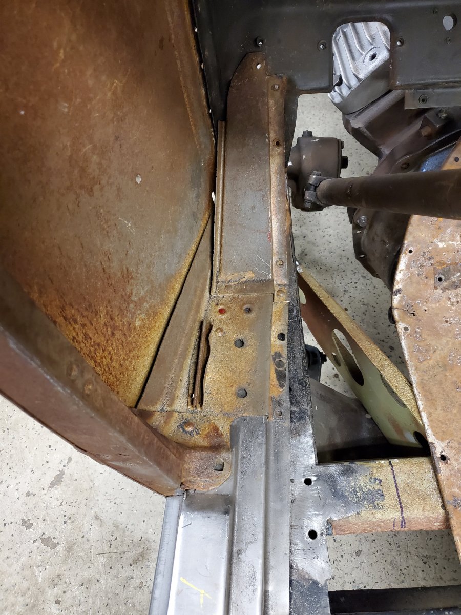

    Finished mocking up the rest of the floor.
    The toe boards. I used a F1 trans cover to clear the 32 crossmember and trans tower. Again trying to use old ford parts.
    I was almost going to use plywood but I just couldn't bring self to doing it. Shifter tower is a little off from the F1 location in the cover. A little patching will fix that. Next clearance the steering column and pedals and we can start hanging the body. 20210215_153850.jpg
