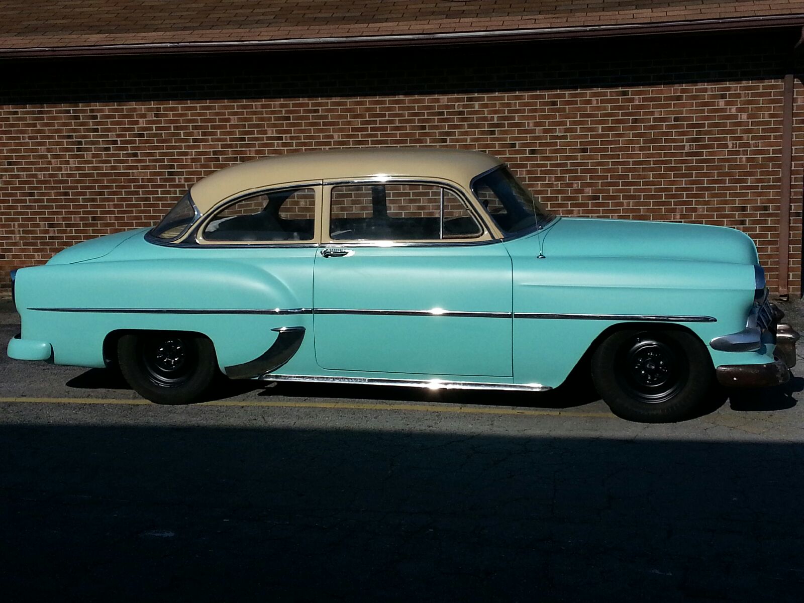

    The car has settled and rides great now. The last owner did a crap job on the exhaust and it is the lowest point under the car. That will be fixed later. Also rebuilt the master cylinder over the weekend. Brakes feel awesome now. Here's a couple pics from today.

    So I spent most of the summer working on my 54. I added skirts, painted the entire lower half of car again, painted wheels, added spider caps, rewired car, and did most of the interior. The car was bare metal inside when I got it. This car has been a learning curve for me. It was my first paint job, my first attempt at seats, and I am still learning as I go on the mechanics of it all. Enjoy the pics.

    Looks good. What did you do to lower the rear that much?
    M-
  17. 51fordor
    Joined: Sep 16, 2010
    Posts: 215
    51fordor
    I just used 3" lowering blocks and installed air shocks.

    gasalley
    from East Texas
    Wow, i did the same thing but mine just doesn't seem as low. Maybe my springs have a touch more arch......

    My springs are well worn I assume when compared to your picture. Your right, big difference.
