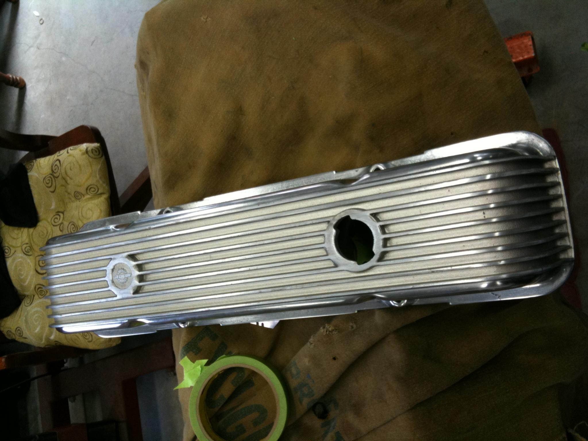

  9. Looking Awesome! I love the valve covers.

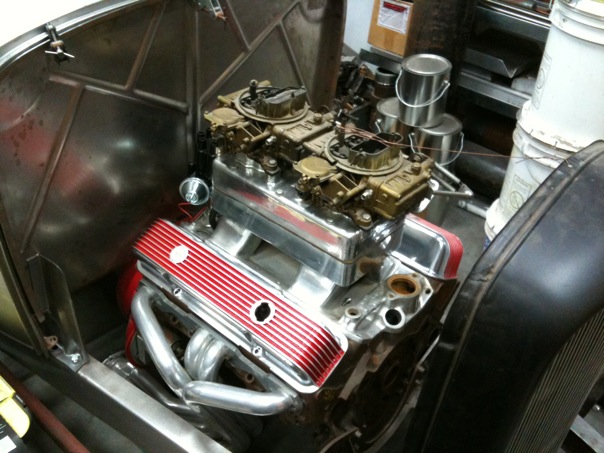

    I'm going to grab a set for the Roadster as well... Here they are on the motor in the '32. I couldn't resist.

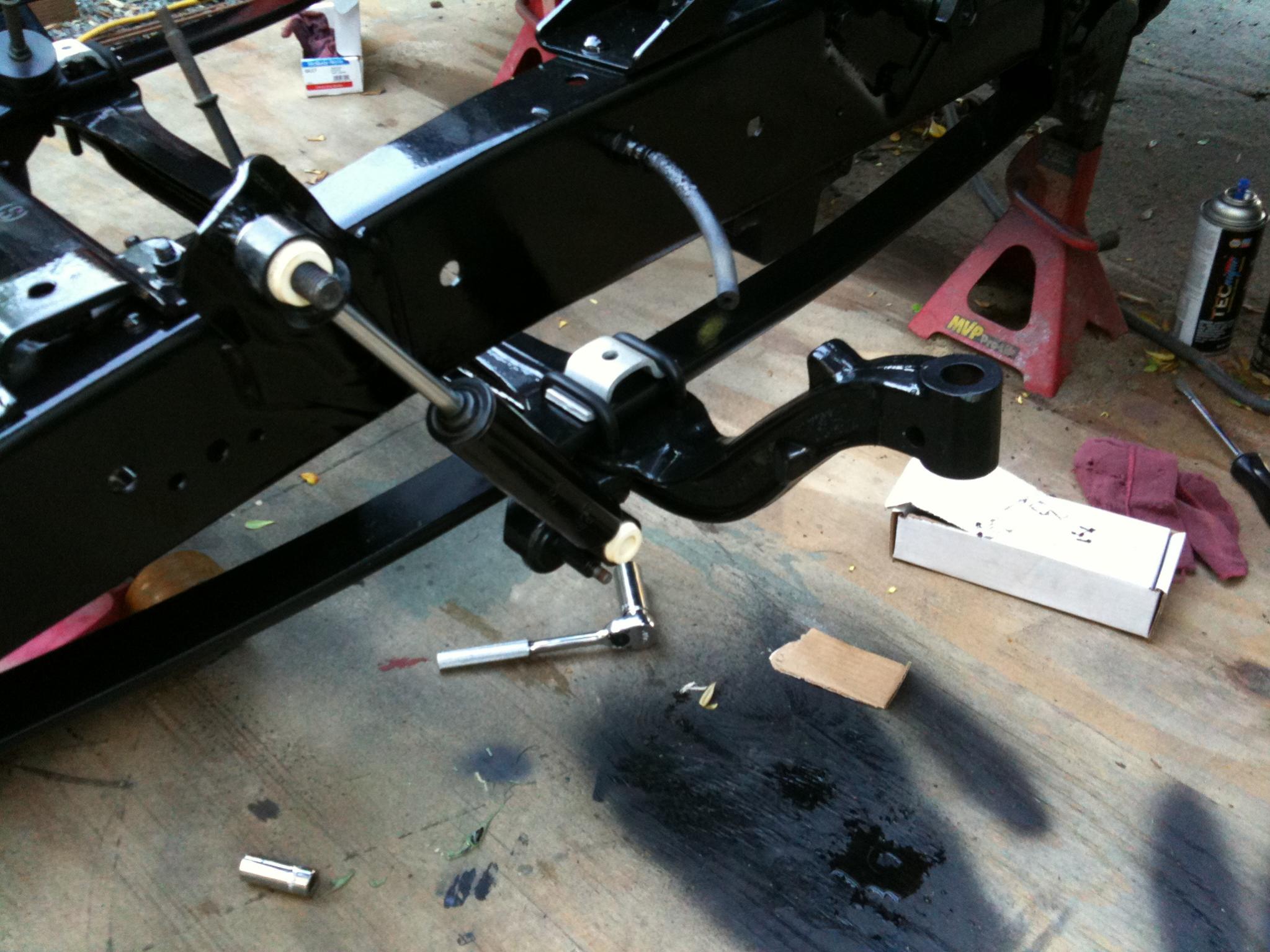

    I ended up with the day off which I thought would be super productive but in the end the progress was only so so. I wanted to finish up the Master Cylinder Assembly and get it in so Brake lines could be run this weekend. Happy to report that is done but it was a chore.
    Now I gotta say that the stuff from CPP looked super nice coming out of the box but...... I go to bolt up the push rod to the original Brake Pedal after it had been installed into the bracket and there is like a 5/8" gap between the heim joint and the pedal. So I get on the phone and ask the fella what's up. He says, "Ah Uh well my guy says it should be there???" Right well it's not. And the bolt supplied with it is no where long enough to join all this shit together. Right, not a big deal... But for $200 it should be right. So I grabbed some bar off the shelf and chucked it up in the lathe. Space made, longer bolt procured and the bitch is finally in the chassis. Oh right and then the pedal gets adjusted and it turns out the pushrod is only about 1" too short to work. Neat! So again, grab some stock and git'r done....

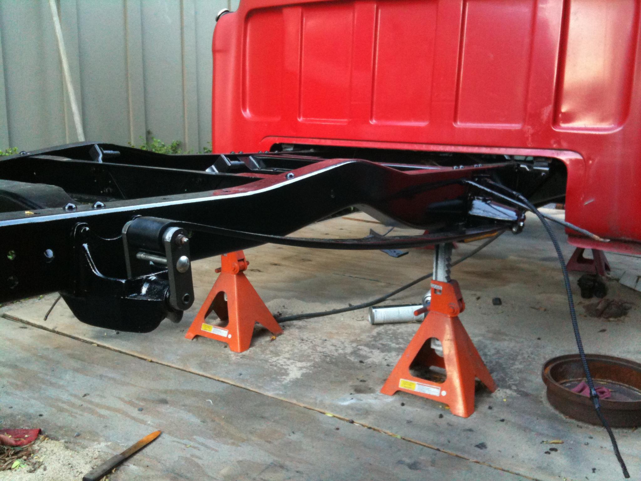

    Here's a few pics of the rear springs and that Damn Master Assembly all bolted in and ready for duty. You can see from the one side shot on the springs that its going to be nice and low. SWEET....

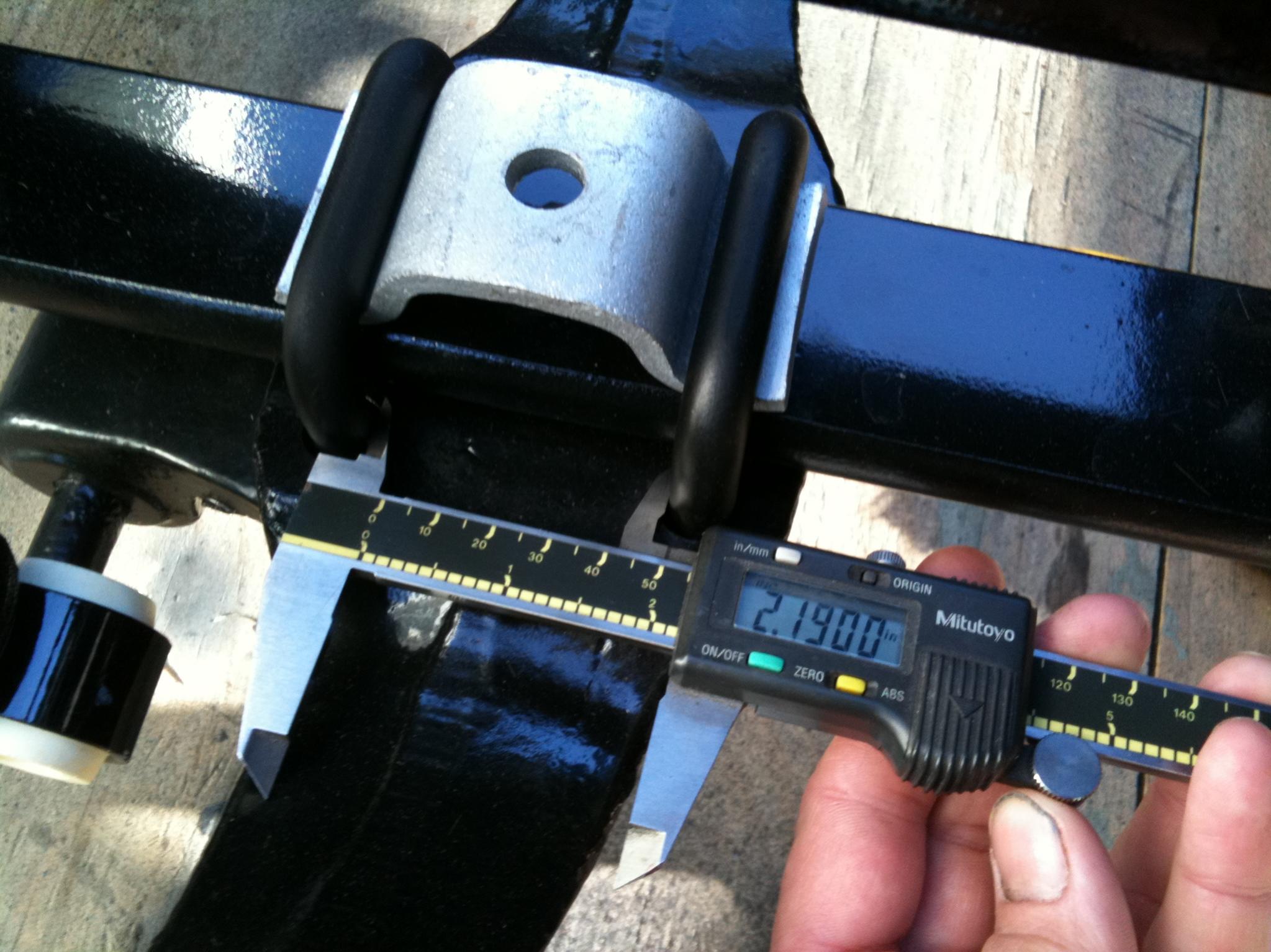

    Let's put some caster in this deal... Yeah I don't really know how much it needs but I'm going to take a stab and say 6 degree shims will do the trick. I'm assuming with the rake the truck will sit on and then general arrangement of the new axle with these springs on the front its all gonna work just fine. I've got 8 degrees on my roadster and I think that's about the limit of a street driven deal. This will most likely fall somewhere between 3 to 6 once it's all said and done.
    So I nabbed these shims from the local spring dude and they are a touch wider that my application. Perfect! I want all of this shit to lock in and stay put so this is to my advantage. I did a few quick measurements and then got hot. The pictures will pretty much tell the story of what I'm doing. The other little trick is extending the center bolt so that it still registers the axle in the correct spot. Easy, Just get a longer bolt, run a nut on it and then assemble it up. I noticed they had some bitchin chrome acorns at the local mercantile so I couldn't resist.

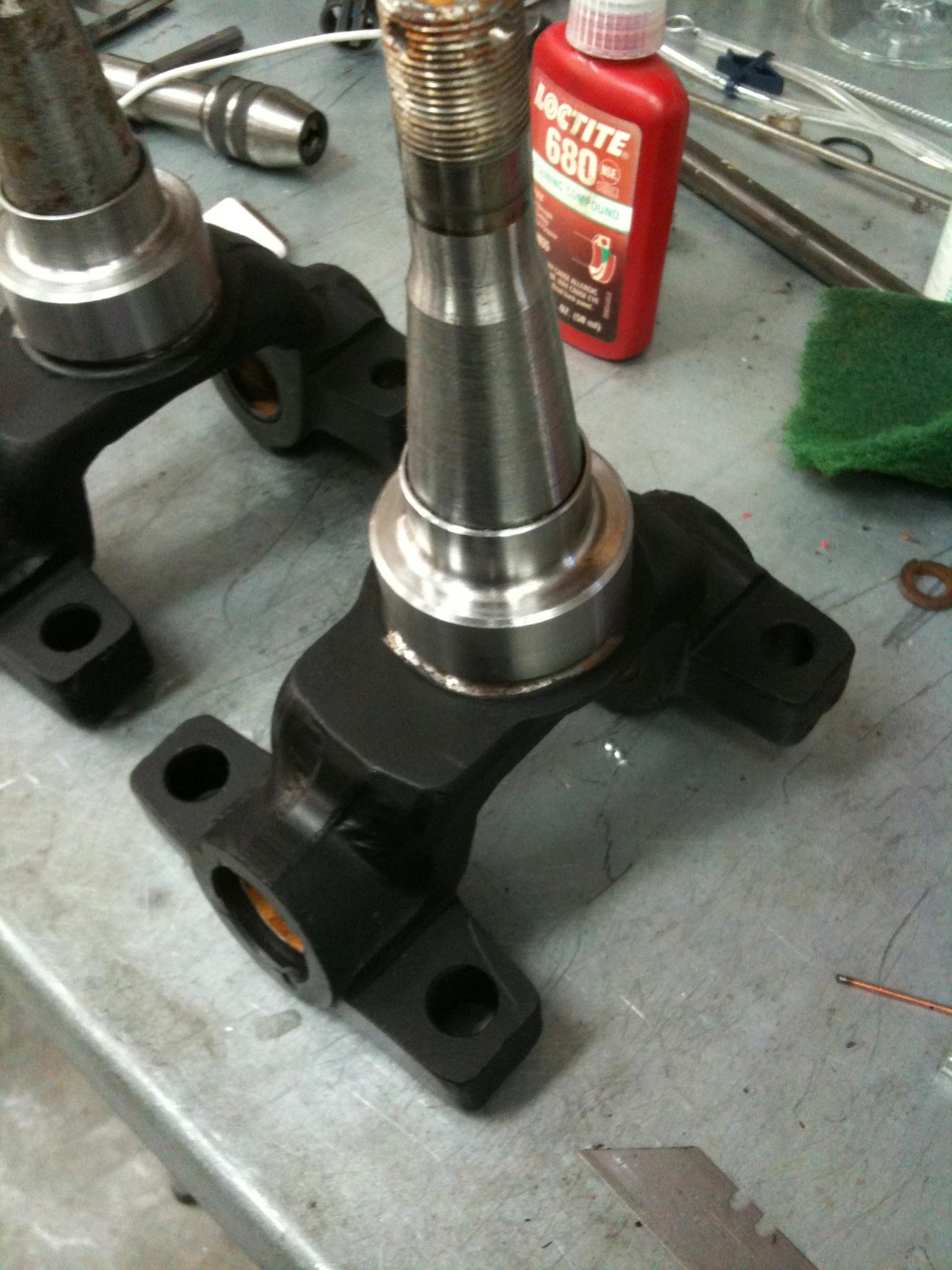

    Spindles! So the brake kit from CPP so far gets the thumbs up. I think more and more they sent me the wrong push rod with the Master Cylinder kit but oh well. So onto this new deal. They have these bearing spacers that slide onto the spindles to provide a new race/seal surface. On the earlier trucks I think you actually shrink and or press these on but for me they had a perfect sliding fit. Well they can't turn so out comes my Good Ole buddy Loctite! Now trick with this shit is to be clean. So a little scuff with the pad and then a wipe down with brake clean. Spray it with the primer and let it dry. Then apply the retaining compound and smoosh the 2 parts together. Give it a quick spin to spread the shit, make sure its home, then leave it. WHAMO, they are now 1....

    Out to the truck and we start doing all the normal shit for spindles. Checking to see the whole things jives together and if you need any shims in with the bearing etc. I then packed the little thrust bearing with plenty o grease, lubed up the bushings and pins and jammed the shit together. Nice tight fit and once the locking pins were in these things are good as new. After the spindles were on I hung the brake brackets and torqued all the bolts to be sure they are driven home. I also put the calipers on really quick just to check clearances. Everything looks OK except for just one spot where I think its touching a bolt head. I'll just ease that with the grinder and then it will be perfect.
