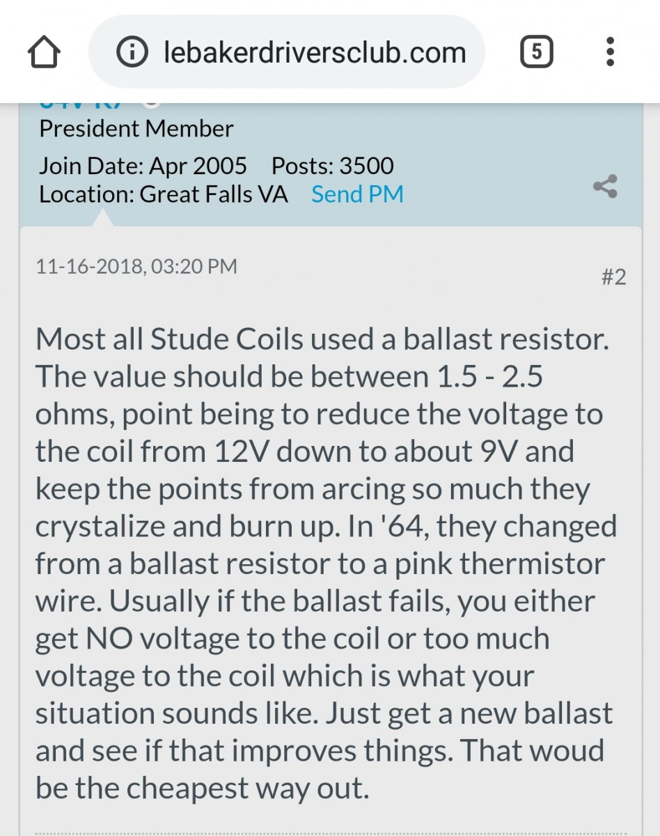

  1. Yep.
    Many Studes used a resistor wire, disguised as a normal wire, between the ign switch and the power terminal at the coil.
    It is indeed a good idea to run a new wire from the ign at the keyswitch to the coil or resistor for the power, so you get an actual 12 volts to the ignition.
    Glad you pointed that out.
    It got me once a long time ago on my SIXTY TWO Hawk.
    Running a new wire instead of the original pink one solved everything.
