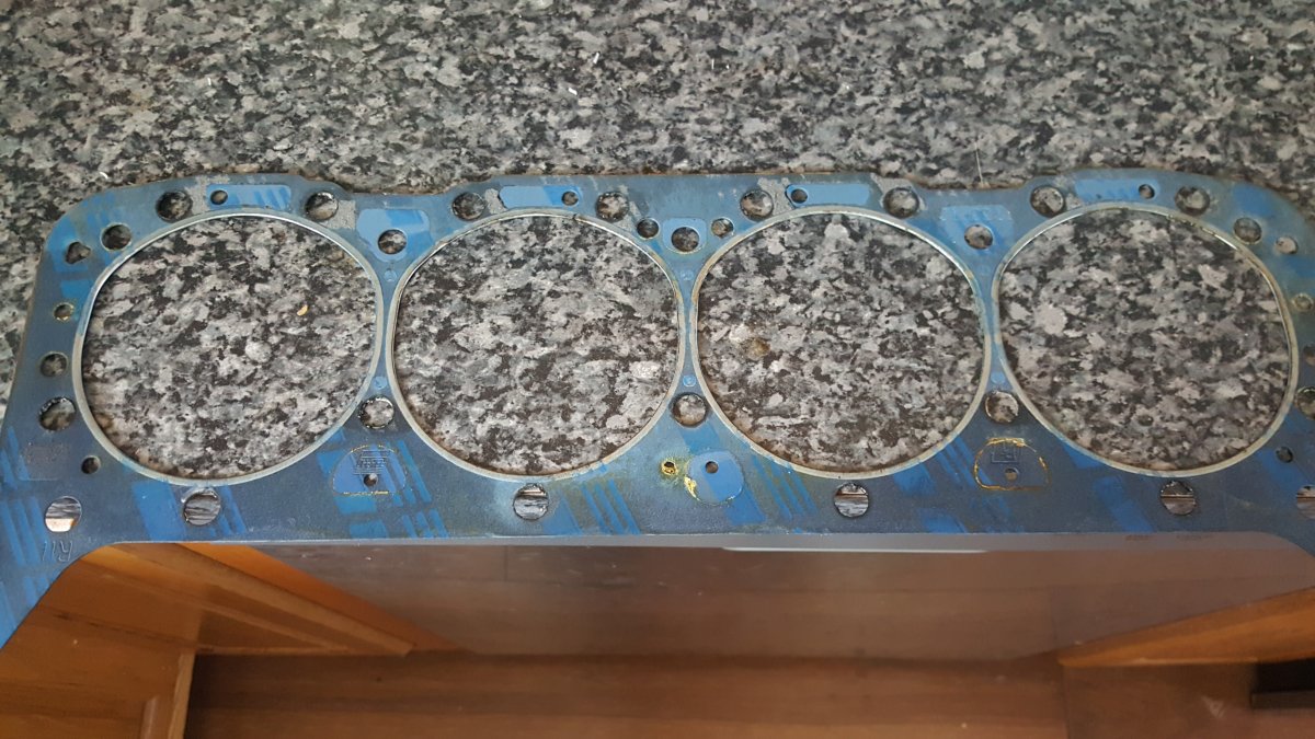

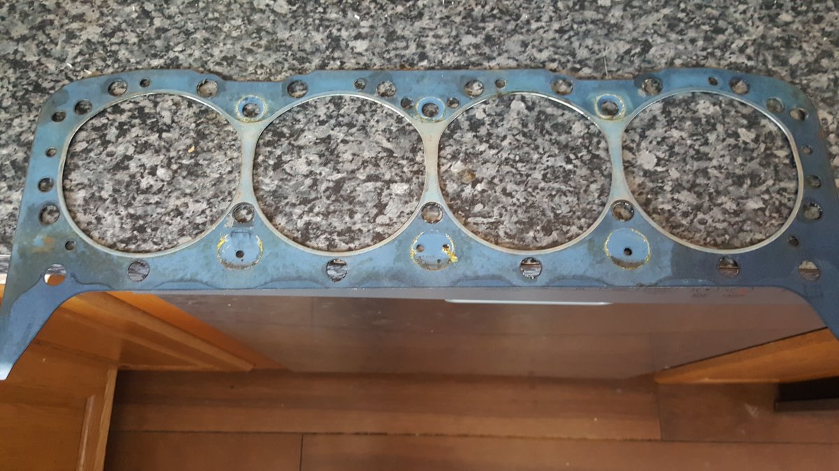

    I want to use a thicker gasket, what's the thickest I can safely use.
  23. Devmar07
    Joined: Sep 2, 2017
    Posts: 117
    Devmar07
  24. Devmar07
    Joined: Sep 2, 2017
    Posts: 117
    Devmar07
  25. Johnny Gee
    Joined: Dec 3, 2009
    Posts: 12,696
    Johnny Gee
    from Downey, Ca
  26. Devmar07
    Joined: Sep 2, 2017
    Posts: 117
    Devmar07
    Sweet pic
  27. Johnny Gee
    Joined: Dec 3, 2009
    Posts: 12,696
    Johnny Gee
    from Downey, Ca
    Your counter top blends in well with the combustion ring of your gasket.
  28. Devmar07
    Joined: Sep 2, 2017
    Posts: 117
    Devmar07
    Probably not the best choice for a photo shoot
  29. Engine man
    Joined: Jan 30, 2011
    Posts: 3,480
    Engine man
    from Wisconsin
    Cometics makes them up to .120 compressed thickness but they are expensive at $80 per side. I was always an old school guy that liked the steel, original equipment gaskets. When Fel Pro came out with the blue composite head gaskets, I saw a lot of failures in high compression engines. Even the Victorcore gaskets seemed to fail. When the parts guys would ask if I wanted the good gaskets I would say yes, I want the stamped steel gaskets as I never had one of them fail.
    I learned from a diesel mechanic to paint the steel gaskets with high temperature aluminum paint then K&W made a Copper Coat spray that I've used on steel and copper gaskets. I've seen people use multiple gaskets of steel or copper to decrease compression before various thicknesses were available. The shop that did the heads can likely help you with what thickness to use.
    olscrounger likes this.
