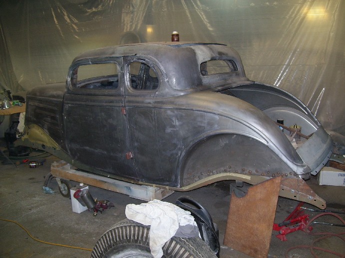

    Picked up a new project a couple weeks ago. Needs a lot of work. I'm starting to the chassis first. I'm building this one as a highboy. It is all steel un-chopped Henry steel, wanted a chopped but this one came available... and I am 6'3" and my unchopped 1932 five window is probably best unchopped too. I think it is an early 34 body. I decided to go with the 33 doors. I also have a set of 34 doors, but like the 33 better. I will be updating the thread often. Give me your feedback and ideas.
    Brandon

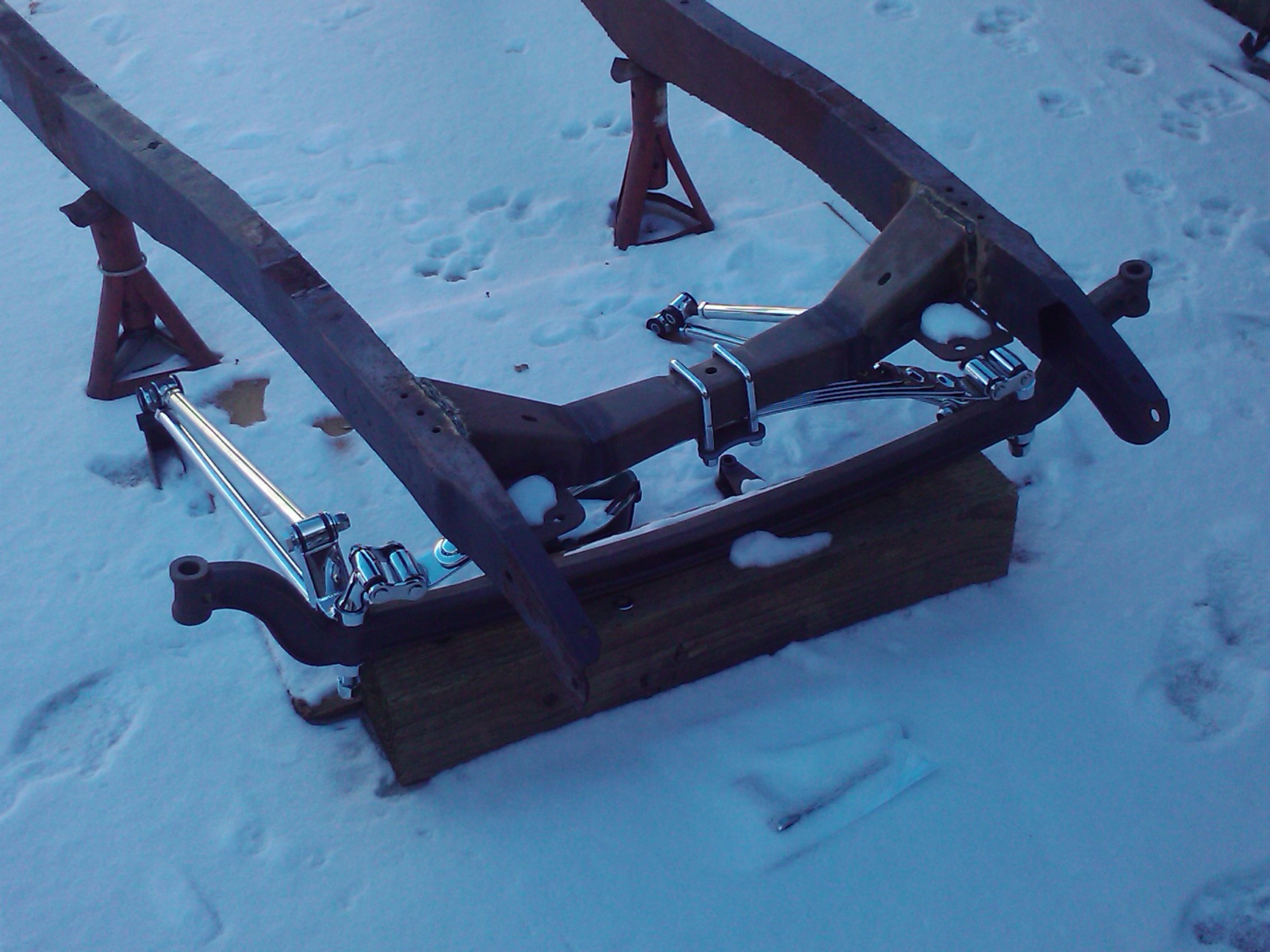

    Chassis: Chrome/polished/paited front end, original boxed rails, triangulated rear with a quick change. (I still need a quickchange if anyone has a rod ready one for sale/trade?)
    Engine: Early 331 354 392 Hemi, (also need one)
    Body: I am thinking of a Steves realsteel louvered deck lid? Any thoughts?

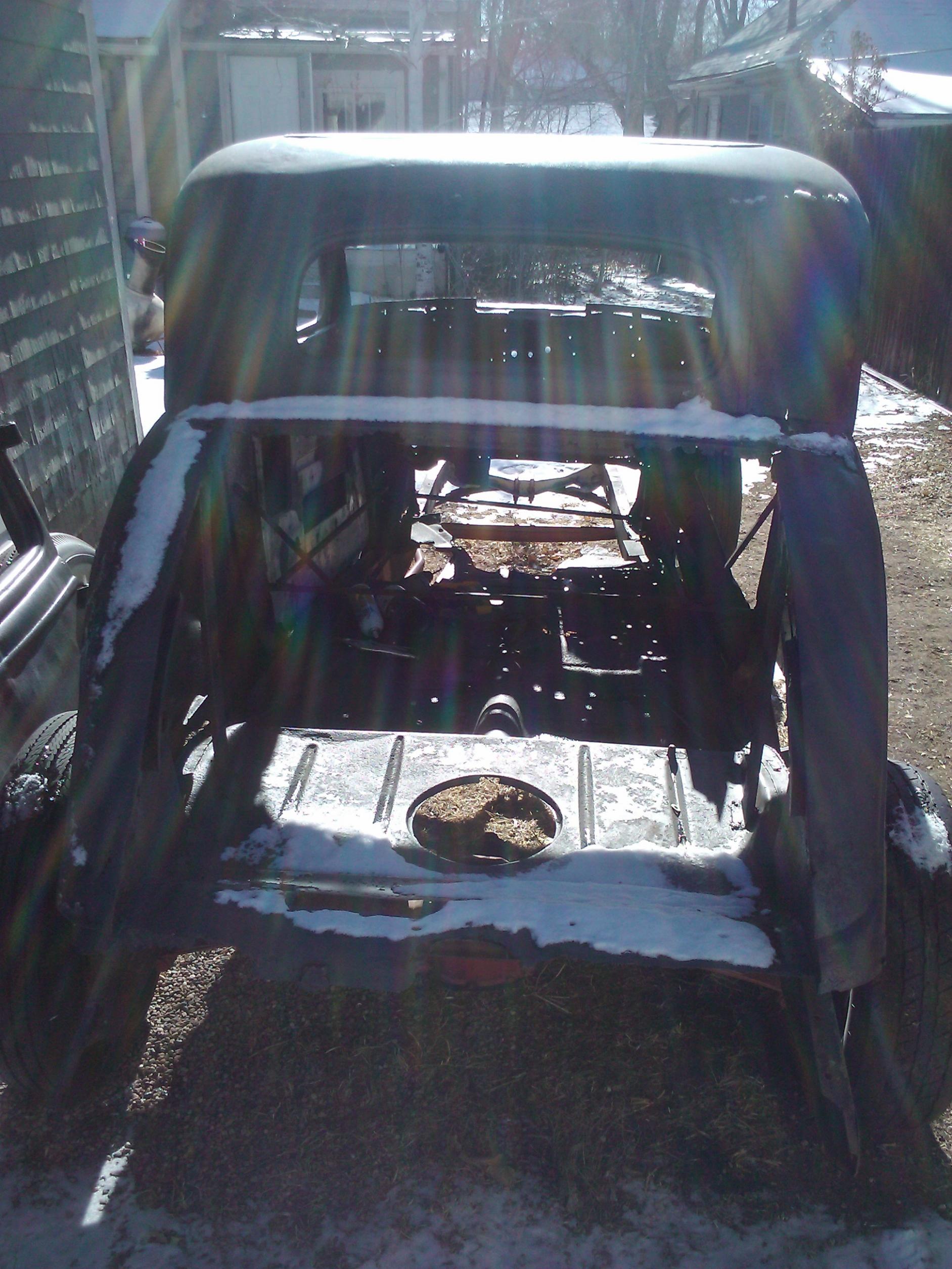

    Todays progress: starting to separate the body from the subrails. And a lot of measuring ond planning the build of the k member on the 33 frame. I havent decided if I'm going to build the k member or buy a "kit" Pics to come, although these are the boring ones! I bought trunk drip rails from Howells steel and they'll go on this weekend.

    The 33 door has a latch at the front of the door. The 34 has the latch at the front with rod to a handle in the center. Also the 34 door has a smaller window opening; at the back section, there is a 3/4 inch cover. It is there to shield the gap when the window is rolling up and down. The door garnishes will interchange, but are slightly different.
    Here is a pic of a 34 door set... the 5 window body has 33 doors on it.

    That 34 passenger door is from a 4dr, they don't bow out as much and just make a 5w look funny in my opinion. The extra part in the window on a 34 is so that the glass can slide to the rear giving you a vent window. Looks like the 33 passenger door is also from a 4dr. Has a weld seam where the extra height was removed, I think it is about 3/4 inch.

    Chassis work continues. Mounting an original k member and pedal set up.
