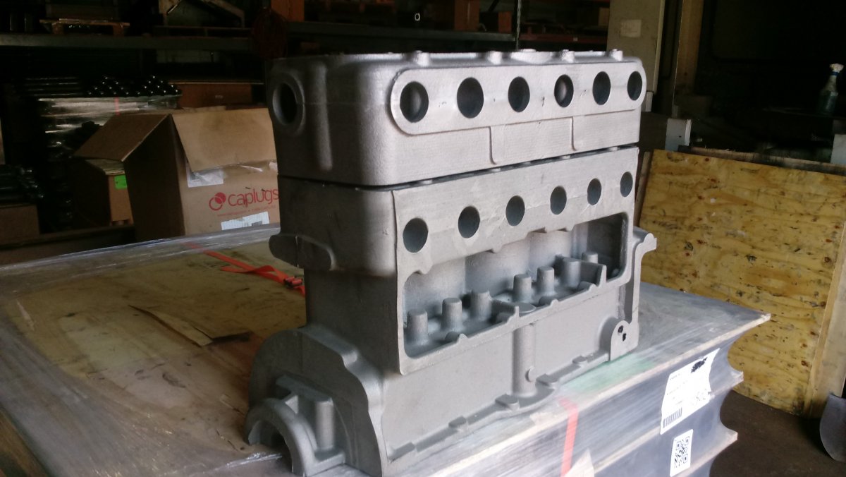

    Making some progress, despite being pretty busy.

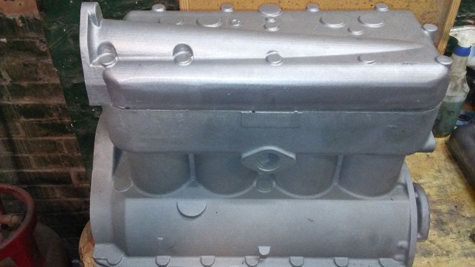

    First B head in iron. Can't wait to machine it and get it on an engine.

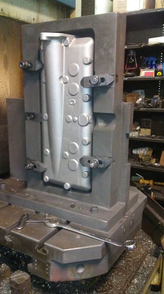

    Here is one of the aluminum B heads in the fixture so I can get it set up and ready to write the program for machining it. Also setting on an aluminum 5 main block. Tod b bead in fixture.jpg B head and block.jpg

  24. Crazydaddyo
    Joined: Apr 6, 2008
    Posts: 3,171
    Crazydaddyo
    Is this a new block casting too?
  25. 427designer
    Joined: Aug 15, 2011
    Posts: 233
    427designer
    from Ohio
    This is not the one that I am making from the newest process. That will be made soon. I was ready to take sand to the foundry but the owner had to go out of town. The new process will be nicer.

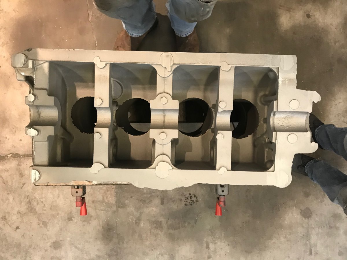

    OK, here we go with the first aluminum 5 main block just out of the sand. After talking to the foundry, it sounds like I need to provide for chilling a few spots, but for the first attempt in a new molding and pouring method, I think it looks pretty good. Can only get better from here on.
    Tod
