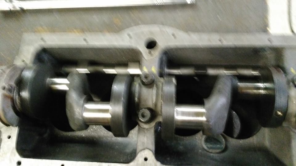

    The crank will be put in next and then everything gets assembled to get ready to run.

    I took a picture that shows the crank and cam installed but I must have moved a little bit because there is a little bit of blur to the picture. I could still post it regardless, if anyone is interested in seeing my shoddy photography.

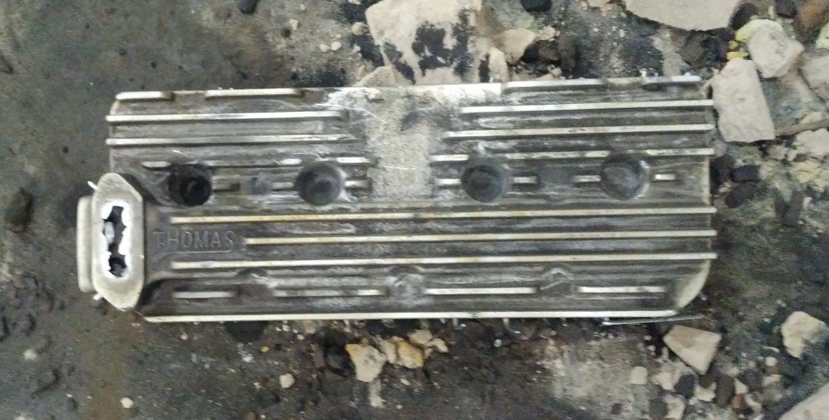

    First new Thomas head out of the sand today -
