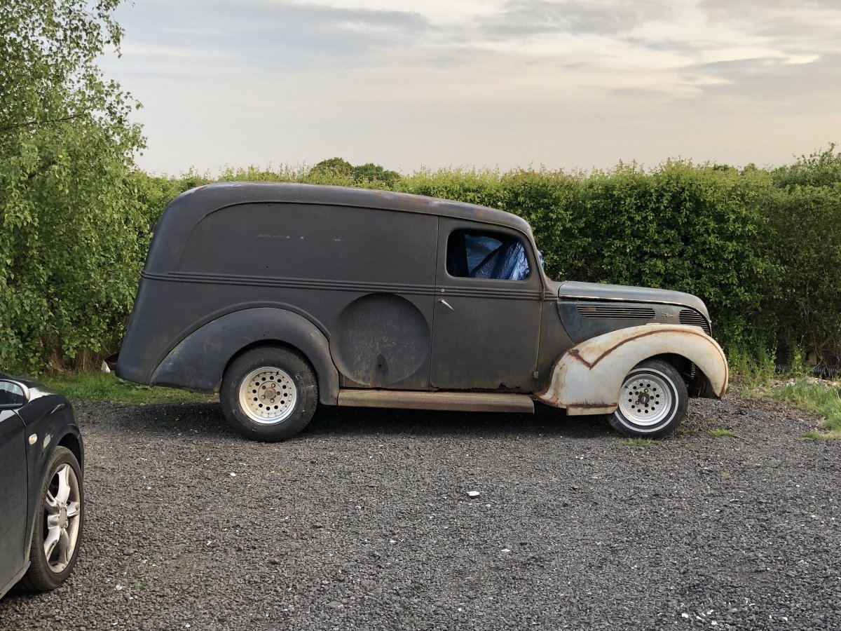

    At the moment I’m in the process of setting out my build and have run across a problem, as I don’t having a lot of experience I thought I would post on here.
    I have a 1938 ford panel truck that I’m going to be building with a 1938 ford deluxe front sheet metal. The hood and hood sides fit perfectly , for the fenders I’m going to have replace the lower cowl section with a 38 deluxe repair panel so they fit.
    Now the problem I have come across is that the front wheels aren’t central to the front fenders and it looks like the front cross member needs to come forward about 5”
    After looking at many pictures of 38 deluxes and my panel truck I have seen the cowl sides are a lot wider on my panel truck.
    Any ideas would really help .
    Thanks

    This is my truck, you can see the hood and hood sides are in place but the fenders need to come back about 5” to be in place.

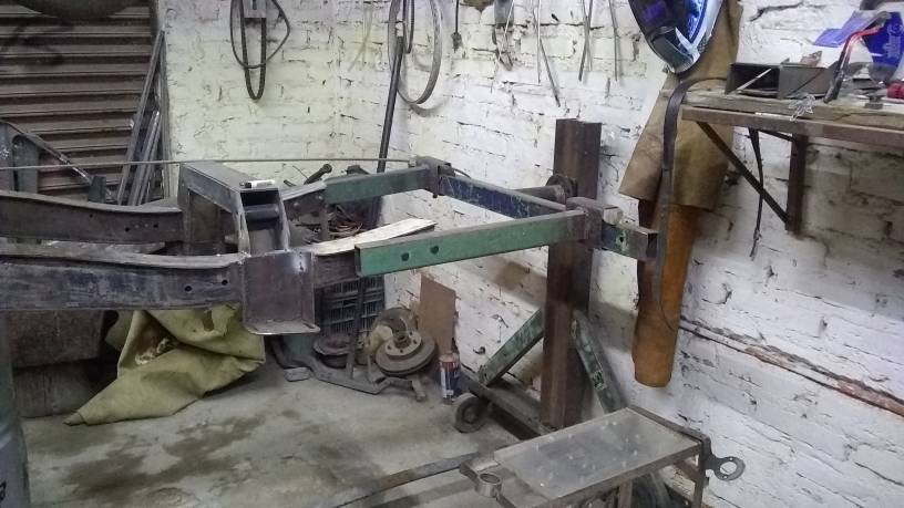

    C2A2A582-3ECB-49B6-9E3C-0241ECCE851A.jpeg The front axel/ cross member is original
  5. Only thing that I can think of is to replace the front cross member so you can run a spring over axle like earlier cars...model A- 34 Ford.That should center your wheel.

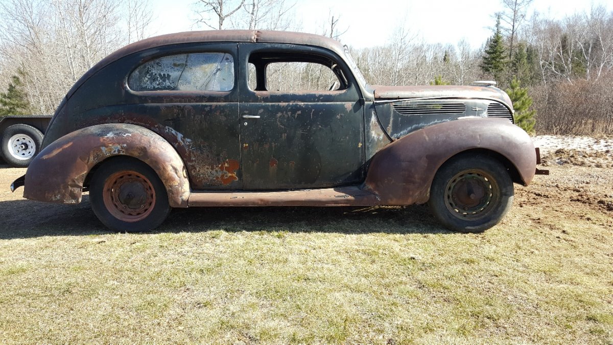

    5B263601-EE6C-422C-A4FE-F67FBC8C2A3F.jpeg 556EF004-E74E-4BA4-895B-37EA2A9E1204.jpeg
    One thing I did notice is the cowl side on the panel truck is a lot wider then on the sedan...
  8. typo41
    Joined: Jul 8, 2011
    Posts: 2,571
    typo41
    the panel truck and the sedan are apples and oranges, both fruit but
    the cowls are totally different, as are the fenders,, the 38 truck would be the 'beer barrel' grill
    does it fit? and can it fit? are what you are looking at.
