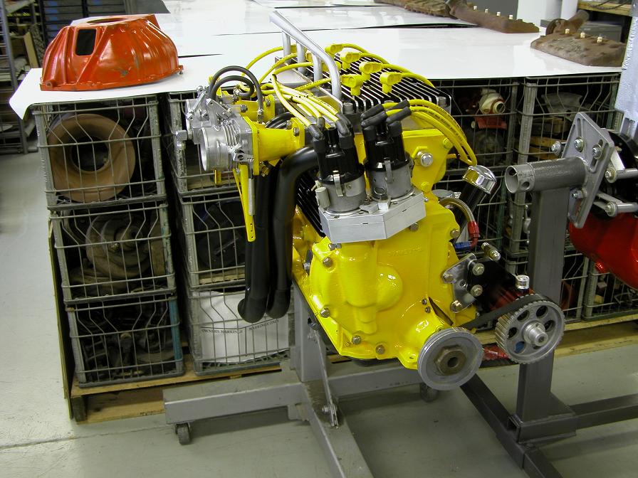

    Surely people here have heard of or seen the gear boxes sold to speed up or slow down steering shaft rotation. Do you think they are some how safer than one made to reverse rotation? The mentality here is "If it is sold in a cataloger, it's good. If I made it it's not" Or at least that seems to be what I am reading. Would you buy one of those chain drive steering deals being sold now? I wouldn't. I had several people tell me my twin distributer drive wouldn't work on my 32 Plymouth banger with my home made head. Stop by and I'll show you the SCTA record trophy's. Same thing for the 57 Ford V8 head on the Plymouth block. You can see those trophy's at the same time. Corvair turbos on a 270 GMC back in the 70s. Everyone knew that wouldn't work. You can look at those trophy's too. Don't touch.
