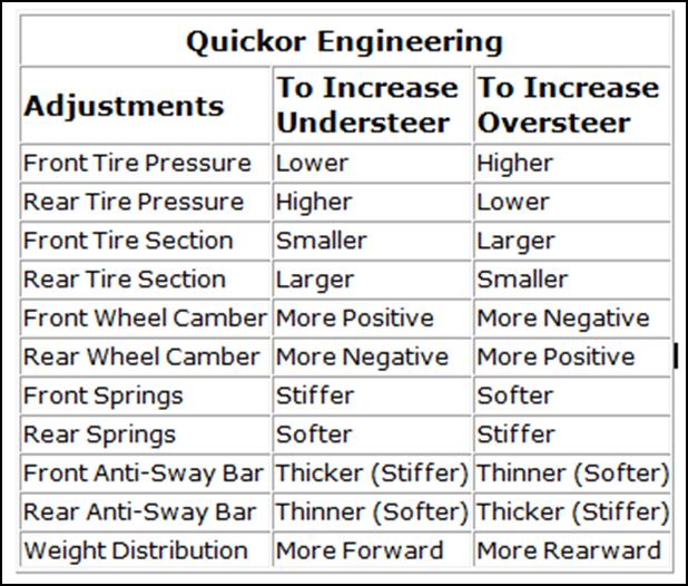

  7. Assuming your tire selection and shock absorbers can't be changed, you should:
    • Raise front TP.
    • Reduce rear TP.
    • Stiffen the front spring by adding one or two short leaves.
    • Soften the rear suspension by removing a short leaf.
    • Move weight rearward.

    Thanks for the chart!

    Study the chart in post #7.
    There are MANY ways to accomplish any given thing. Don't put a ton of thought into any ONE thing, it'll just confuse you more.
    Just make small changes to your existing car/suspension per the chart.
    If nothing works, then make larger (parts changes) to the car to effect the given changes, per the chart.
