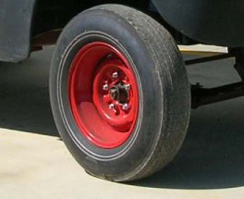

  7. I'll agree with Lostone, it's far more likely that it's a tire problem rather than a wheel problem. It appears you may have a set of Coker reproduction Firestone tires, they have a bit of a reputation for balance/out of round issues like this.
    As to the wheels, those 'smoothie style' wheels you have appeared in the '80s and aren't really a 'traditional wheel'. In fact, chrome steel wheels were rarities up until the early '60s as no one was commercially making them until then. The ones you did see were usually owner/builder built by knocking the centers out of a set of OEM wheels, chroming the bits then reassembling them, usually reversing them. Trim rings/hubcaps or full wheel covers on painted wheels were far more common in the '50s.
    There's only two manufacturers making 'traditional' vented center chrome wheels. Wheel Vintiques has their series 64 mentioned in post 2. These have the mid '50s/'60s style centers like what you have only vented. Wheelsmith make some also (again, vented), but theirs have a '40s style center and would be the more likely type found on an early Ford. And truthfully, not even these are totally accurate. Virtually all the steel wheel manufacturers use disc brake rims to construct their wheels, a real reversed wheel from 'back in the day' looked considerably different...
    ... but unfortunately, won't clear disc brakes. Plus the difficulty in even finding a vintage set in good enough condition to build.
