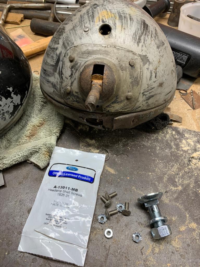

    61DE6C95-D94F-476E-B45C-F26E232FE5A8.jpeg 366D80E9-EBC1-4A11-8D6C-01065EEE78E8.jpeg 1A1F64E8-A90E-4A7D-91C5-C51AD15E25A5.jpeg bar Is temporary until I get my shocks and modify the F1 stands. Which headlights?

    I want to pop the rivets, clean up the plate and replace the bolt. Standard carriage bolts work?

    I did a set of Guide headlights recently, ground the rivets down and knocked them out. The mounting bolts were in bad shape. Used replacement stainless screws that have a rounded head with no slot which I found for Model A headlight restoration in the Snyder’s catalog. Also used new mounting bolts for the same. These photos on my thread 31a pickup build a a 31 coupe.

    Here’s the photos, I’ve since blasted and epoxy primer them.

    I think they are the same length Snyder’s sells. And my model A headlights are fine.

    The bolt lengths are perfect, I’m using a cut down 32 headlight bar.
