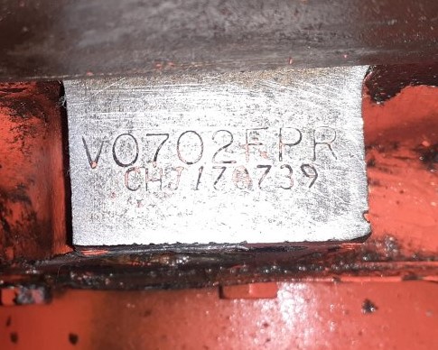

    In the back of the engine it does say 5.7 but when I look up the number that's on the head it says the heads are from a 305 and here is a photo of the pad on the passenger side if you can help me decode this it would be great want to see if it's worth building this engine 20200929_122030.jpg

    Look at the driver's side, behind the head, on the bellhousing flange. If you want to know the year and month of
    production, look at the same place on the passenger's side.

    I'm not finding FPR in the regular go to sources for suffix codes. I have to go with S10-37 in that you need to start with the casting number of the block from the back left corner.

    Suffix code orange sbc (2).jpg Where are you finding any FPR suffix code? unless my eyes are seeing it wrong.
    I even found one source I have never seen before http://mkmann.com/pdf/SBBlockID.pdf
    That shows the codes by year and it isn't there.
    Now what is the casting number off the back of the block?

    What I can find is that the engine was assembled in flint Michigan on July 2. What year I don't know but that would come with the date code on the block plus the casting number will give the bore size and an approximate year. I've pretty well blown the last hour on this, have been on more sites that have suffix codes than you can count and none as I said before show an FPR code at all for any engine.

    The assembly code is FPR...I couldn't find it anywhere either. The stuff stamped underneath might be a partial vin. Can't tell. Its a later 70s engine at the earliest because of the short pad for the assembly info. I think they switched to the short pad about 1977 give or take a year or two..

    FPR --truck 1987 350 160 hp manual

    partial VIN says CH...... which means Chevy truck from 1987, so yeah, it looks like the post above this is the answer you're looking for

    federal emissions 1 ton according to the book

    That explains the non roller set up thank you everybody for the help
