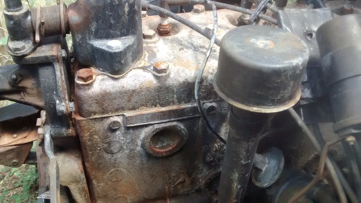

    Just look at the # on the pad in the photo, then look at this site
    http://www.t137.com/registry/help/otherengines/otherengines.php

  18. MMM1693
    Joined: Feb 8, 2009
    Posts: 1,183
    MMM1693
    Los_Control thanks for the help with the serial numbers. According to the site you steered me to I have 218CI motor. Mine starts with a T306 so the list says 218. To be a 230 the number must start with T310. Thanks again for your help'
