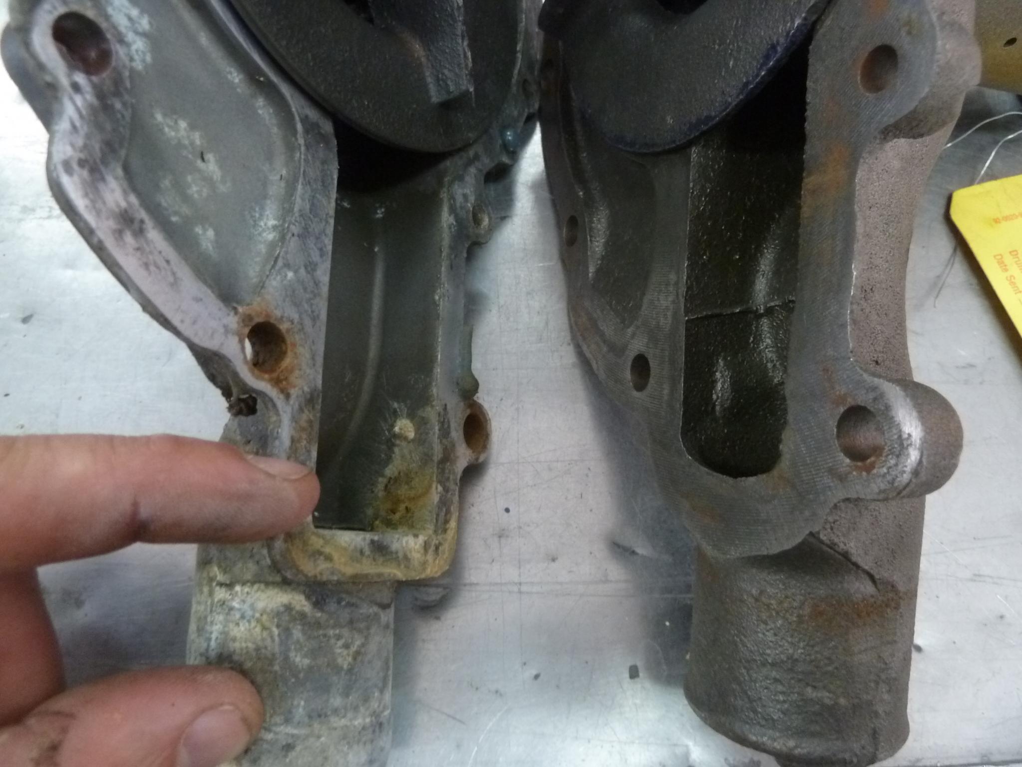

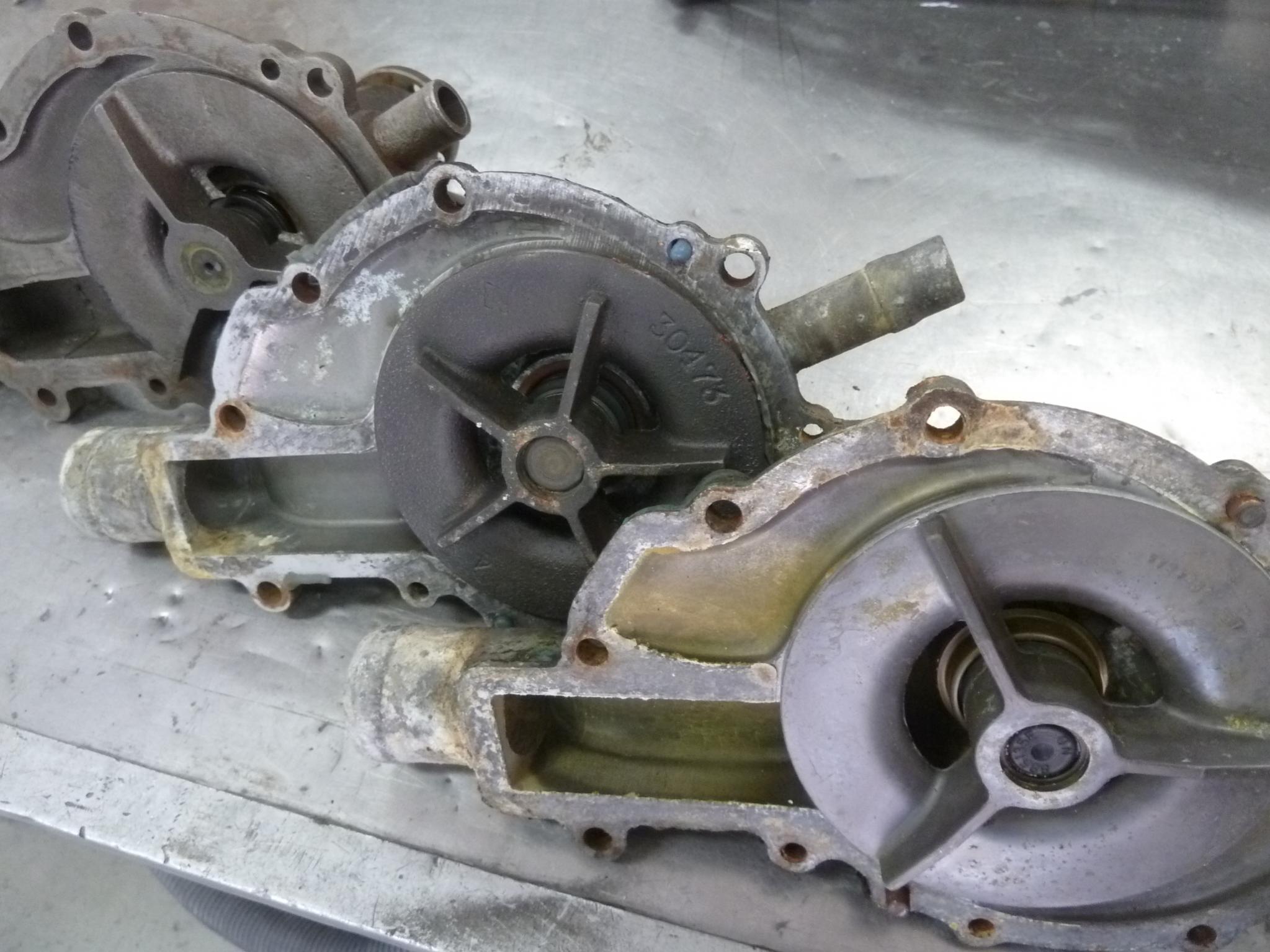

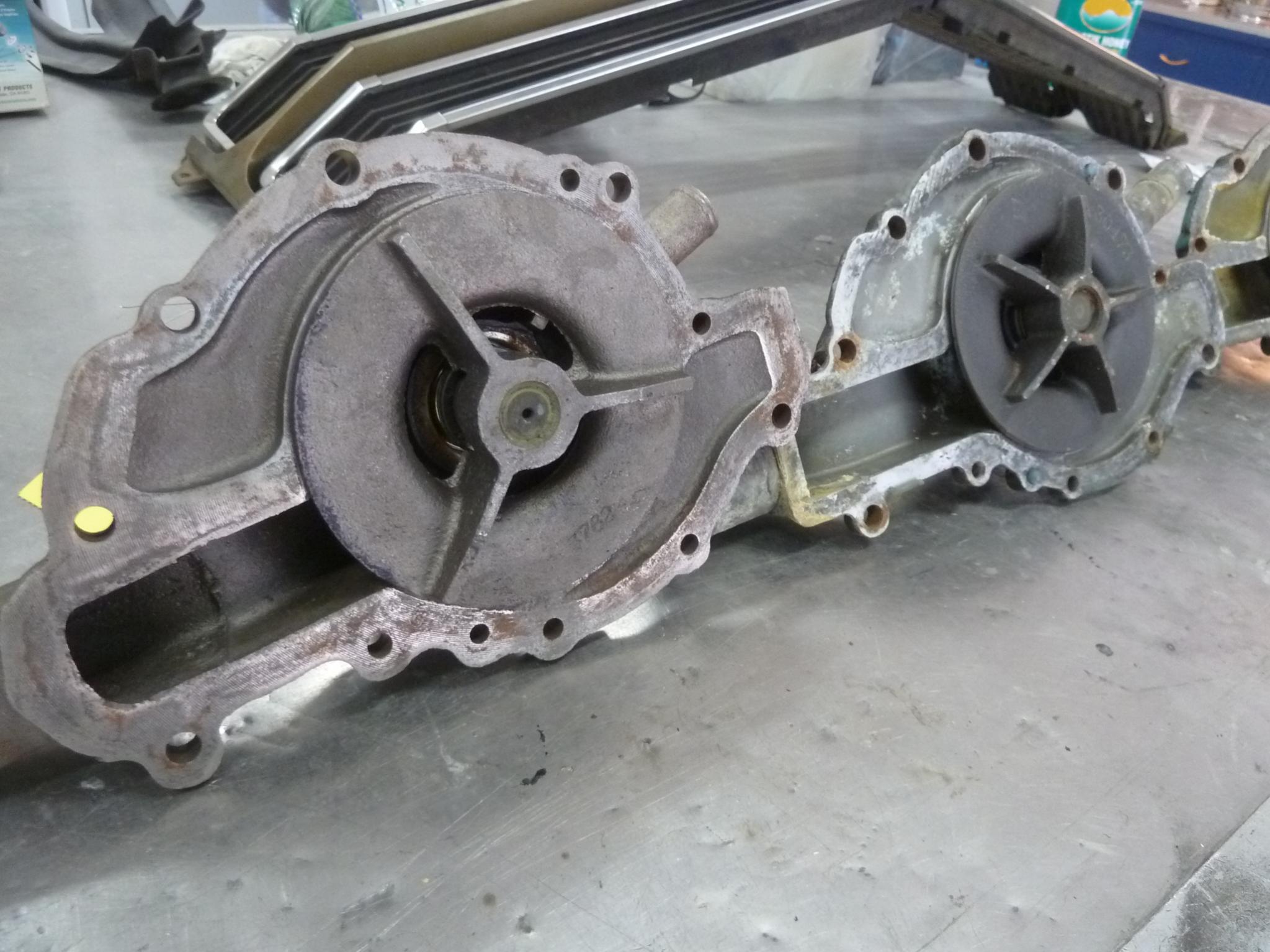

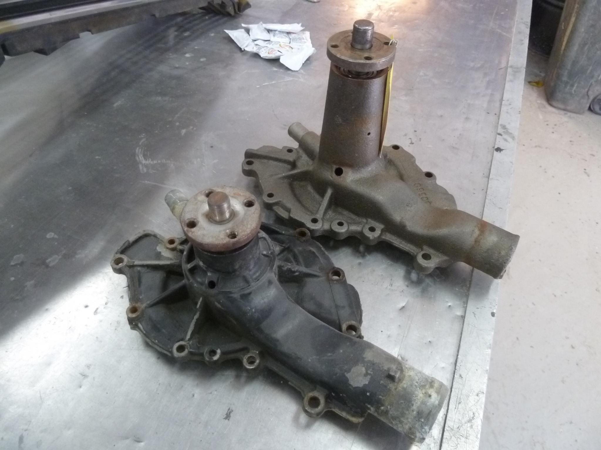

  8. paintworks_unlimited
    Joined: Mar 17, 2008
    Posts: 78
    from Dover, NH
    Here are the different pump designs. A '61 and up pump will work. They are a lot shorter though. (which is good if you want to add an electric fan) The only thing is you need to fill just a bit of outlet boss with JB Weld to get it to seal.
