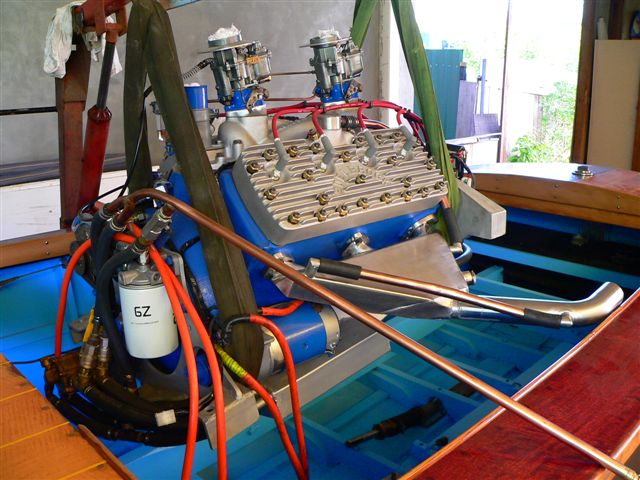

  28. Hi all,
    I have an occasional search of the net to see if any info on the Marvel Schebler 10-3300 carburetors comes up and found this thread!
    This pair have been running since December 2008. I have a third as a spare! The spring on the enrichment needles has been replaced with lighter ones to use them as a twin setup and choke gear removed.
    Thomas Pitschinski likes this.
