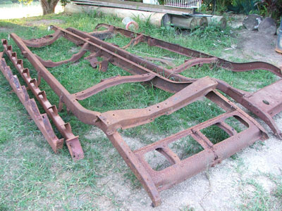

  2. after some time bathing in molasses

  3. front spring mount set up temporary to work out a few things
    I did this last night, it was the first time I worked on it in a week.
    Before
    After
    The split wishbone done
    Boxed the front frame rails. Built the recess for the bottom radiator outlet
    Still have to holesaw 6 1-1/2" in 1/8 plate for that gap below the front x-member.
    The front pipe will blend better with a little grinding. The tapered pipe is a 1927 chev torque tube it has a 5mm wall so a bit of grinding wont adversely affect it strength.
    Firewall will be stitched back together to look stock. Oh and I am converting it to LHD. :cool:
    Stogy and UNSHINED 2 like this.
