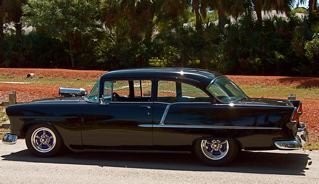

    first car show, got nothin but positive feedback on this old shitbox
    also, to any of the experts following this build; school me on disc brakes please. i know i want it cheap, manual, and readily available at the parts store as far as rotors & calipers and such go. what spindles should i use/look for? i know i can order a new manual disc master for short $. thanks.

    I used a 68/70 Nova manual disc/drum master cylinder. Sorry but I can't remember what proportioning valve I used. I have 70 Chevelle bearings, disc, and calipers. I bought the brackets at a swap meet, from some guy who made them, got them for $20.
    Might want to check this out though, its about the same amount as I have in mine.
    http://cgi.ebay.com/ebaymotors/1955...r_Truck_Parts_Accessories&hash=item2c544b9451

    It cost me $470 to do my 55, that was through street rods by michael the local parts store, but i am doing it again for my 57 now a piece at a time more through the parts store and speed way. it included bearing, hardware, dust caps, brackets, cali.pers, pads, gm disc/drum proportioning valve, rotors, steel braided lines, 1970 chevelle manual dual master cylinder and it stops on a dime. You can get the master at advanced for $15 all day, and all the other stuff from the junk yard for dirst cheap like the calipers, turn a set of junk rotors, and then just get the bracket kit from speedway. its pretty easy to do depending on whether you wanna spend money or do leg work.

    I have all the part numbers to put disc brakes on your stock 55 spindles. Bearings, races , seals, rotors,calipers,hoses, and disc/drom master cylinder. Twenty years ago,one of my customer's bought a kit to do his 55 Nomad. I kept all the part numbers and, and all available through your local parts store(s). I'll dig out my old "book of notes" at the shop tomorrow and post them on this thread tomorrow night.

    Here are the numbers I have. The basic brackets come from Speedway. May be other suppliers who are just as good (quality and price wise). Part #916-31915 (BRACKET KIT ONLY)This kit fits '69-'72 11" GM midsize rotors and '69-'77 GM midsize calipers to your '55 Chevy.Here are the related parts from your local parts store(S)
    Wagner Rotors #52-1022074
    Wagner Brake hoses #98912
    Wagner Master Cylinder #F73342 or NAPA 36280 (bolts to the two lower existing studs on the firewall.
    Timken inner and outer bearings A2 and A6
    Dust Caps #13977
    I have done this a number of times, and it works well. The numbers should be correct, but some may be superceded. Hope this helps.

    racked up some real miles on this shitbox today. about 50 i'd say, here's what i learned. seam around the radiator petcock turned green, prolly gonna blow out. so i want a new radiator. manual drum brakes have been deemed tolerable for now, now that i have 4 non-leaking wheel cylinders. gas gauge does not work and gas leaks out of the stud for the sender, this is bogus cause the gas tank looks brand new as does the sender, whatever cheap & easy. rear tires get into the quarters over good bumps. i'll add coilovers cuz i'd rather not raise it up any. transmission & shifter suck. gotta get something even slightly better. driving a stock-o 305 with timing gears, tunnel ram, & loud exhaust is pretty goddamned fun, & nobody at the gas station will ever question me when i tell them "it's a 327 with a 3/4 race cam"
